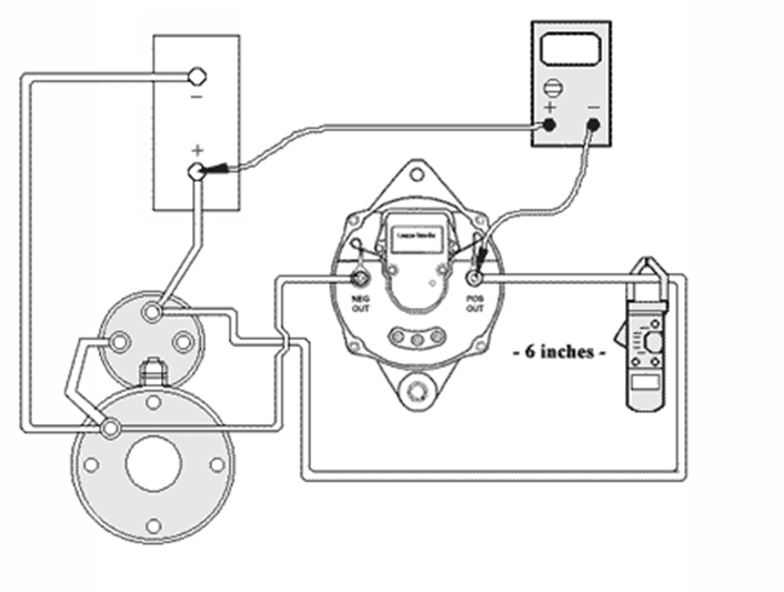

Alternator Cable Test. To test the positive cable connect the ammeter to the positive cable from the alternator. Make sure the ammeter is at least 6 inches (15 cm) away from the alternator to eliminate the possibility of faulty readings. Connect the voltmeter’s negative lead to the positive terminal of the alternator and the positive lead to the positive terminal on the battery, see Figure 14. Start engine and set engine RPM to 1500 RPMs (operating speed). Turn on vehicle loads until 75% of alternator’s rated output is achieved on ammeter display. If necessary use a carbon pile tester to apply load on alternator. Record voltage on voltmeter. If reading is greater than .25 volts in a 12 volt circuit or .50 volts in a 24 volt circuit check all wire connections and cable connections. If reading is less than .25 volts in 12 volt circuit and .50 volts in a 24 volt circuit cables are good. Turn off vehicle loads and shut off engine. To test the negative cable move voltmeter’s negative lead to the negative terminal of the battery and the positive lead to the negative terminal of the alternator, see Figure 15. Run test again.

Figure 14: Positive cable test
