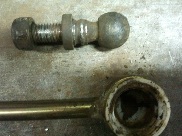

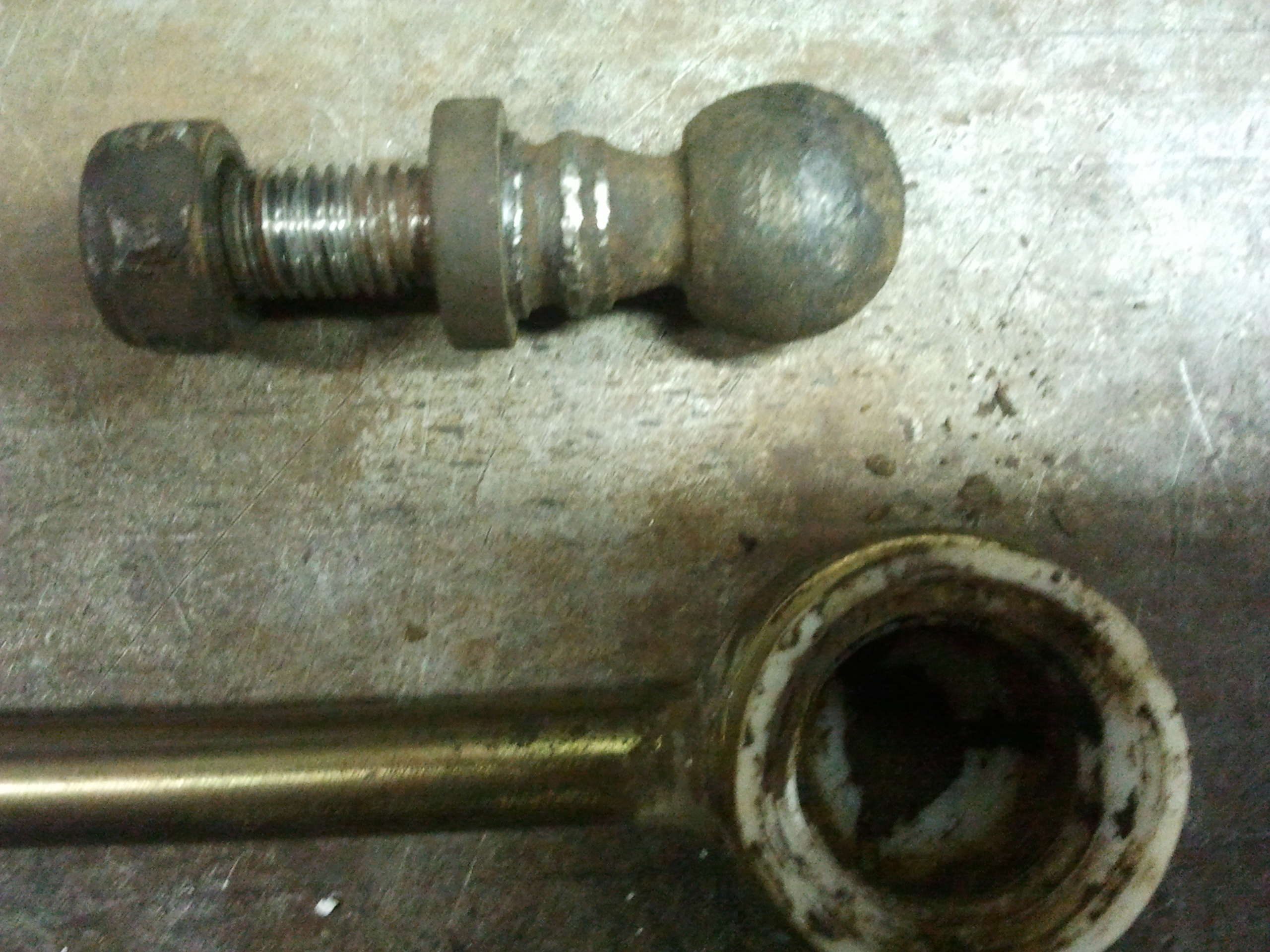

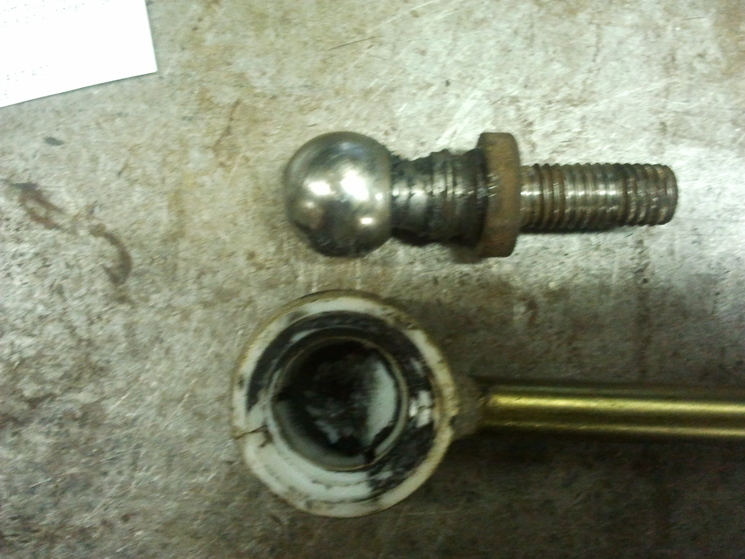

I was having alot of clunking in my front suspension so much so I assumed it was the strut mounts, so I take my front end apart and everything up there is in perfect condition. I had to take of the sway bar end link to remove the strut and when I did that the Karlyn end link ball joint fell out in my hand, while the other side of the car has the OEM link with 280,000 KM on it no problems. One of the joints was perfect, and the other joint was rusty with no grease and really pitted etc, it was the lower one that was bad; I assume driving through 6"+ of water multiple times this year did it in.

cn90 wrote:Actually, if I have to rate them...
- Karlyn: Taiwan junk
I doubt it was the deep water.
The low quality boots crack, water and dirt get in, joint is toast.
