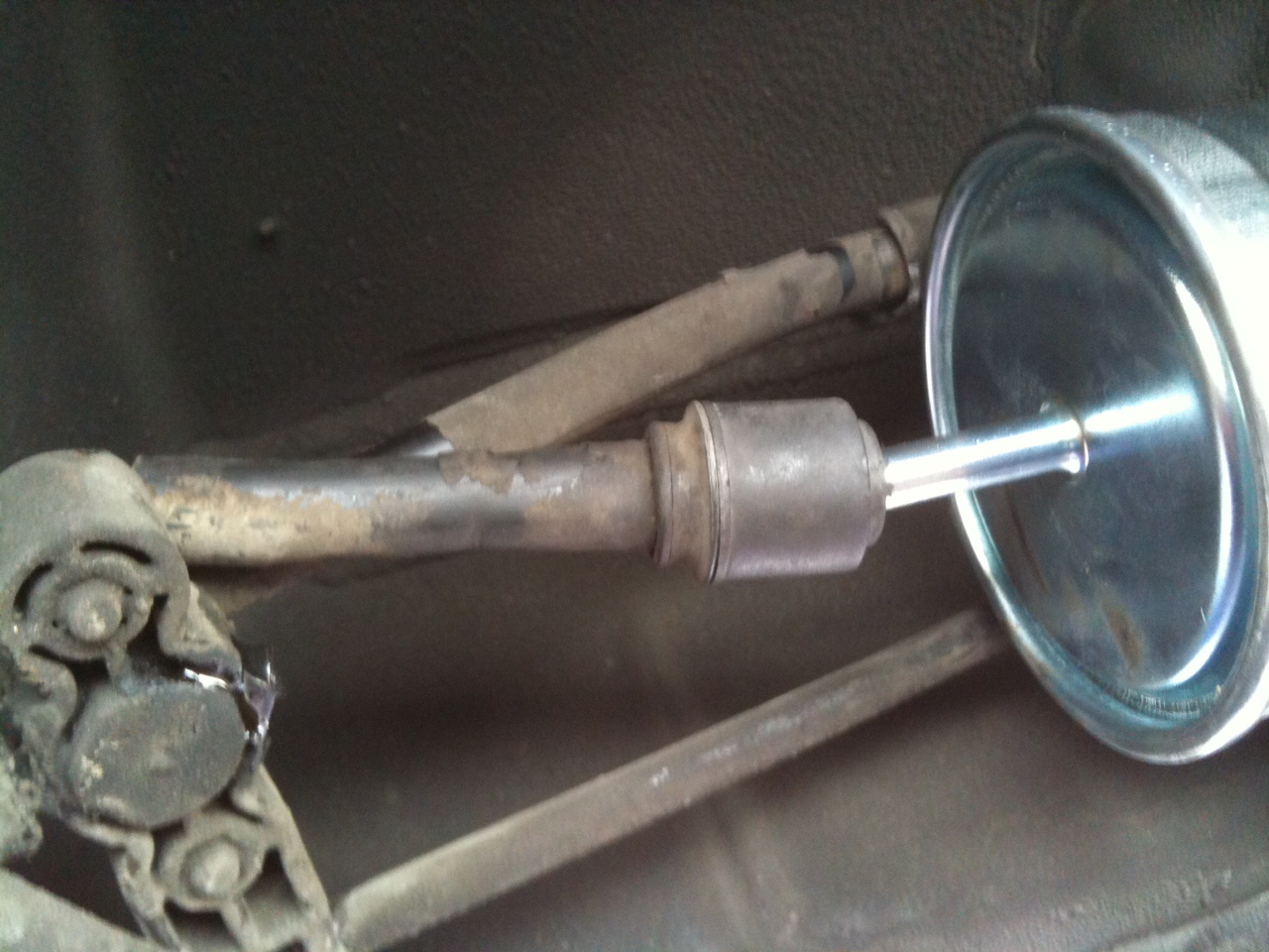

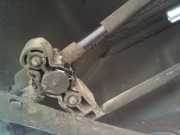

That fuel line cpl is what I will be purchasing as well as the Pressure Pipe part# 9186286. I snapped min when trying to remove my fuel filter. I disconnected the in-flow end, and instaed of disconnecting the out-flow end before pulling the filter out of the bracket I decided to try to muscle it out and snapped the pressure pipe where it connects to the fuel line cpl.
This is it with the pressure pipe connected to the end of the fuel filter.

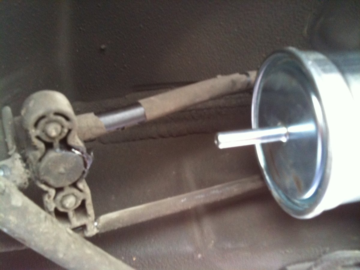

I investigate a little today and i found out that it could indeed be a fpr.In previous posts i wondered where should be a roll-over valve and i found it behind fuel filter(towards the fuel tank)looking from front to the back of the car.

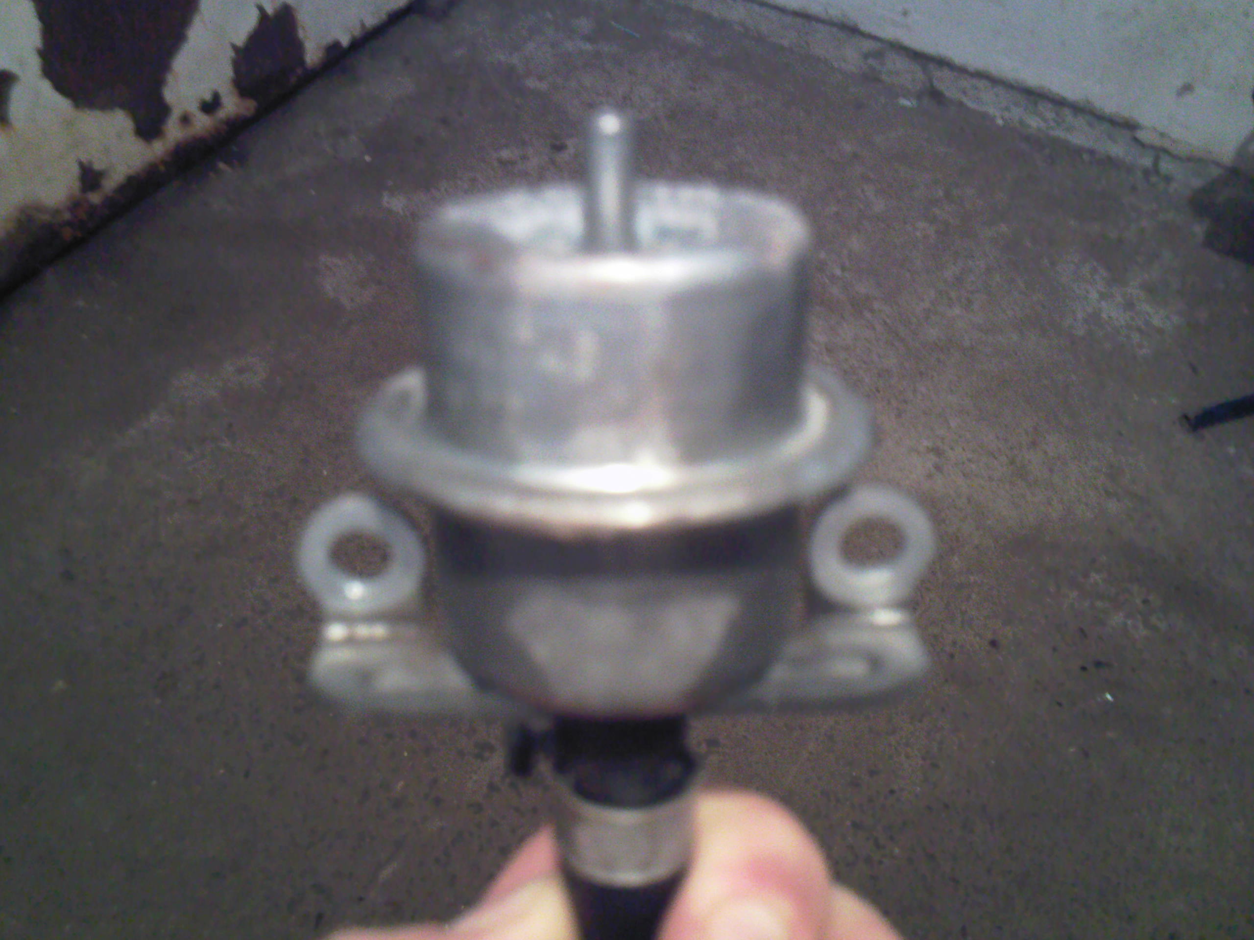

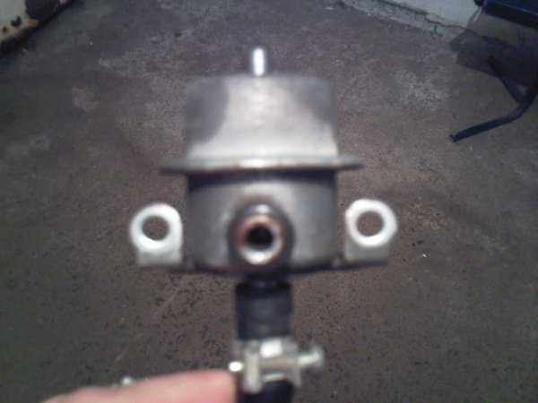

Waynej....I compared my extra fpr which is on old style fuel rail with what i have on my car at fuel filter area(pic from post #1) and i found out that it's the same,BUT smaller.
Because it's smaller,it's holder(bolt holes) are also smaller and it doesn't match with bolt holes from the extra fpr i have.I'm not actually talking about bolt holes diameter,i'm talking about distance from bolt to bolt.
Bosch number from my extra fpr are 0 280 160 746,it's also stamped 3 bar on it.
I will try to read the numbers from the "thing" i currently have on my car in fuel filter area and i'll report back.
Here are the pics of my extra fpr:

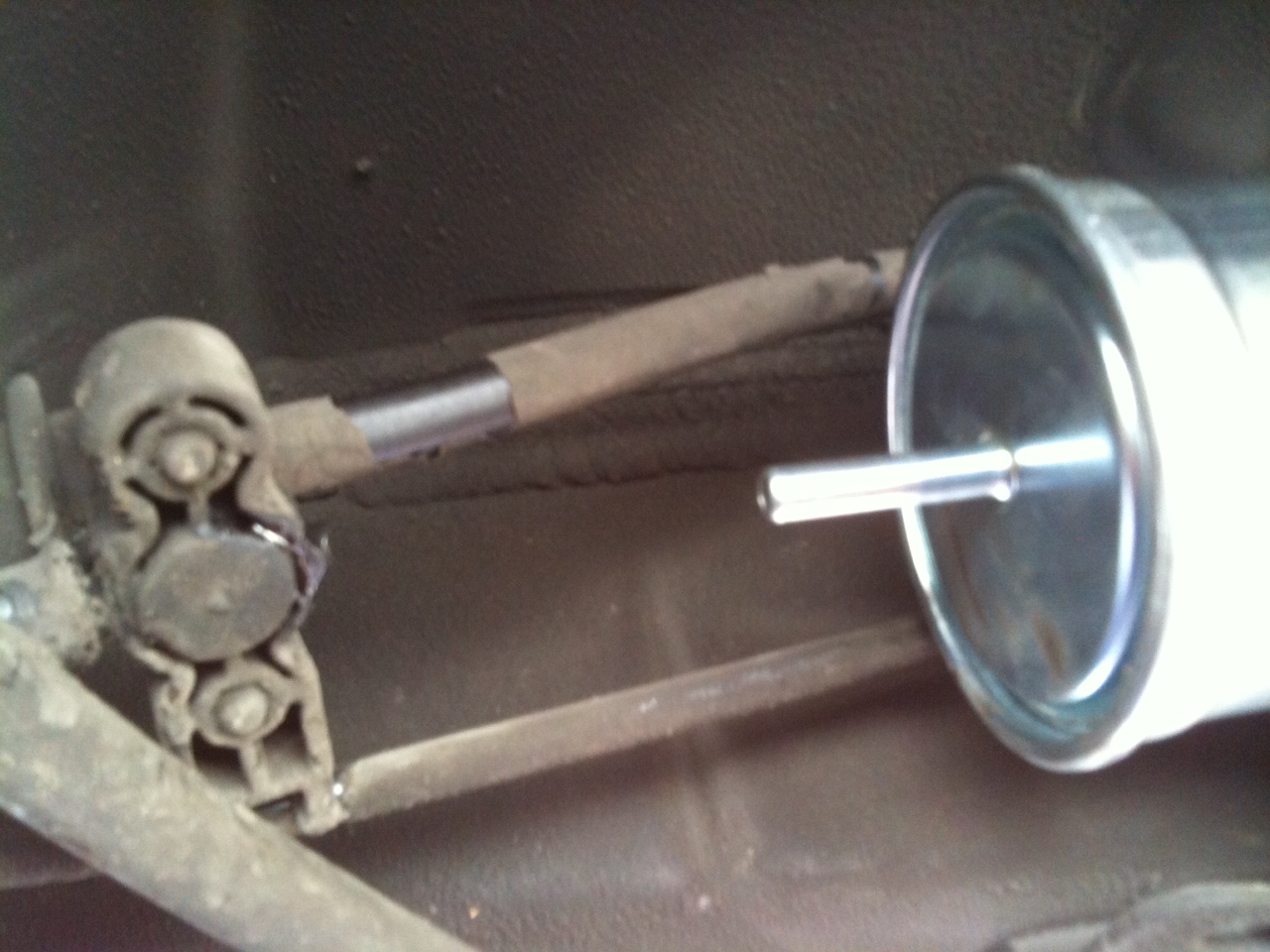

I managed to read the numbers from the "thing" in fuel filter area and here they are:
Bosch # 0 280 160 556
Volvo # 127 18 66
I googled this:
http://seekpart24.com/bosch/control-val ... -280160556
It looks like it's fpr.
