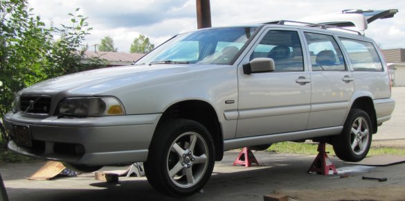

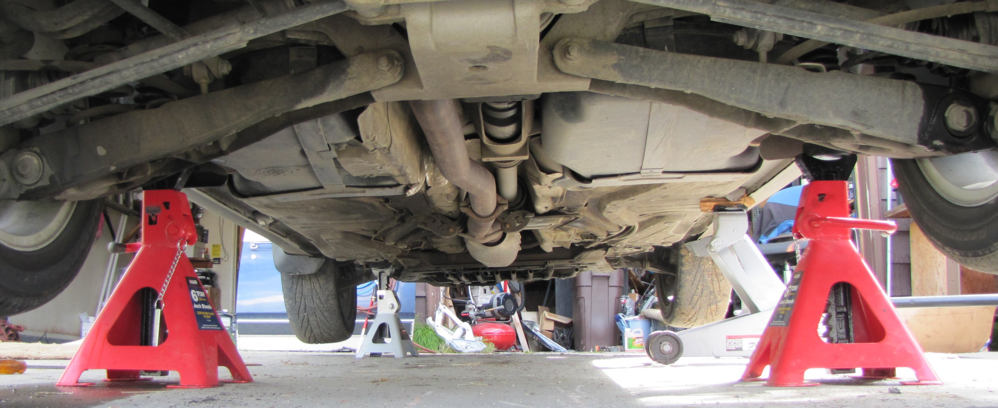

I've had mine up on all four several times. Solid as a rock.
I use a floor jack with a modified chunk of 2 x 4 to lift the
car at the factory scissor jack point and do one side at a time.
Just chock everything and move slowly and carefully.
A jack stand tweek that I've picked up on over the years
that make me a little more comfortable about preventing
the car from slipping off of the stands is hockey pucks.
A puck atop each stand provides a better grip that's
less likely to slide and also provides a little dampening.
At the front, there are shop lift locating pin openings in the
plates that join the sub frame to the unibody structure.
The pucks help lock the jackstands in between the bolt heads that
secure the plates there. Also prevents the plate from deforming.
This is the only pic I've got, but I uploaded big to allow zooming:
At the rear of my AWD are circular jack points for shop lifts
just ahead of the rear axle. I use those points for the back.
Hasn't fallen on me yet! ( Knock on Swedish simulated wood...)
And YES - Those worn out Good Years have been replaced!
