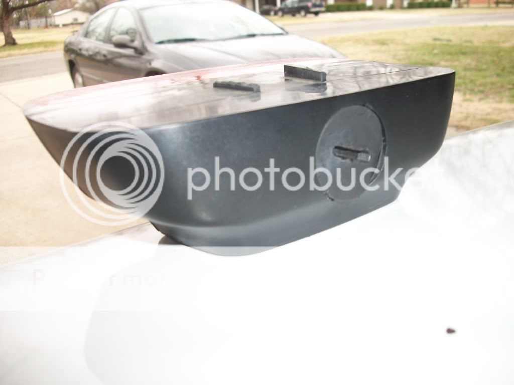

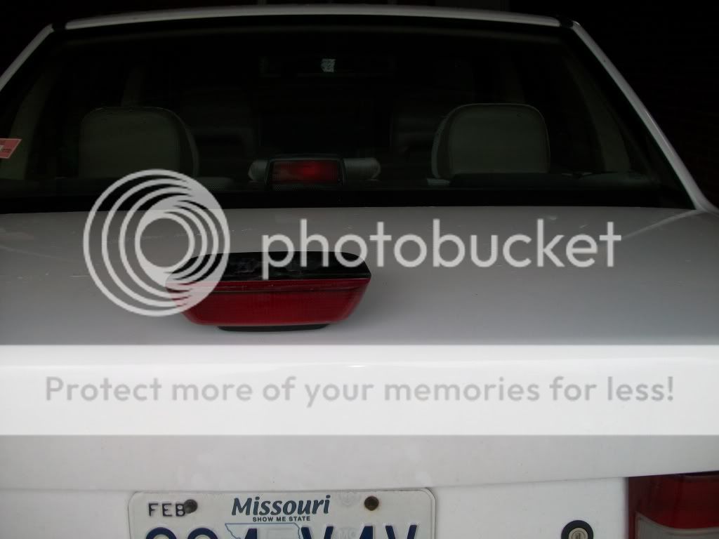

Hi all - I've been reading these forums for a few years now and it's been a tremendous help allowing me to do most of my own repairs. I'm to the point now where the major stuff has been fixed and I'm working on the minor things....like the spoiler light bulb. I thought it would be a simple task, but I'm confused on how to even access the bulb. At first, I thought I could turn the knob on the back of the unit and the bulb would be attached that way. But I can't get the knob to turn a full 90 degrees and I'm afraid to really torque it because I don't want to break anything. I even took the spoiler completely off thinking I could access the bulb from the top of the center unit. Does anyone know how to access it?

The 1993 spoiler is a "weird duck" and I cant give you any hands on guidance since all of mine are newer and they have a bank of lights. The lens comes off on the newer ones to get to the lamps. I think you are on the right track with the knob on the back but it likely won't turn over 1/4 to 1/2 turn and I would suspect that the assembly will then slide out the rear (lens side) of the assembly to get to the lamp.

I've taken mine out and had to repair the contacts to the bulb from previous owner damage. I'll be taking pictures tomorrow of some things, so I'll post back here then,
If I remember correctly, it wasn't even 90 degrees that it turns until you can gently pry it out with a small blade or screwdriver. There is a rubber O-ring that is holding it snug, so it is decieving as to when the bulb holder is loose.
