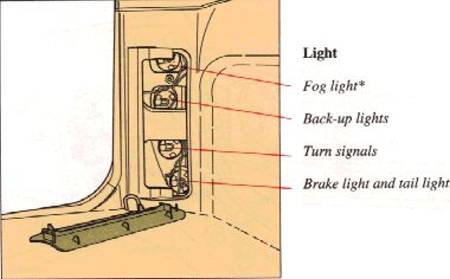

only one more question in the rear from the bottom which bulb should be lit when the low beams are on

First question first - which lights are which:
Fog light * 21W 32CP BA15s
Back-up lights 21W 32CP BA15s
Turn signals 21W 32CP BA15s
Brake light and tail light 21/5W 32/3CP BAY15d
White lamp holders on the right side, black holders on the left side.
* Left side only
So you should have the bottom bulb lit with either low or high beams on.
