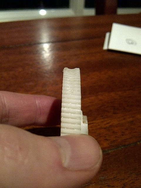

ianners wrote:Thanks all. I tried your suggestion about raising the tailgate/ wiggling the LHS wires behind the hinge cover, but no joy. I realise I misled you by saying the wiper remained in 'Park' - actually it sticks at the extreme left position ('9 o'clock') but can be induced to restart by moving it past '10 o'clock'. It will park on the right side if switched off, but at '9-10 o'clock' if left on. It therefore looks as if I have an issue on the wiper motor at that portion of the cycle and will have to uncover that mechanism. Comments?
The gear in the casing can be worn out as shown in this picture.
Gear worn out rear wiper V70.jpg (100.5 KiB) Viewed 1804 times
Open the case to assess its state.
The following link is showing many pictures of the inside (near the end). This is from Club Volvo Quebec and I guest you can capture the essential.
http://forums.clubvolvoquebec.com/showt ... hp?t=16869
