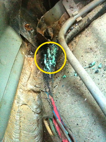

It would appear I've located the problem. I tore apart the tailgate looking for a rear electronic module, which I'm not sure even exists, and in doing so discovered the wiring harness for the tail lights was touching the nut located directly above in the picture. I'm not sure if that nut is grounded, or if that even matters, but clearly the harness did not fair very well...
Here is a close up of the mess:
So, my big question is what do I do next? Can I just splice new wiring in with crimp connectors and call it good?

I believe this is the harness and part number.
http://tinyurl.com/83tfyy5
Upon further inspection, there appear to be 16 wires, two of which are of a thicker gauge (red and black in color). I think it would be more cost efficient to do the wiring myself. Thoughts anyone?
