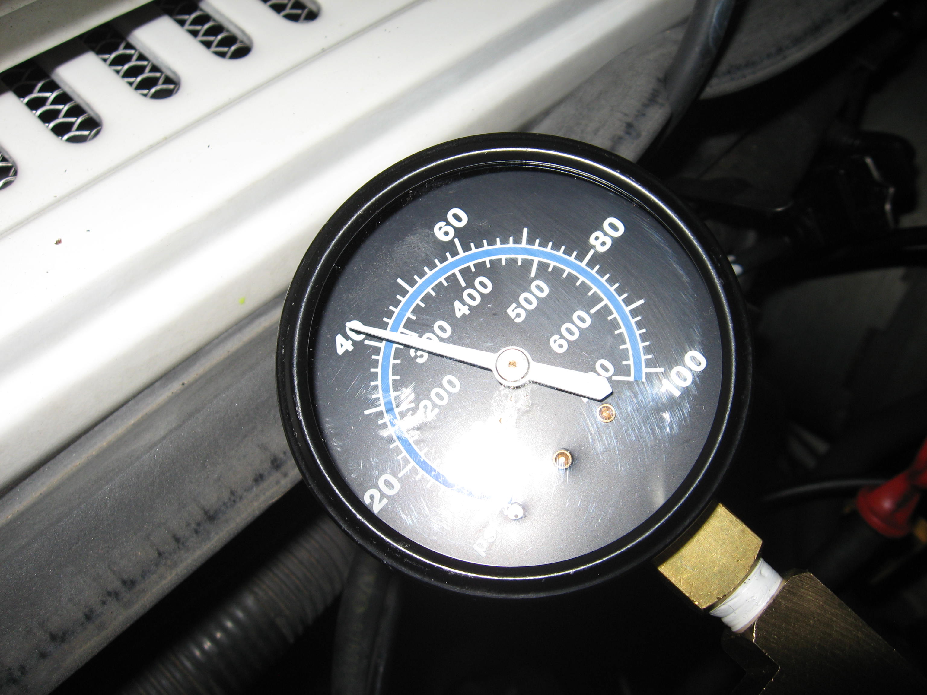

Well I discovered that my hearing sucks and I need an in tank fuel pump I believe.

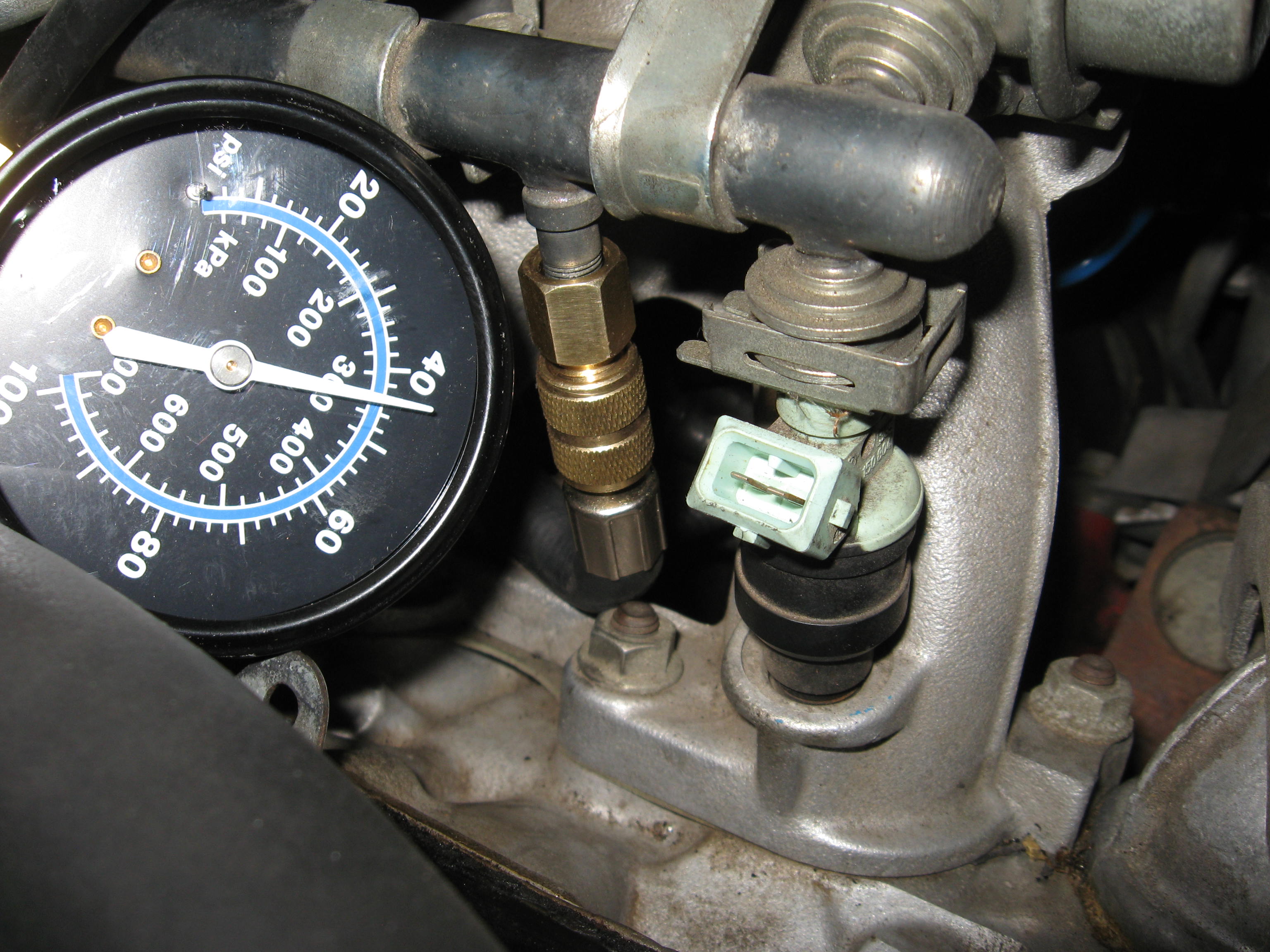

Picked up a relatively inexpensive tester $39.99 @ Pep Boys(cheapest they had) and after a bit of cursing at the rail fitting finally got it on. Just a hair of a degree angle either way and it would have been much easier but it is possible( because of the adaptor needed. It comes with gauge but made it much more difficult).
Read 43-44 psi at rail ignition on and after starting dropped to 40 psi at idle I didn't bother to raise RPM's because I believe it should be at least 50 psi at idle if I read correctly on some other thread and probably would have dropped with the greater demand for fuel..Besides I didn't have anyone to do it while I held the gauge and really didn't feel lucky trying to raise the throttle at same time.
I guess I should have pulled the regulator vacuum hose while it was running but again I didn't feel lucky and I am not sure what that would have shown.
Reading on fuel line before pre-pump was 14 psi with car idling and less than 10 psi with the car ignition on but not running.
If anyone could confirm the values I would appreciate it and in the meantime I will price out in-tank pumps.

- reading before pre-pump car idling approx.14 psi car not running ignition on less than 10 psi.
- IMG_1244.JPG (643.23 KiB) Viewed 1603 times

I don't think engine RPM will have any effect on fuel pressure. the fuel pressure regulator controls fuel pressure. The fuel pressure at rail with vacuum hose connected to FPR should be about 37 psi. With the hose disconnected from FPR and plugged the pressure should be about 43.5 psi.

To summarize I believe changing the fuel filter resolved my major complaint on the bogging and inability to maintain RPM above idle regardless of how long the engine ran. No effect on 231 code. I found that the fuel pressure on this car is anywhere from 10 to 14 psi from the in-tank pump to the main and 44/43.5 psi KOEO at the rail. it holds 41 psi at idle.
