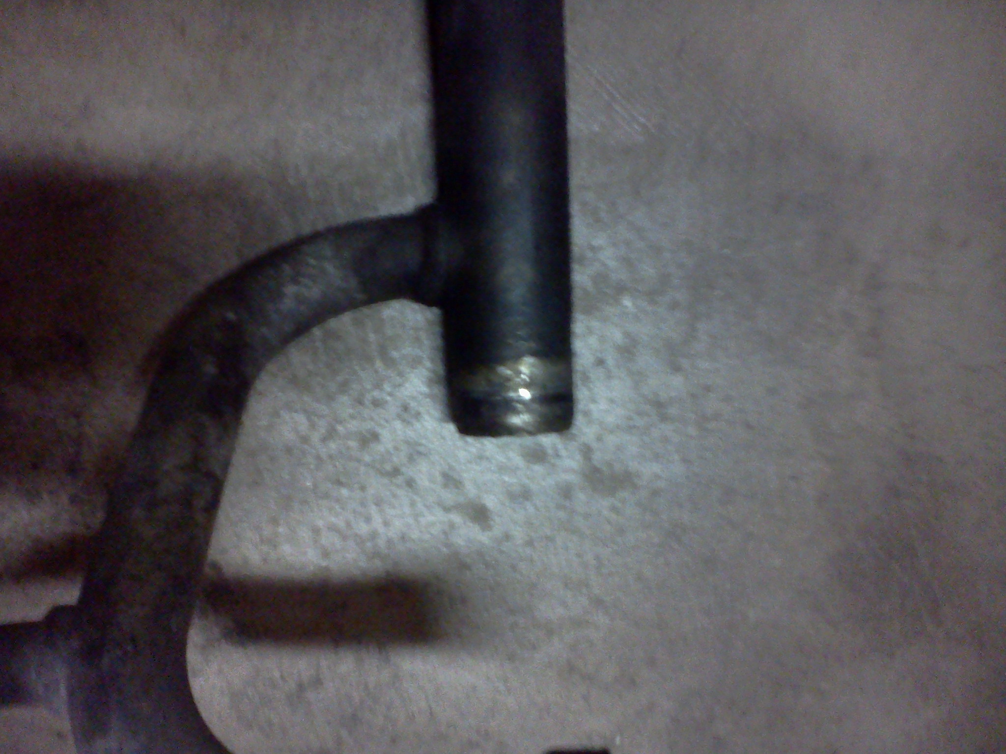

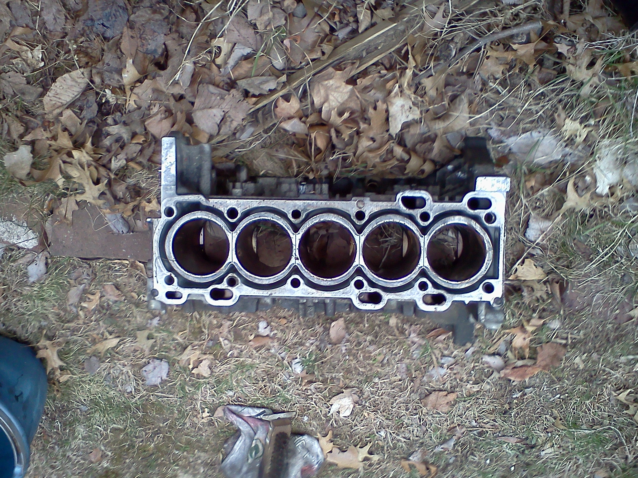

Yes, that paper gasket does go on that pipe, but that piple also is removable from the block. There is an o-ring that sits inside the back of the water pump housing.
I scrapped the block in the picture a while ago, but I know there is infact a o-ring in there. There is no picture of it, but here is thePN
It could also fit the spark shield under the dizzy cap. But just so you know, there is a rubber o-ring that seals that water pipe in the water pump housing.
EDIT... Check out this thread on vs the linky for EEuropean shows a picture.
water pipe
water pipe
block with water pipe removed
