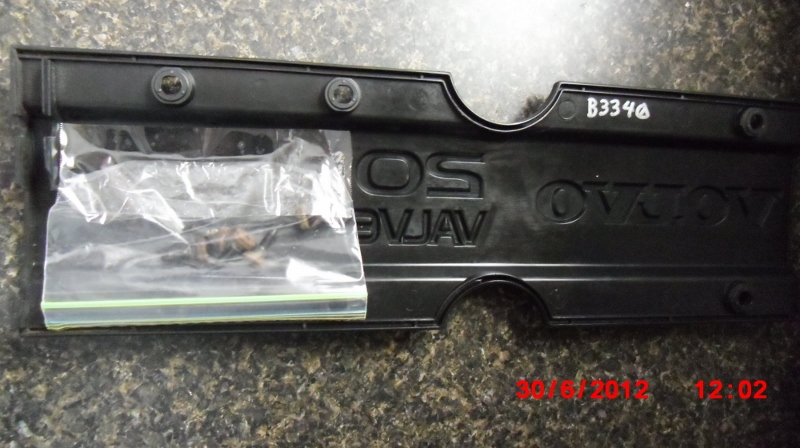

I didn't bother putting the spark plug "Volvo" cover back on. It just gets in the way during inspection and maintenance. It's mostly for looks. Anybody want to buy a high-mileage OEM spark plug cover with rusty OEM Torx screws? All original from the factory. Ha Ha!rmmagow wrote:Second thing I did after I bought my car was to remove and anti-seize those screws. I don't think they need to be crazy tight anyway.
- Original factory spark plug cover and Torx screws!
- CIMG1739 (800x448).jpg (240.96 KiB) Viewed 1564 times
