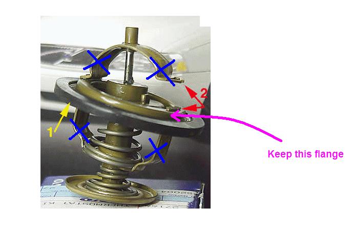

Look,
If you decide to get rid of the Autozone Valucraft tstat; then take it out and return to Autozone and get your precious $8 back.
Since you are in Houston with hot weather, and if you decide to run WITHOUT the tstat for now, do this:
- If you did not throw out the old thermostat then: remove the parts marked in BLUE color.
- Keep the flange (marked in PINK color).
The reason you want to keep the flange (PINK color) is that: without it, you cannot seat the tstat seal properly and it will leak.
As you know, when installing the seal, make sure it fits like a "sandwich" on the flange.
By-passing the Tstat should get you going for now.
*** I will look in my garage, I may have a few spare parts (don't count on it but I will try).
