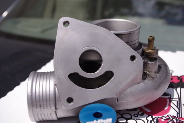

stupid aluminum!
This ring wasn't there when I took the original Mitsubishi spring out two years ago. I don't think it's a problem, but I could be wrong. This was with the factory recommended wastegate setting for a stock LPT, not a turn more I swear. I also have an HD TCV, since the original Pierburg one failed a while after the turbo rebuild.

gheez, what spring was in there?

That was from the lighter spring, the blue one. I just found a used turbo housing for cheap, removed from a Volvo 40 series. Asked the guy if it had a ring worn in it and he said "Yes, but only about half as bad (as mine)". So I guess even the stock spring can do this. I'll probably just keep using this one then.

thats some uneven spring pressure

Yes it looks uneven. What is the cause of this? Did I not put the spring in perfectly? Bad spring? The housing I was gonna buy has the same thing, just not as bad.
Maybe tightening down the CBV cover tweaked the spring to one side? Perhaps I'll get the Forge CBV, or go back to a stock Mitsubishi spring.

I picked up a new mitsubishi kit but havent gotten to it yet. I'll be sure to check mine out just for the sake of it. I know the oem ones been in there for 220,000 miles so far. Cant see any real harm in the groove but what do i know...

Hey madspeed50, I'd be interested to know if your stock turbo has similar wear from the bypass valve.
I had been planning to put a 15G wheel on this turbo and get an ARD Green ecu tune. More boost could increase the wear even more though, so now I'm not sure what to do. Maybe buy that newer housing with less wear.
