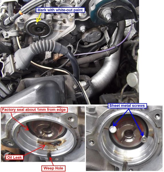

This is exactly when I wrote the DIY for REAR Cam Seals recently, I mentioned that it is a must to use "White-Out" paint (aka Liquid Paper or touchup paint):
https://www.matthewsvolvosite.com/forums ... hp?t=50752
Photo is here, note that the "half-moon" circle location, in your case, mark it with touch-up paint, flip it around and see what happens:

Why use white paint when those parts are already asymmetrical? Am I missing something? I just pay attention to how I install them.
On the black part under the CPS, the tab belongs at about 4:30. And install the CPS so that the wire is at 8 o'clock. Done, no extra marks, etc.
