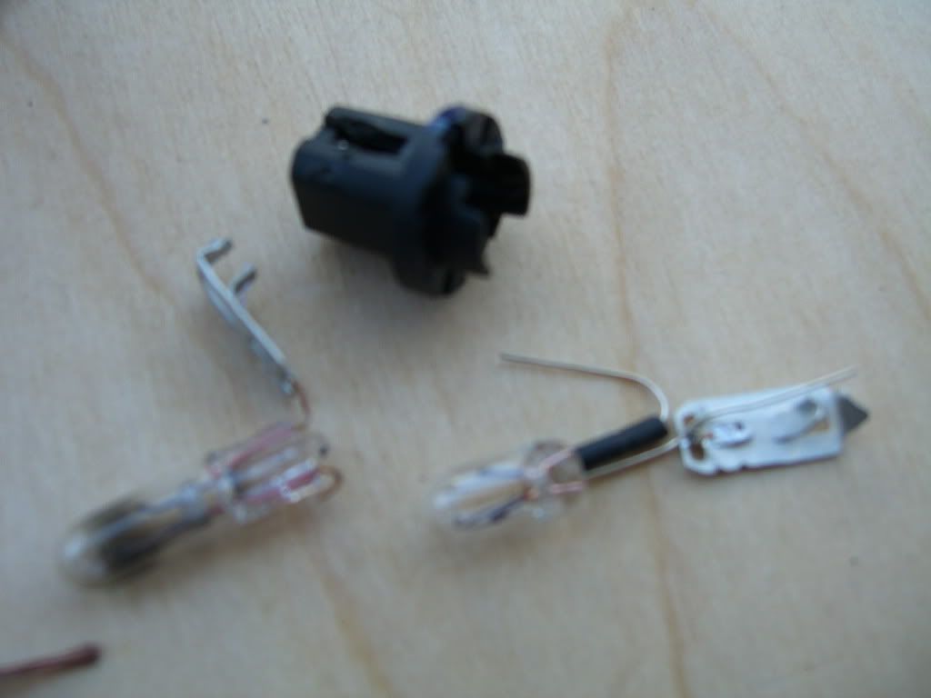

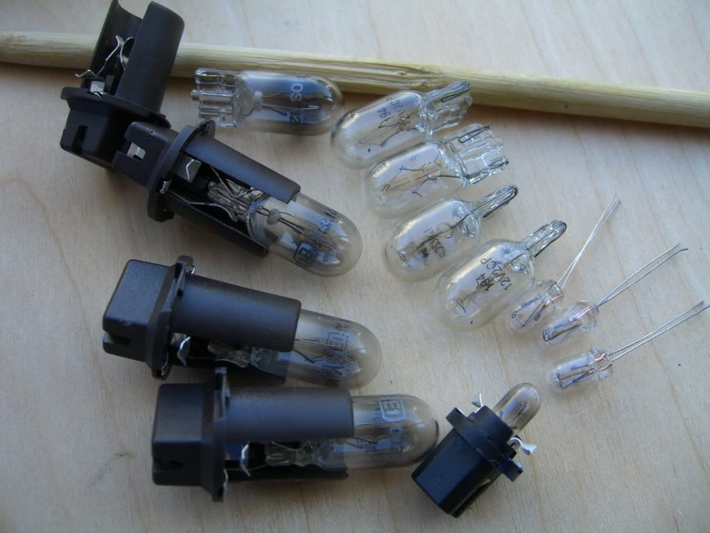

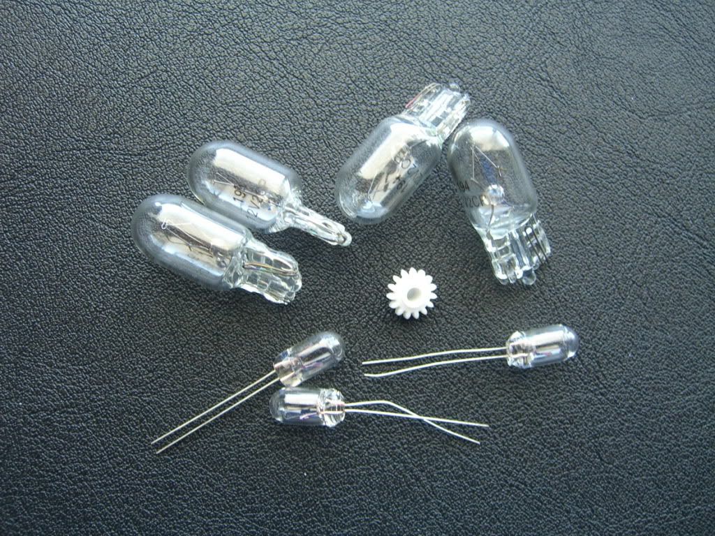

Hi, I just replaced the dash broken lights and fixed odometer with new gear.
A package was bought from eBay.
All larger light bulbs were replaced and some small ones also replaced.
You have to carefully soldered the wires of smaller ones.
I got all of the bulbs changed and functioning. Thanks for the help with that.
