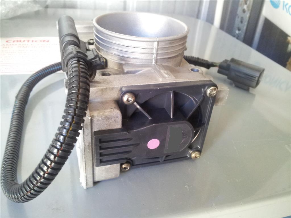

Send it to XeModex in Canada, costs around $600 inc freight. Call them on 1888 712 2525
It's almost easy to remove the ETM on non turbos except the left hand starter bracket needs to be removed to release the loom
See this seasoned pro do it....well not exactly but she managed it anyway
Good luck and stay in touch if you need assistance
I've attached a pic of an entire ETM with loom so you'll recognise the connector when you see it just beneath the radiator close to the front engine mount
