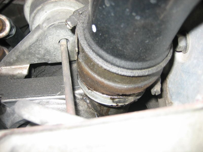

I checked the hoses and the top inter-cooler hose is quite soft. Due for replacement obviously. I then checked around the turbo to find this
Looks like a nice sized rip on the coupler. Major cause of power loss?

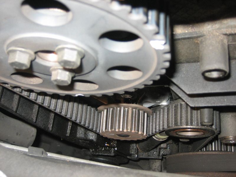

I have also been losing more oil than usual. In my search for a source I notice oil on the passenger side cv boot by the timing cover. I pulled the cover and noticed oil/grime on the lower corner.
I looked around some but didn't see any source of oil coming from the front cam seals. Anywhere else I should be looking for an external leak in that area?

The only way to pin down the source of the leak is to clean off what's there (Gunk Foamy works pretty well, after dry, some brake cleaner will get suspect areas like new, so oil can be spotted...you can buy Leak Detector at Parts Stores, but you may need a UV light to use it...so read the label...visual should be good enough...just drive it a few days after you clean it. I'd leave the belt cover off to simplify spotting the source, but only for ths short timer, and no off-roading, monsoons, etc...

Transmission isn't slipping. Holds speed fine going up hill. That was my first thought though. The louder, more pronounced WHOOOOSH I noticed when getting into it leads me to that nice little rip in the coupler. Going to get dirty this weekend or next replacing the hoses.
Getting a rotation, alignment and oil change this week. While they have the wheel off I'll take a peek at the lower portion of the timing components. The only place it's grimy is there at the bottom corner.

If your hearing a louder whoosh then yeah prob a torn hose somewhere, id say the oil leak is coming from the front cam seals.

855 moneypit wrote:Looks like a nice sized rip on the coupler. Major cause of power loss?
Yeah, that'll it. If that's shot, it's a good idea to replace all five of the hoses related to the intercooler.

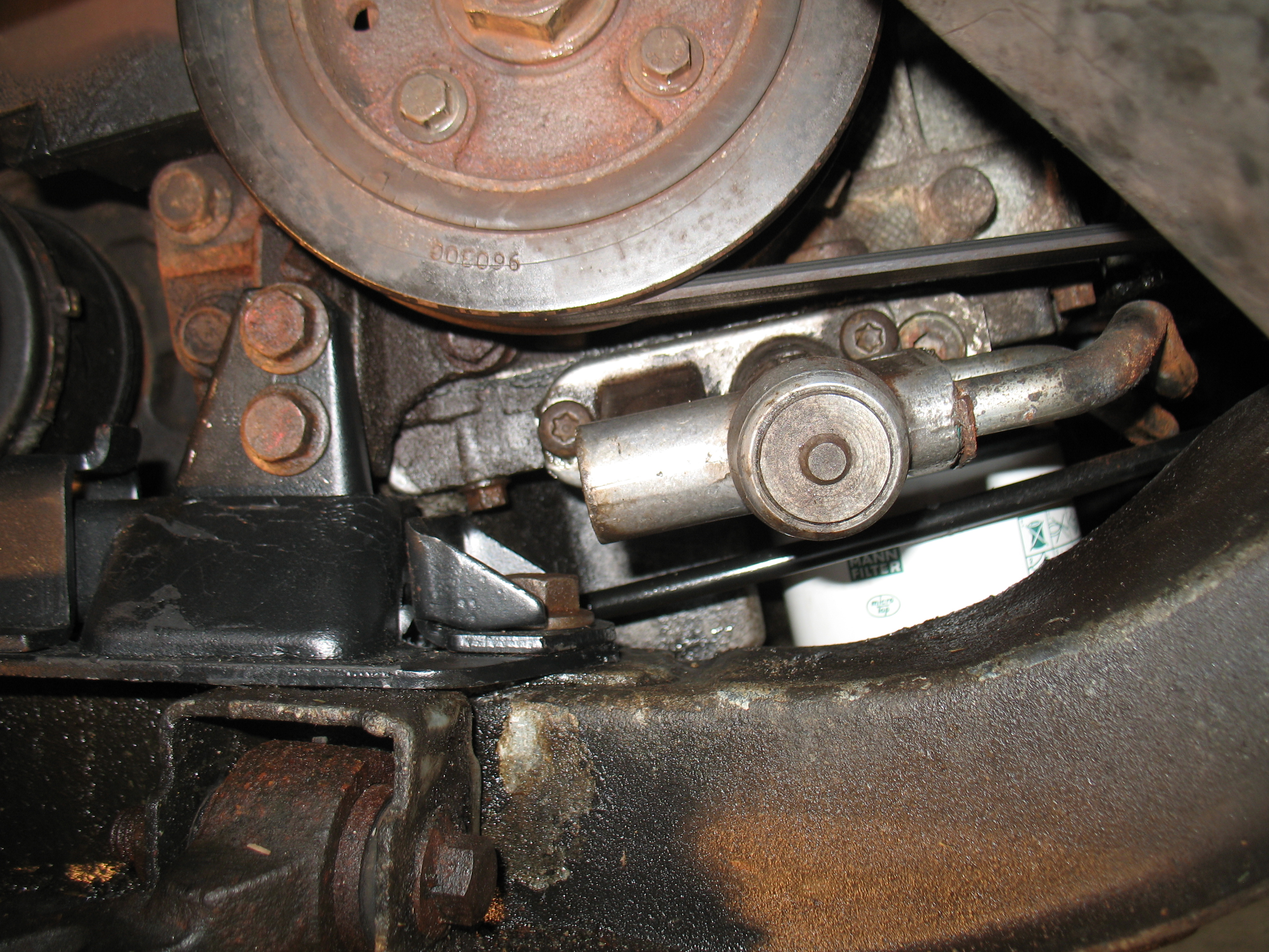

855 moneypit wrote: I have also been losing more oil than usual... Anywhere else I should be looking for an external leak in that area?
Inspect your oil thermostat and related hoses. It's behind the passenger wheel, just in front of the eninge mount and under the serp belt.

Is this a crack here in the hose?
If this is a cracked hose from a turbo....that's why you have a loss of power.

misha wrote:Is this a crack here in the hose?
That there is a nasty little gash. Aside from teh dealer the only other brand I can find is URO and I'm not too fond of their goodies.
