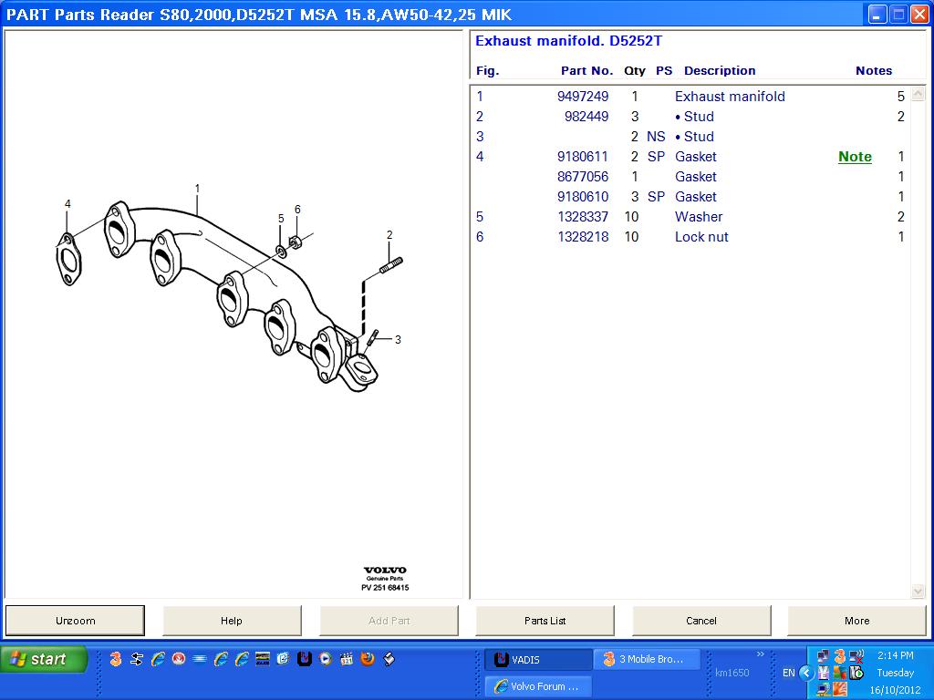

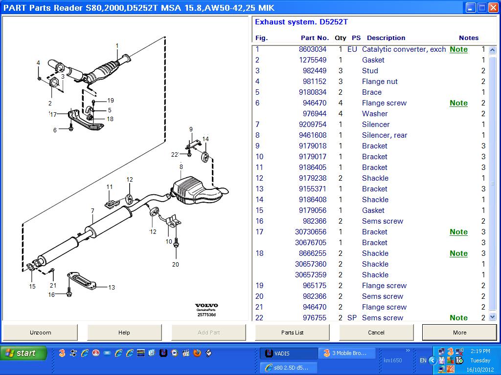

Vadis can give you the info you need. It is readily available on eBay etc. I just looked it up on my copy and I can see all the parts of the exhaust system including the manifold, however there is no mention of any EGR system.
I can see in the diagram of the exhaust manifold that there is a port near cylinder 5 but it doesn't describe its function.
S80B5252T EX Manifold.JPG (80.64 KiB) Viewed 1773 times
S80B5252T EX System.JPG (124.55 KiB) Viewed 1772 times

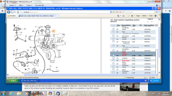

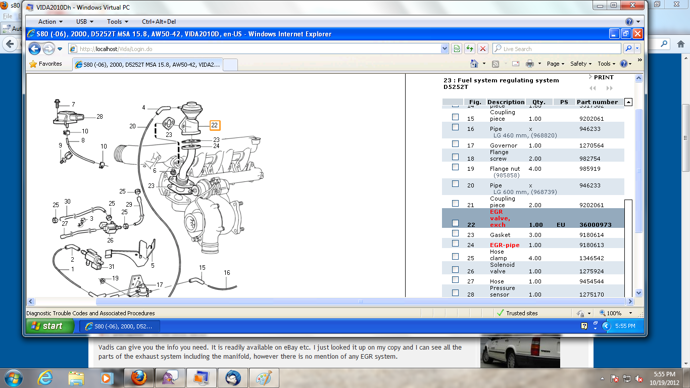

This should help. Long as i did it right...
