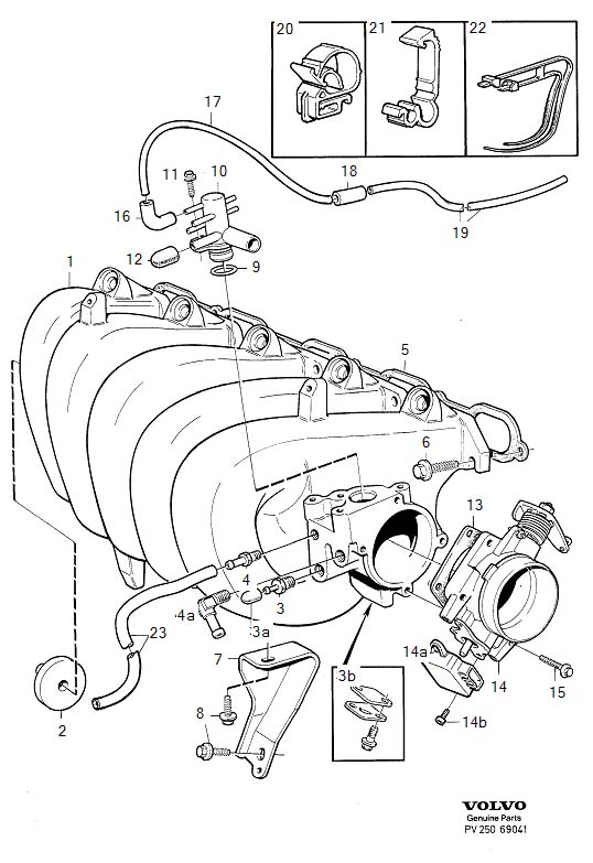

Even if you grab an N/A intake with an EGR attached, Volvo makes a part to plug it (#271778) it runs about $20 at the dealer. It includes a gasket and a plate with 2 bolts. If you use the N/A intake you also need to tap 2 additional ports. The one one the front of the intake for the PCV system and a 3rd one on the front for the fuel line. Take a look at the attached diagram. This is a turbo intake, the n/a intake will not have the port labeled #4.
- turbo intake.jpg (71.44 KiB) Viewed 2366 times

Damn, so it would just be easier to bore out the throttle body inlet on my current manifold?

So if I find a Non-EGR NA intake, will I still need to tap it for the vacuum lines?
Seems like 6 of one, 1/2 dozen of another. Either I have to drill for the vacuum ports, or bore for the throttle body...

Yes, you will still need to tap the 2 lines even if you get a non egr n/a intake. Sorry!!! Not that hard though. You can pick up a basic tap and die kit at Harbor Freight for $15 and since the intake is aluminum, it's a fairly soft metal.
