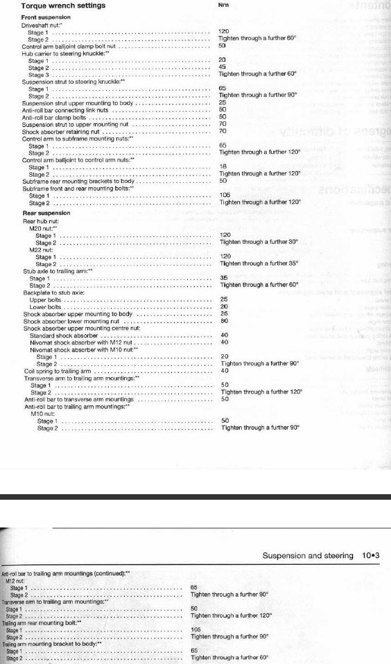

Thanks Lee, will do so tomorrow first thing. Do you have the torque setting for the sway bar end link (anyone?). I don't have the book for it.

Officially, torque is 50 Nm. But really tight will work, too.
