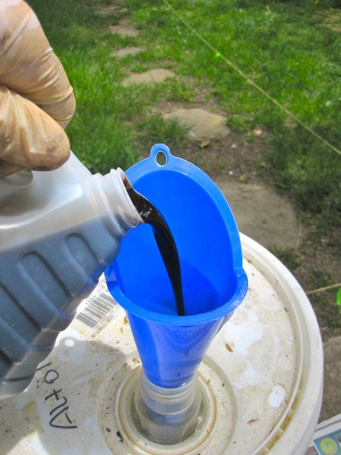

This is what it looked like pouring out of the transmission:

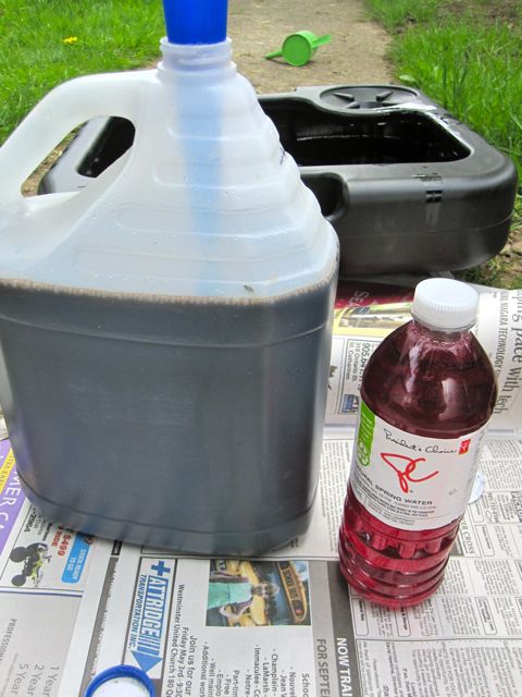

Here just another comparison (the water bottle, if which the label is now removed, BIG NO NO) has clean fluid in it. I got exactly 3,5l out of the transmission.
Result: It feels quite a bit better. I suppose I still have 50% of the old fluid in it. I will do another change tomorrow after a bit of a drive. Next week, I'm going to take it on a 200mile drive, after that I'll do my final change. I'm pretty confident, that I'll be able to keep the transmission going for quite some time.
