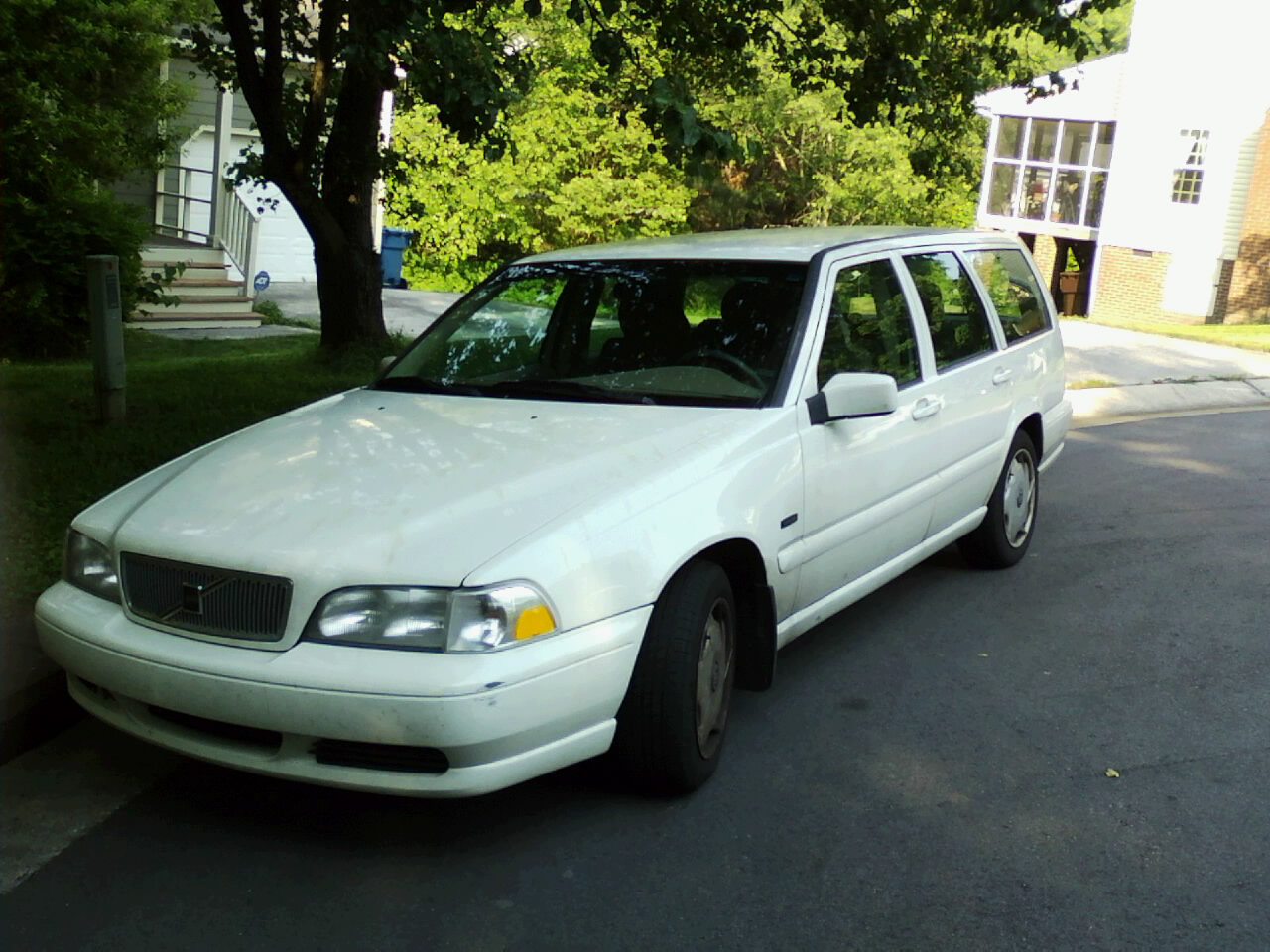

Last week, I bought a 1998 V70 (non-turbo, pictured below) and it has been an absolute dream.
Other than a broken (now replaced) passenger side back seat reading lamp, and missing a front fog lamp grill, everything is in tip top shape. A math professor was the previous owner, and he kept it well service and indexed every record.
I noticed yesterday, however, that although there is a switch for foglamps, which when set to on displays an indicator light, there aren't any actual foglamps.
At one point in 2006 it was backed into in a parking lot, and had to have the front end totally redone (although nothing in the engine compartment was damaged thank goodness) and I am wondering if when they were putting on a new front bumper, if they forgot to re-install the foglamps.

Are you 100% sure you're not looking at the rear foglamp switch? I have the same year, and found that particular switch confusing.

If this switch lights up a light in the dash assembly it is probably the rear fog lamp in the tail lamps that only lights up one bulb additional on the left side. But as for the front ones, assuming that the wiring is there, any new set of fog lamps with the bracket should fit without much problem.
