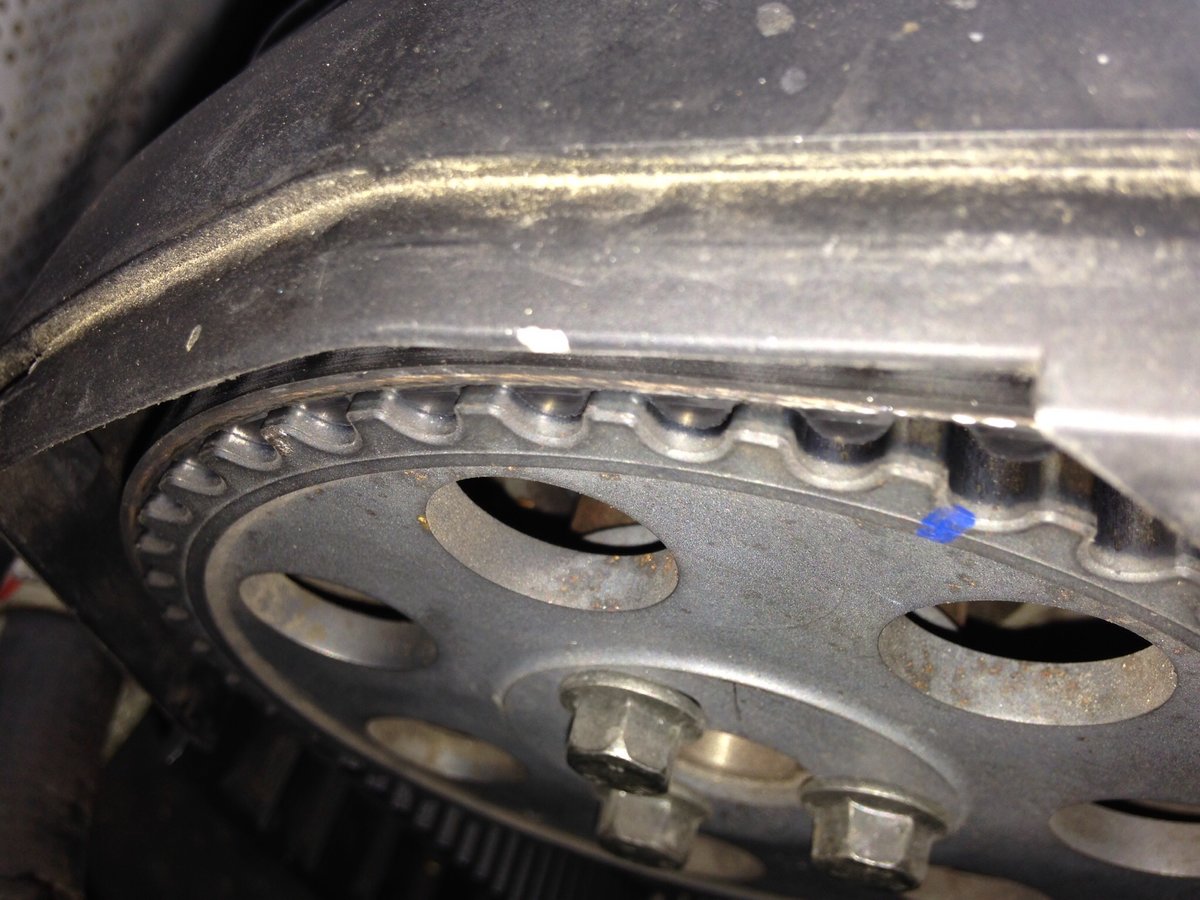

I didn't change my belt today but when I looked at it, the belt was tracking to the rear, closer to the motor. Looks like it's on the back edge of the rollers and cams. The water pump has an edge on the back of it's gears and the belt may be against that.
I'll likely change it within the next few days, probably Tuesday. The cam marks are real hard to see. Someone just put a mark on the cams and belt cover and replaced it. I think I'm going to find TDC and re-file cam timing marks.

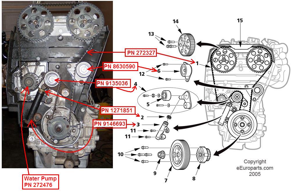

For a long time, I could not figure out why the WP lasts 140K-200K (in most cars, WP dies around 80K-100K).
Also the TB pulleys last some 120K or more.
But the serp.belt pulleys make noise around 100K....
It is all in engineering. If you look at the pic I posted previously (posted again here for clarity).
For every engine revolution, each component may spin once or twice, or more...
The TB Compartment:
- CRANK Pulley for TB: it has teeth and its diameter is similar to the diameter of the WP and of the tensioner/idle pulleys.
So for every 1 revolution of engine crank, the WP/tensioner/idle pulleys turn once.
In other words, for every 1 Million of engine cranks, the WP/TB tensioner/TB idle pulleys turn 1 Million times.
The Serpentine Belt Compartment:
- CRANK Pulley for Serp Belt: it is smooth and has a larger diameter, about 2.0x or 2.5x that of the tensioner/idler pulleys.
So for every 1 revolution of engine crank pulley, the tensioner/idle pulleys turn twice (or more).
In other words, for every 1 Million of engine cranks, the Serp Belt tensioner/idle pulleys turn 2 Million times (or more).
Here is the TB compartment pic:
https://www.matthewsvolvosite.com/forums ... &mode=view

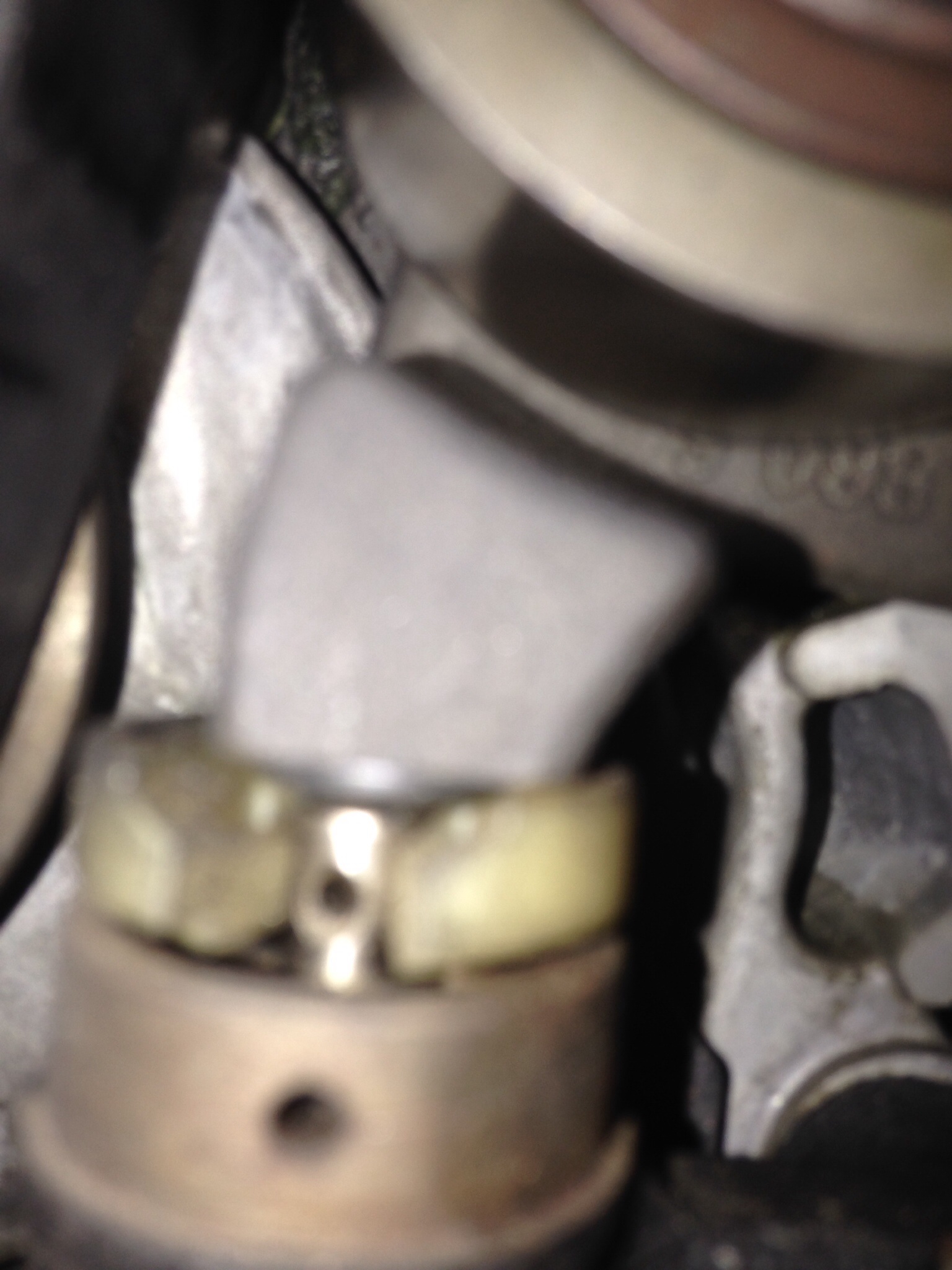

I have a few questions on this change. When I removed front cover on timing belt, I noticed side of belt had been rubbing on the cover. Upon further inspection, I found that engine side lower cover had been pushing against belt forcing it outward towards front cover. In attempt to flex lower engine side cover away from the belt I broke it. How do you remove this lower engine side timing cover? Also, I noticed my pulley does not sit on tensioner arm. Is this normal? Iwill attach some pics, thanks for the help...
