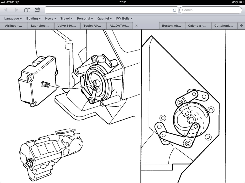

It sounds like the damper controlling the air distribution is either not working or the linkage has come off. Since you not have flashing LEDs , which means the ECC is passing the self-test, I'm going to guess the linkage has fallen off. I will try to find a picture so we can find it and put it back on
I hope we can do it without removing the dash.
See diagram below. The damper motor looks like it connects directly into the linkage, so i doubt it has fallen off. I think you can remove the panel above the drivers feet and the side panel to access the motor, which is Volvo part number 9142629 ...I confirmed this in All-data, so it looks like dash removal is not needed.....whew! If you remove the panels, I would try to feel the more to see if you can feel it moving as you change the air distribution knob.
One more thing to try. Turn your ignition key on, then quickly, within three seconds, push the REC button three times. This (on the later version software) initiates a damper calibration. Wait at least a minute for this to complete, the AC LED will flash while this happening.

There are temperature dampers on the driver and passenger side which regulate temperature (they decided how much air gets deflected to the heater core)I`m quite shure that the drivers side damper motor works, because I see it moves the shaft, I can also see on the passenger side that the shaft is moving, witch the drivers side damper motor is turning. on the passenger side shaft, there is no damper motor attached but, maybe it never has been either.
What we are trying to check is the distribution damper which is on the driver side in the diagram above - I think on early versions of ECC there might be two distribution damper motors too.
