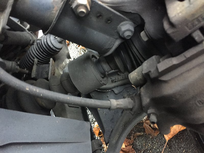

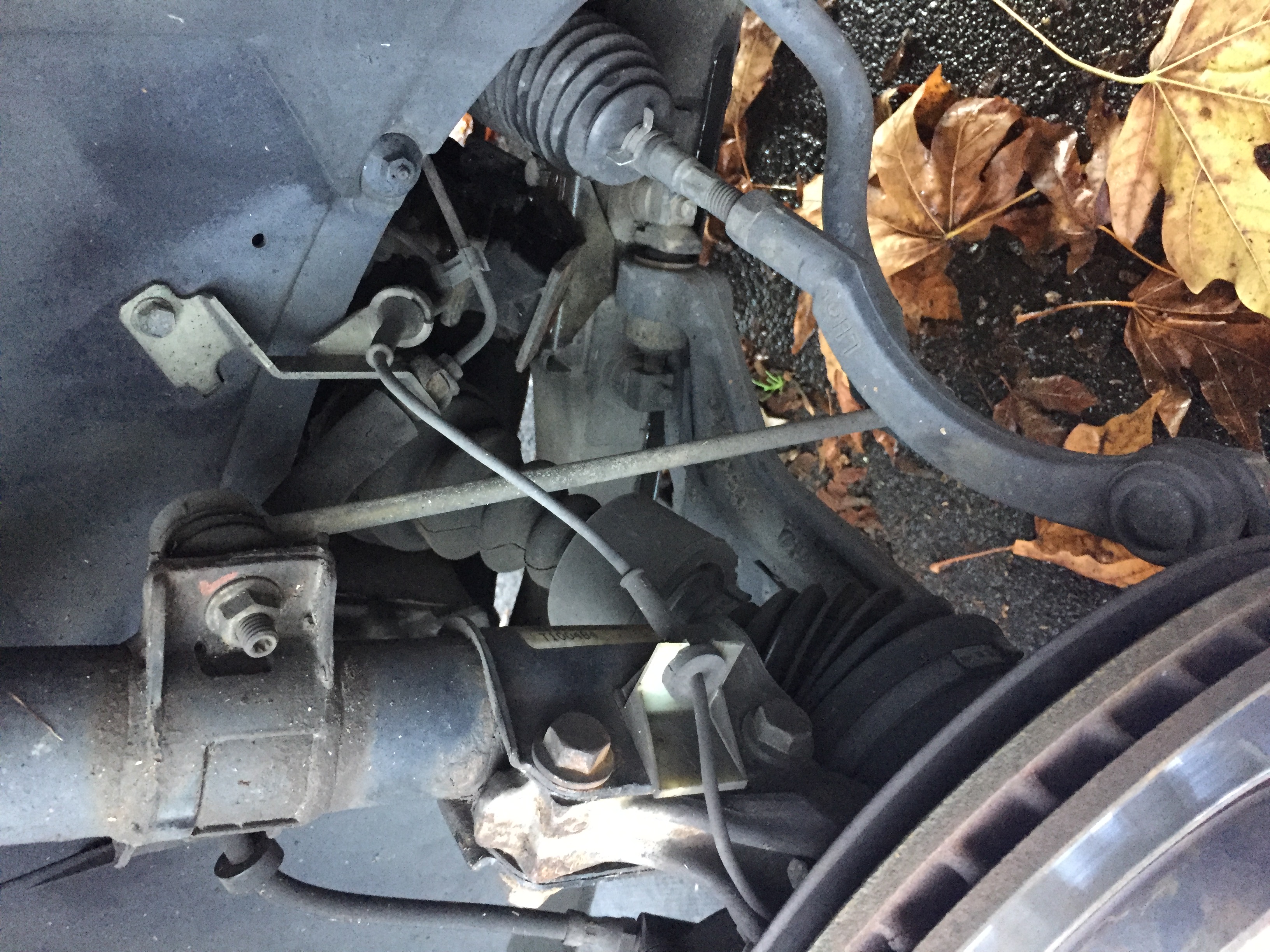

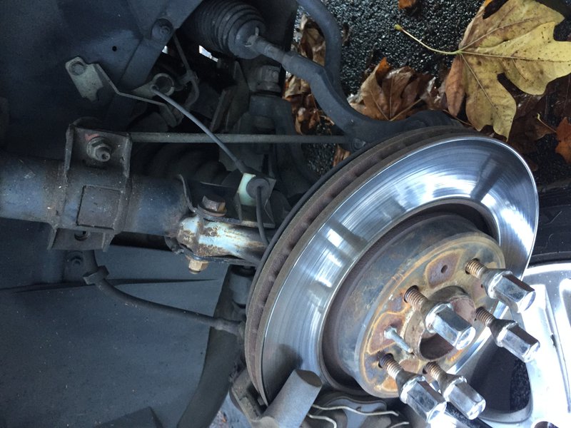

I really appreciate the input guys. I'm sure a lot of you have been there before but this has me really stressed out having a newborn and all. After getting the car into the garage and on jackstands I was able to remove all the wheels and really see what's going on. As in the video you can see the passenger front barely moving and easy to stop by hand. Looking underneath it the shaft is spinning at a fraction of the speed as the female side for lack of a better term. This has to narrow it down! Seems to be an angle gear problem but the rears are spinning fine. Is there a collar or spline I can replace or something?
- rspi
- Posts: 7304
- Joined: 05 Nov 2011, 10:40
- Location: Cincinnati OH
- Has thanked: 34 times
- Been thanked: 72 times
Contact rspi..
If the collar is worn, the gear teeth are likely damaged as well. You can pull the shaft out to see if that is the problem. Takes about 40 minutes.rdwhittaker wrote: Is there a collar or spline I can replace or something?
These are usually damaged if all tire sizes are not the same.
