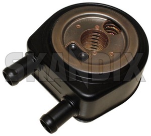

If you are sure you do not have a blown gasket, look right behind the oil filter is a oil cooler that should have a hose in and out full of coolent. I would look here as this is your oil water interface. see attached photos

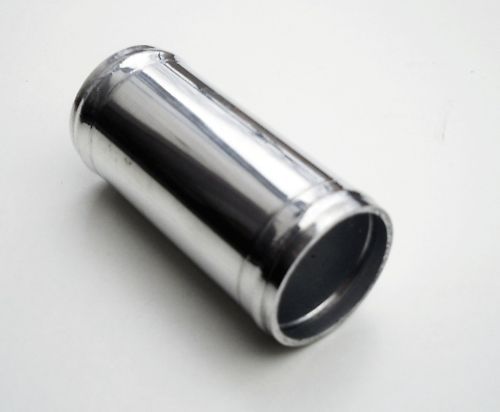

Bypassing this with a hose joiner would help you determine if this unit is faulty. Of course your oil will run hotter so drive conservatively.

You really need to work out which fluid is contaminating the coolant. Try the rag test on concrete and see if the concrete stains. Otherwise send a sample away for lab testing.
Way too much labour/cost involved unless you really know which fluid you're dealing with.

Did you bypass the oil cooler first? A head gasket's a huge job to undertake without eliminating other possibles
