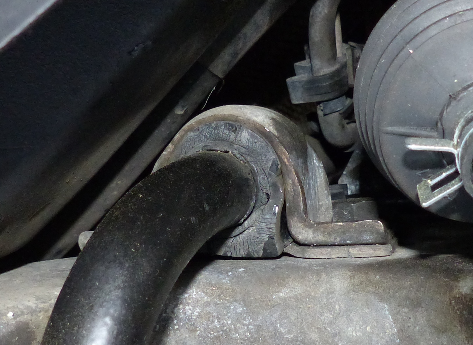

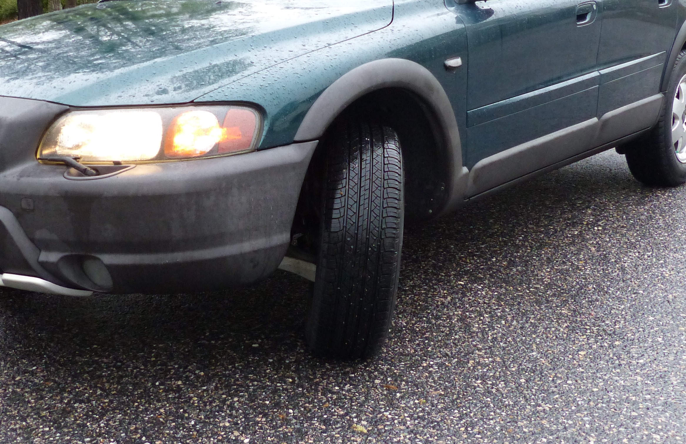

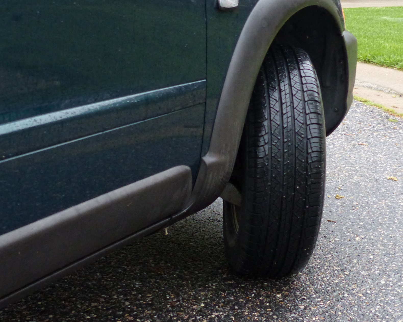

One other thing: I know for sure that the sway bar rubber bushings are shot. I'm now wondering what kind of effects they would have on vibration. I have to throw this out there... And yet another thing: Would you think this amount of tire/wheel tilt (caster) be expected on right wheel fully turned/locked left for example (picture). I was expecting at least a perpendicular orientation of the tire in this case. I'm also trying to determine if bearings or ball joints are giving under load thus contributing to vibration. I'm OK with the tilt on the left wheel lean with steering fully turned left for example.
