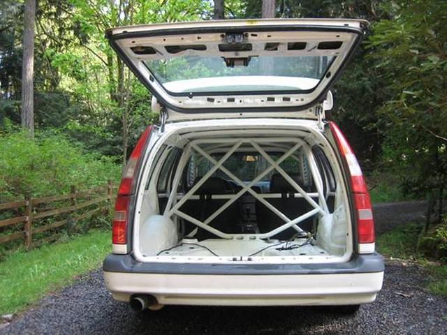

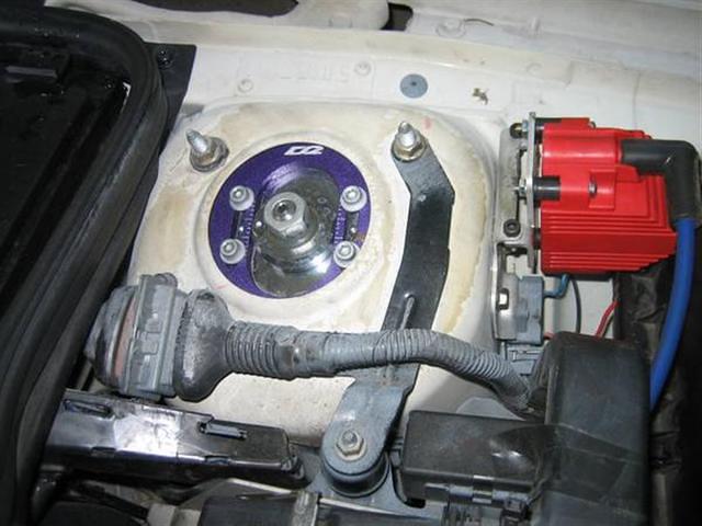

Edit: Give this a try Chris. I've seen these available on some performance sites. They adjust camber from the top strut mounting point for lowered/Racing vehicles.
Race Ready Wagon2.jpg (60.83 KiB) Viewed 1058 times
Adjustable camber strut  mount
Race Ready Wagon4.jpg (43.8 KiB) Viewed 1058 times
Race Ready Wagon.jpg (48.52 KiB) Viewed 1058 times
Race Ready Wagon3.jpg (64.66 KiB) Viewed 1058 times
Pretty nice setup I saw in another post. I guess this car is for sale.

I've got those same coilovers with the camber plates. My camber is very adjustable, just need to figure out where to set it.
