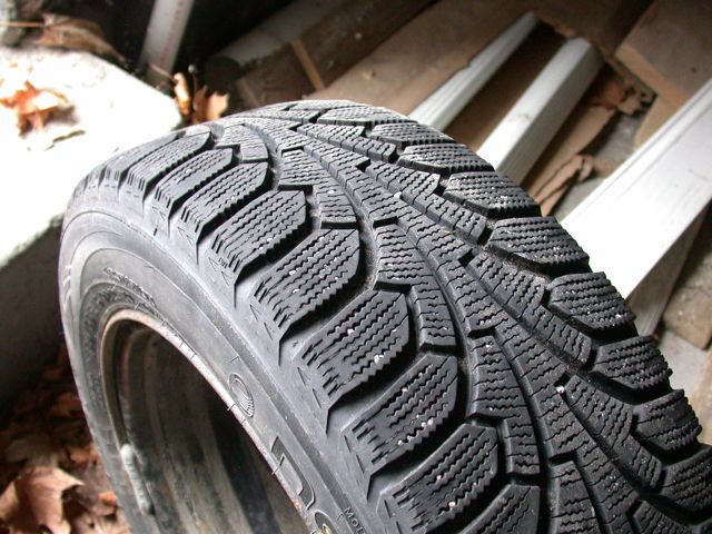

I'm trying to figure out why my front tires are wearing excessively fast on the inside edges. I've read a bunch of threads in similar topics on the forum, but can't quite get a good idea of what my specific problem is. Here is all the info I can think of:
These are my snow tires, and I put approx. 4,000 miles on them last winter. In Dec. when I put them on, they all had the same wear. When I took them off last month, the fronts looked like this:

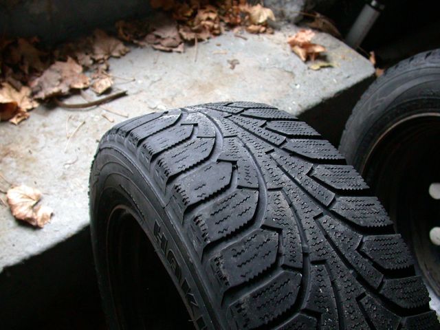

The rear tires look like this:
Both sides are about the same, symmetrically worn on the inside edge.

Tracking isn't a good diagnostic for alignment. I guess when your ball joints were done, someone did a bad job setting the toe-in correctly. Were tie rod ends done at the same time? Check them for looseness by jacking up, and gently push/pull wheel at 9 and 3 o'clock while watching for movement in the tie rod. There should be none.

Well, I got it in to a good alignment shop, and yep, the toe was really out of whack. Both fronts were about 0.75° off, which apparently is a LOT. So, I just have to not think about the fact that it basically ruined $400 worth of nearly new tires....

Those tires are still OK actually and were Toe-Out meaning left front tire pointed to the left side of the road and right front tire pointed to the right side of the road. Toe-In is when both the front of the front tires are pointed towards the middle/opposite side of the road respectively. Toe-In will wear the outer edge of the tires. The ideal is to have O degree Toe that is when both the left and right tires are parallel to each other.thedancingfiddle wrote:
Even when the alignment is still within factory specs they can be point to the extreme opposites of each other thereby wearing the tires quickly. This is where the Techs separate themselves from the guy who only follow instructions and diagrams on the alignment machines.
For next winter just put the even tires up front and uneven tires in the rear and the ones in the rear will eventually wear evenly.
