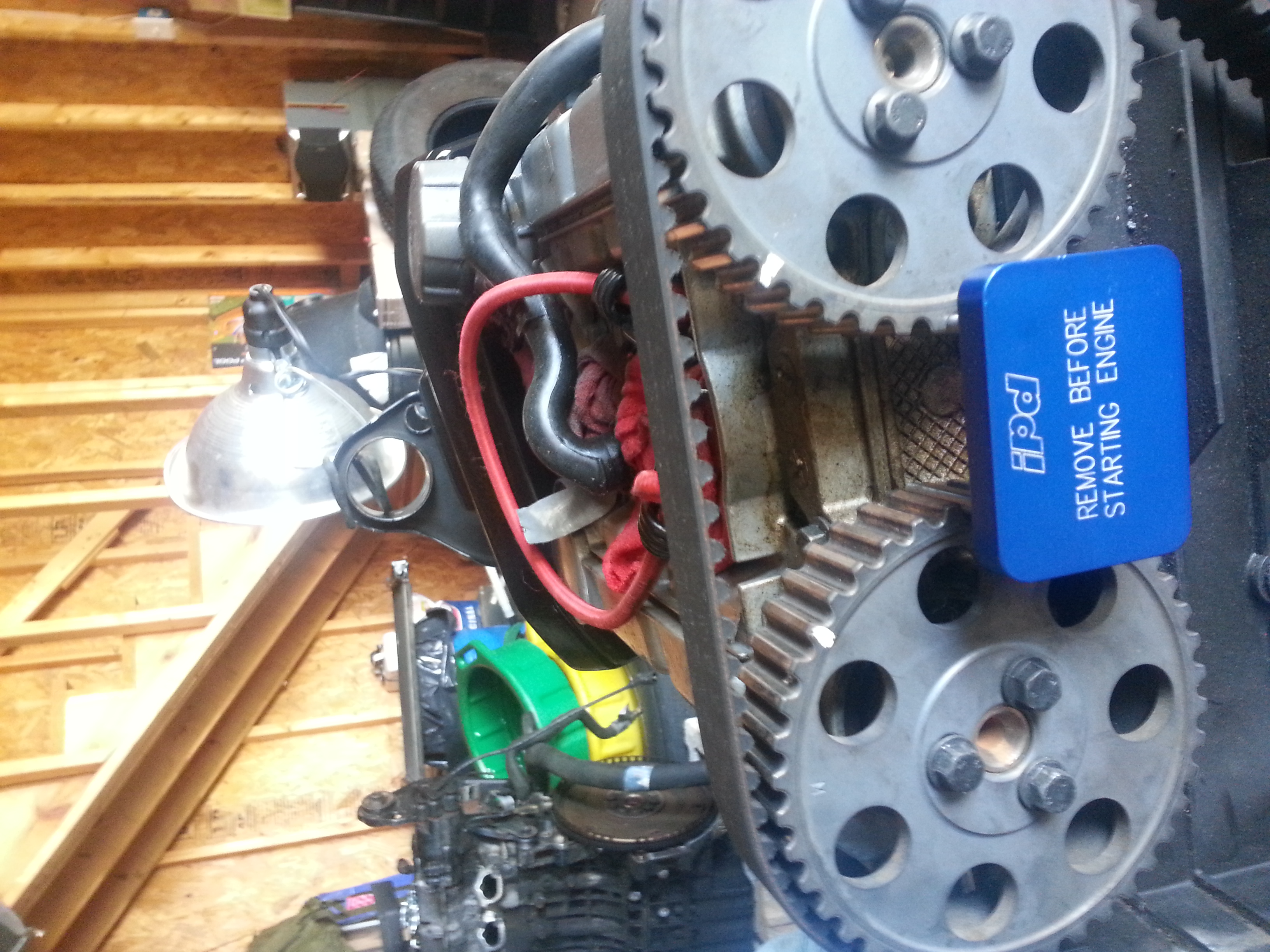

the timing belt new; i have notice after all marks are line up then i turn the crankshaft to take out the remaining slack, the exhaust cam is off 1/2 tooth; the last few timing belt i done had no problem, but this one, when I put the new belt on the belt teeth groove won't match up the exhaust cam groove

So maybe it is cam timing advance/retard: There is over a full tooth of slack in the bolt holes where the sprockets attach to the cams. The holes are oval, not circular. So that could explain it. If you get the slots on the backs of the cams perfectly parallel with the seam in the head, then where are your timing marks? If the exhaust cam is still off, then you could adjust it back that half a tooth via the cam sprockets mounting bolts.
But these are fine points, they will not relate to the engine starting or not.
