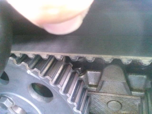

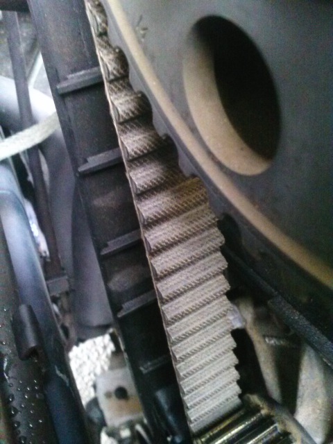

Thanks. Again only 74K....unfortunately no record of Timing belt change. However, here are some pictures...thoughts?
- belt1.jpg (80.71 KiB) Viewed 1547 times
- belt2.jpg (92.75 KiB) Viewed 1547 times
- Posts: 35284
- Has thanked: 1502 times
- Been thanked: 3813 times
Timing belts get replaced on both time and miles, so you should put this on the to do list. It sucks when they break, as in 2000 USd of head repair, so you have to divide your risk aversion factor by your karmic score to achieve your timing belt replacement priority score. Use SI units please, these are European cars.

Timing belt and tensionors MUST be done before you even drive it.
It's a time bomb waiting to explode at these years

I wouldn't even start the car before changing the timing belt (all parts). If you have to move the car have it towed.

Thanks. I will have it replaced. Great just to start from scratch with this car. What's typical cost of timing belt/water pump at a private service shop? $800-1000
- Posts: 35284
Probably 500-600 at Randall Volvo ( independent) in Renssalaer. Heartily recommended
