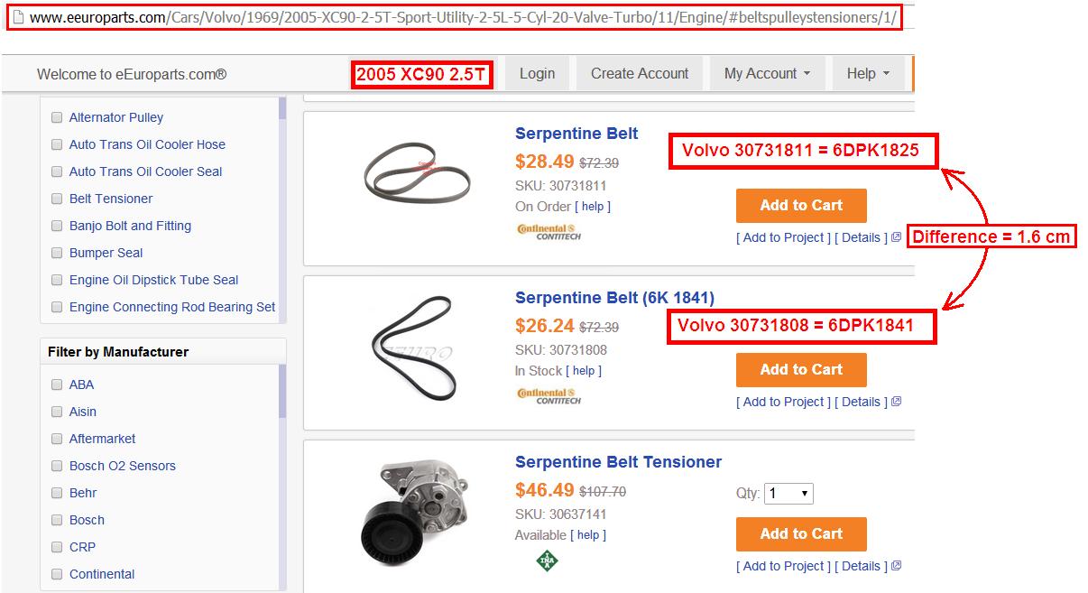

I browsed different websites, Volvo dealer and autohausaz, rmeuropean, eeuroparts etc. and get different answers for the 2005 XC90 2.5T Serpentine Belt!
Some websites say the difference is with and without AC, but as far as I am concerned, all of these cars have AC.
The Serpentine Belt options:
Volvo 30731811 = 6DPK1825
Volvo 30731808 = 6DPK1841
Any Serpentine Belt guru here?

Check it against chassis #.
x808 for 0 - 288075
x811 for 288076 - 999999
http://volvopartslisle.com/assembly/63692196/2005-Volvo-XC90/Auxiliary-Belt-Drive.

I think I found the answer. It is the PS Pump Pulley design change.
2005 is the transition year for 2.5T engine layout.
2004 ---> some 2005: PS Pump PN is 8251738
Some 2005 ---> 2006: PS Pump PN is 36002540, which has a smaller pulley diameter ---> slightly shorter serpentine belt.
