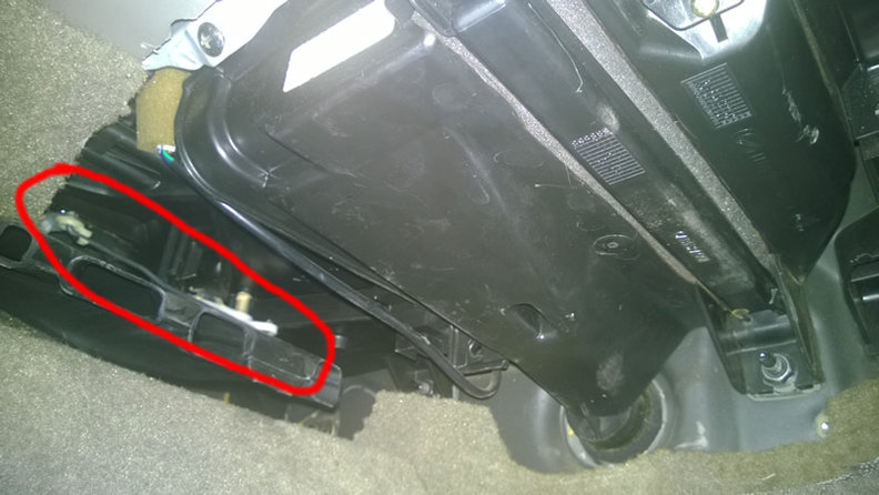

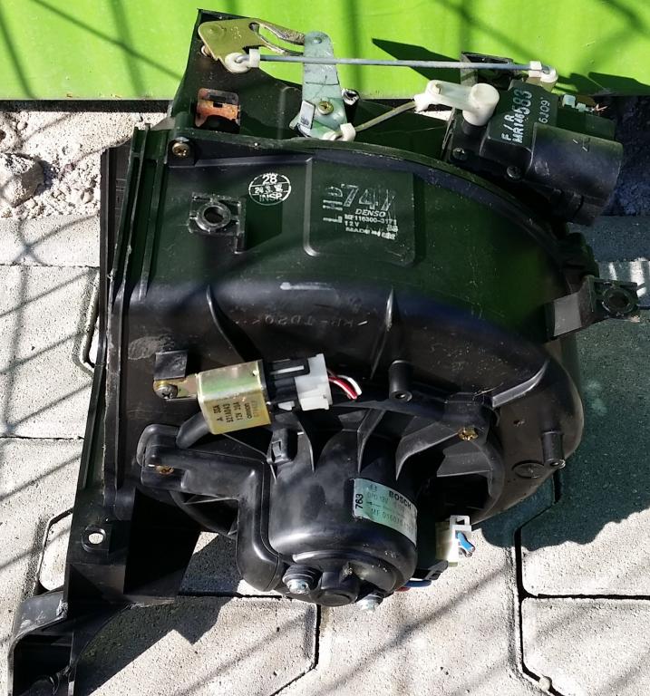

The clicking noise is coming from the far right but the only place that has arms that move is to the far left in picture. The second picture has blower motor but no blend door actuator that I can see. Can anyone point to where it would be on a 2003 S40
TIA
where red is circled is only place that looks like it would be blend door

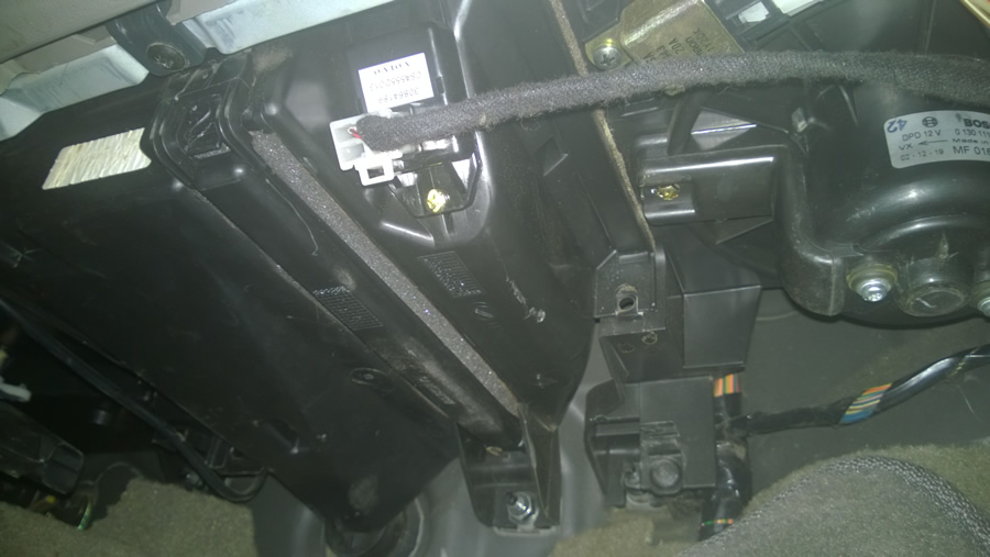

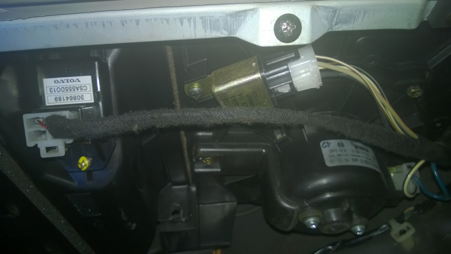

I have done a search on all the part numbers I can read but all seem to be relays and such. This is
the number MR146583 but I do not see anything that looks like it, Last picture on the right shows where noise is coming from.
