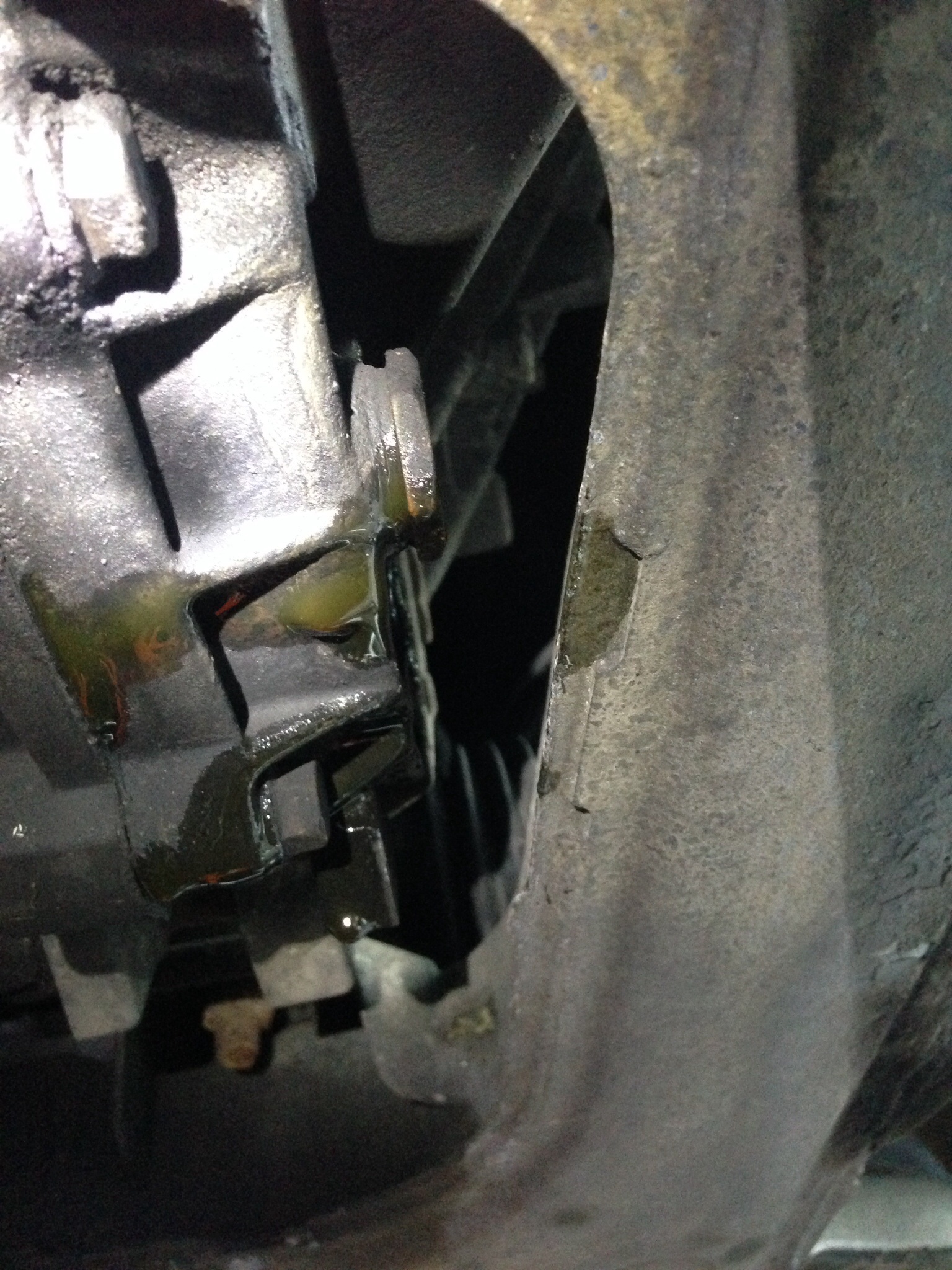

I performed a manual transmission oil change replacing the 16 year old oil with Mobil one synthetic
Key word M56 manual transmission oil
View of drain fill 24 mm bolts
Can't get socket on this puppy...

abscate wrote:...Can't get socket on this puppy...
What about an angled box wrench on the plug, and then have your three cats teach that puppy who's boss :lol:
BTW, what did your old oil look like (besides sediment, did you see any brass particles from the synchros)
When I was draining my 5 sp manual (the 1987 340DL) I was surprised to see how clean everything was :D

I actually promise I will strain it through a coffee filter to see how much metal it has, after 4 drivers and two teenage learners on the transmission. I could not see any.
An angled 24 mm box fit the drain perfectly. An open crescent wrench on that big plug would be fine too.

Jimmy made a great suggestion about changing lube in the transmission. Remove the fill plug first! If for some reason it is stuck you haven't drained the transmission and then have no way to fill it back up.
I'm guessing that one came from experience. :D

Well, you can pop the driveshaft and fill it through the driveshaft hole...see picture

Or, you could rig up a sealed connector to the DRAIN and fill it that way - either gravitationally or using a $9 Fluid X-fer Hand Pump from HFT 8)

Or drill into the Al case and then bung it up with a rubber stopper....is that too "ghetto"

abscate wrote:Or drill into the Al case and then bung it up with a rubber stopper....is that too "ghetto"
:mrgreen:
That is, more or less, the official procedure to add the drain to the bevel gear except that you drill through a bolt hole. The factory procedure does specify to use thread tape when the stud goes back in though which I guess de-ghettos it.
