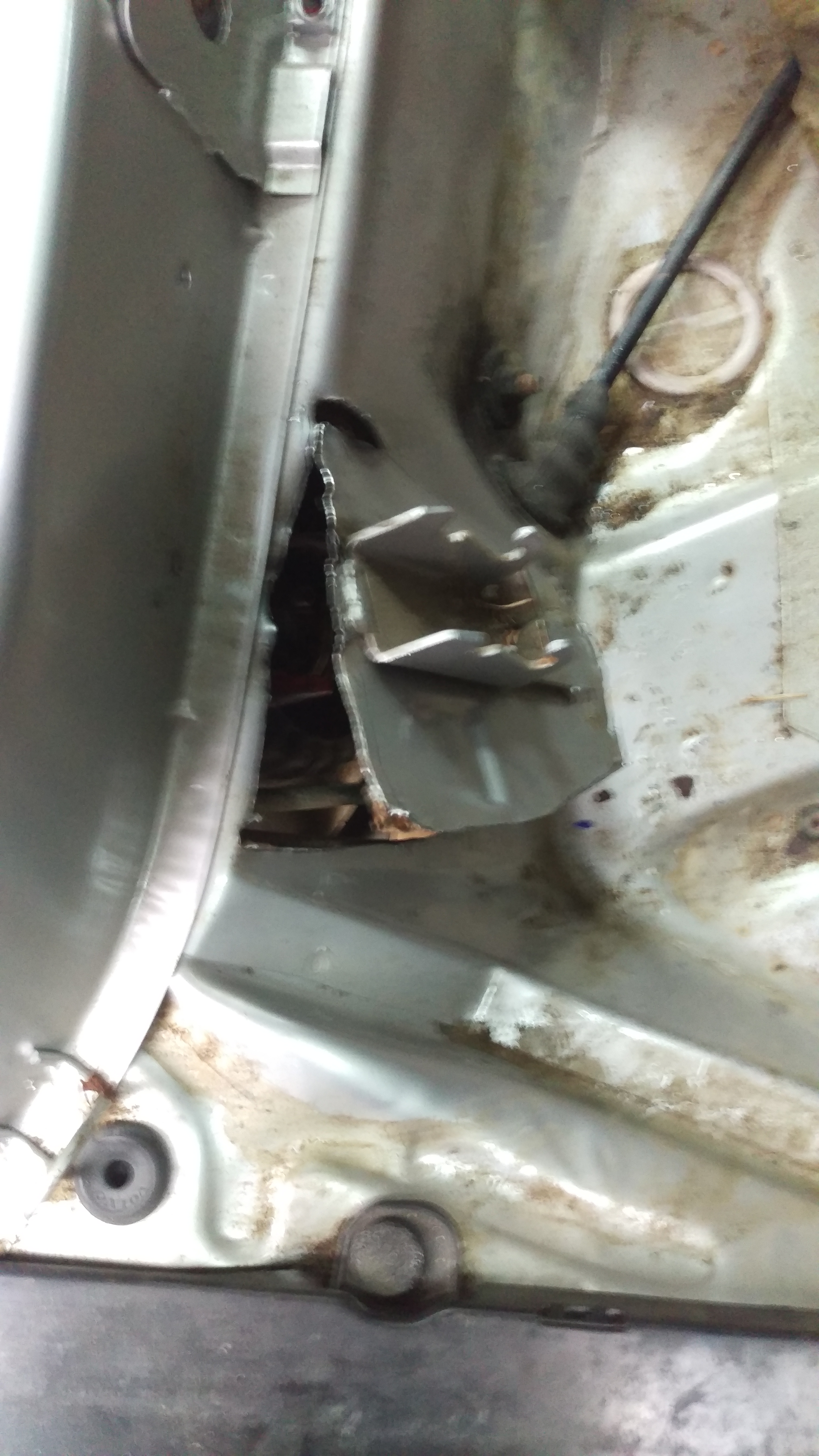

hi guys,
just replaced my pump, i wanted to add some tips to the thread.
i cut the top part of the panel when doing the pump, in hindsight it would be better to cut the bottom panel because the seat pulls the panel down when attached.
i ended up tack welding the panel back and worked great. if you used fastners, i think aluminum or zinc plated bolts would be better. Inititally before welding i tried stainless steel bolts, but upon further research the bolts would have caused some galvanic corrision to the panels.

On the two that I have replaced I did cut the bottom rather than the top for that precise reason.i cut the top part of the panel when doing the pump, in hindsight it would be better to cut the bottom panel because the seat pulls the panel down when attached.

I just did the same job. The cutout makes it much easier than dropping the rear end and the tank.

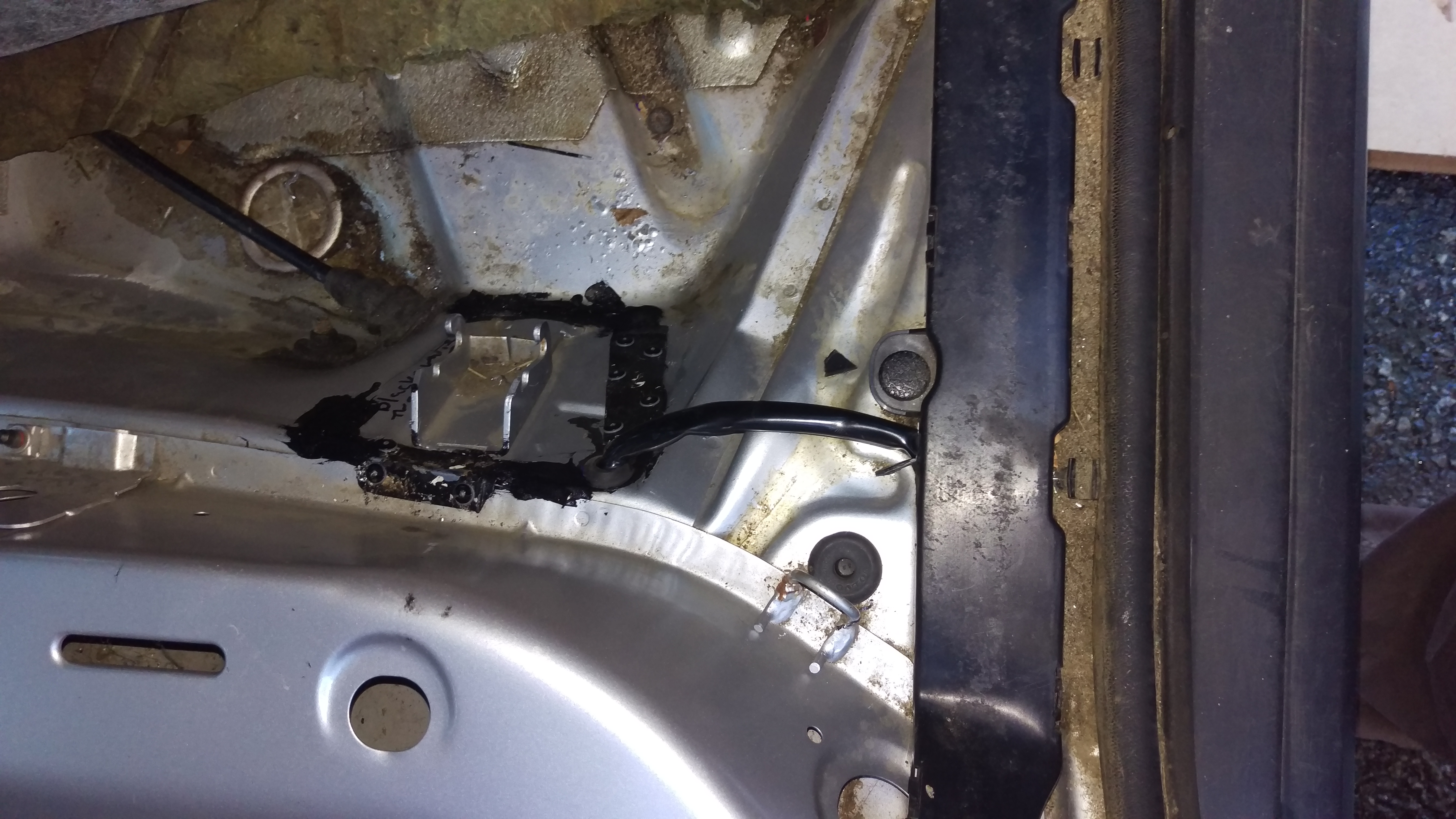

I just did this on my 98 xc70 and this thread was infinitely helpful. I did the cut out method for mine as well and I replaced the whole unit rather that just do the pump. The one thing I did different than I've seen here, was actually run the new harness through the corner where I made the cutout through a grommet. Then through the wire loom on that side up to the connectors. I have pics I'm going to try and post. Thanks for the awesome thread everyone!
