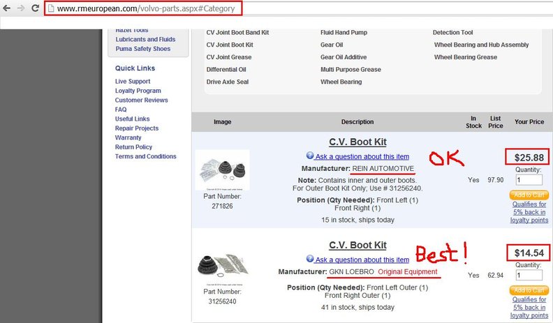

My experience with REIN is so-so. After 3 years, the Boot starts to show minor cracks.
GKN-Lobro is OEM, it is good stuff and should last you some 80K-100K.
Check to be sure, but the CV Boot is about $15 or so at rmeuropean dot com...

OP needs the CV joint, not the boot. He is in Sweden, Cam didn't you have a link to a European supplier?
- Posts: 8363
- Joined: 31 Mar 2010, 09:54
- Location: Omaha NE
- Been thanked: 504 times
Erik, You are correct. My bad!
OK, for the CV Joint...drgswede1978...Go to ebay UK website and search "volvo xc70 cv joint".
The trick is to search using GKN PN 302148!!!
http://www.ebay.co.uk/sch/i.html?_from= ... v&_sacat=0
It is about £75.60 + £25.00 shipping from the UK to Sweden...
I wonder...since you live in Sweden, the very same country where your Volvo came from, is it easier to get parts?
