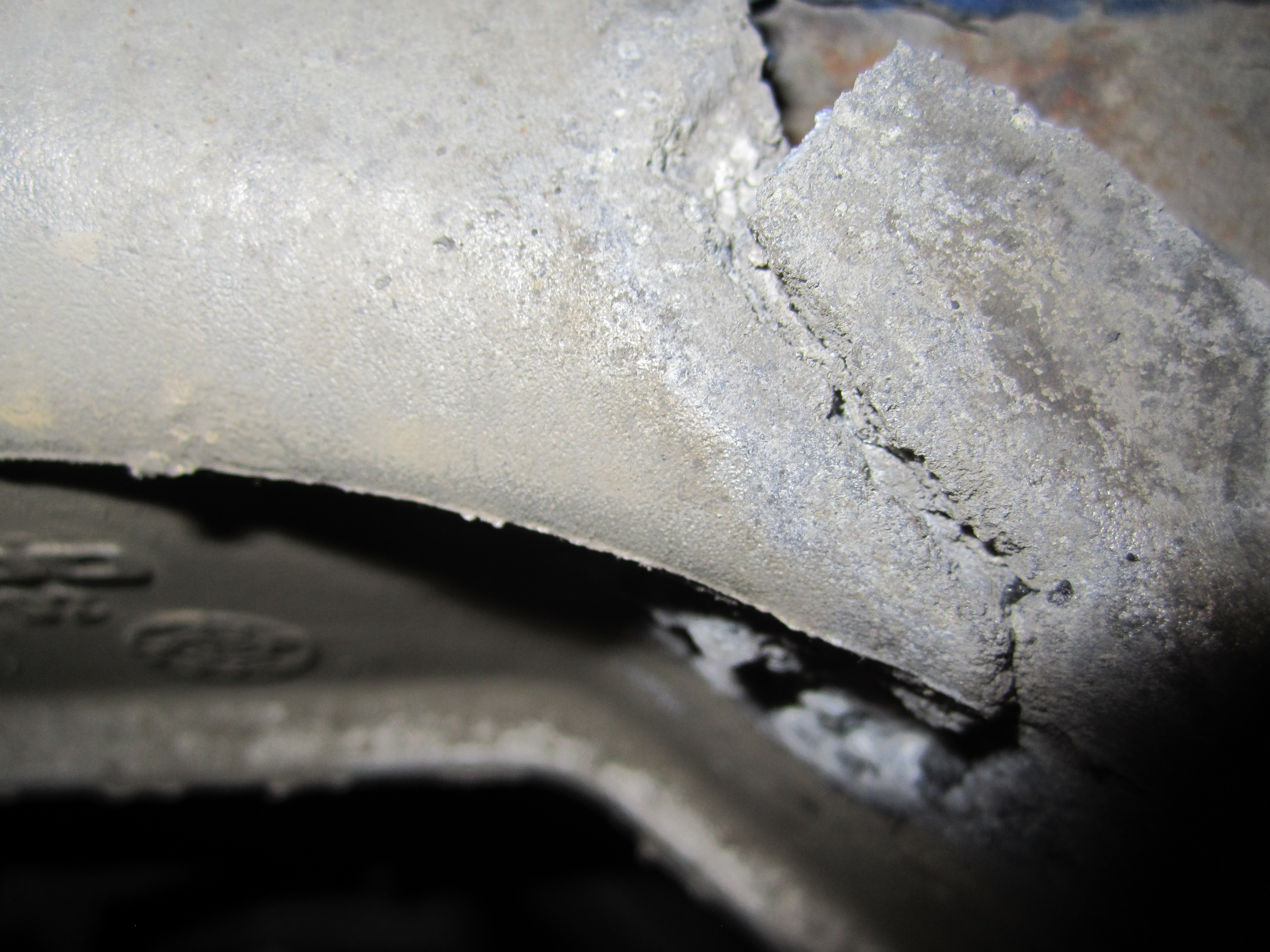

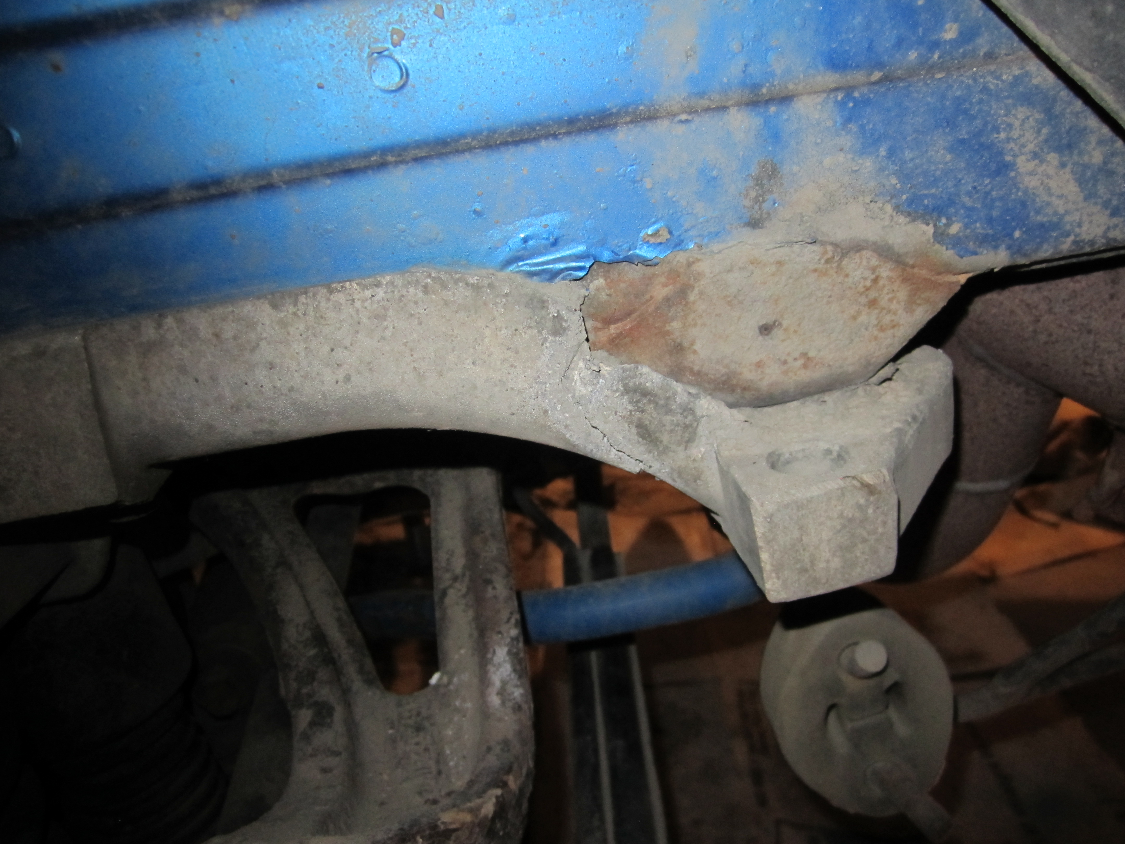

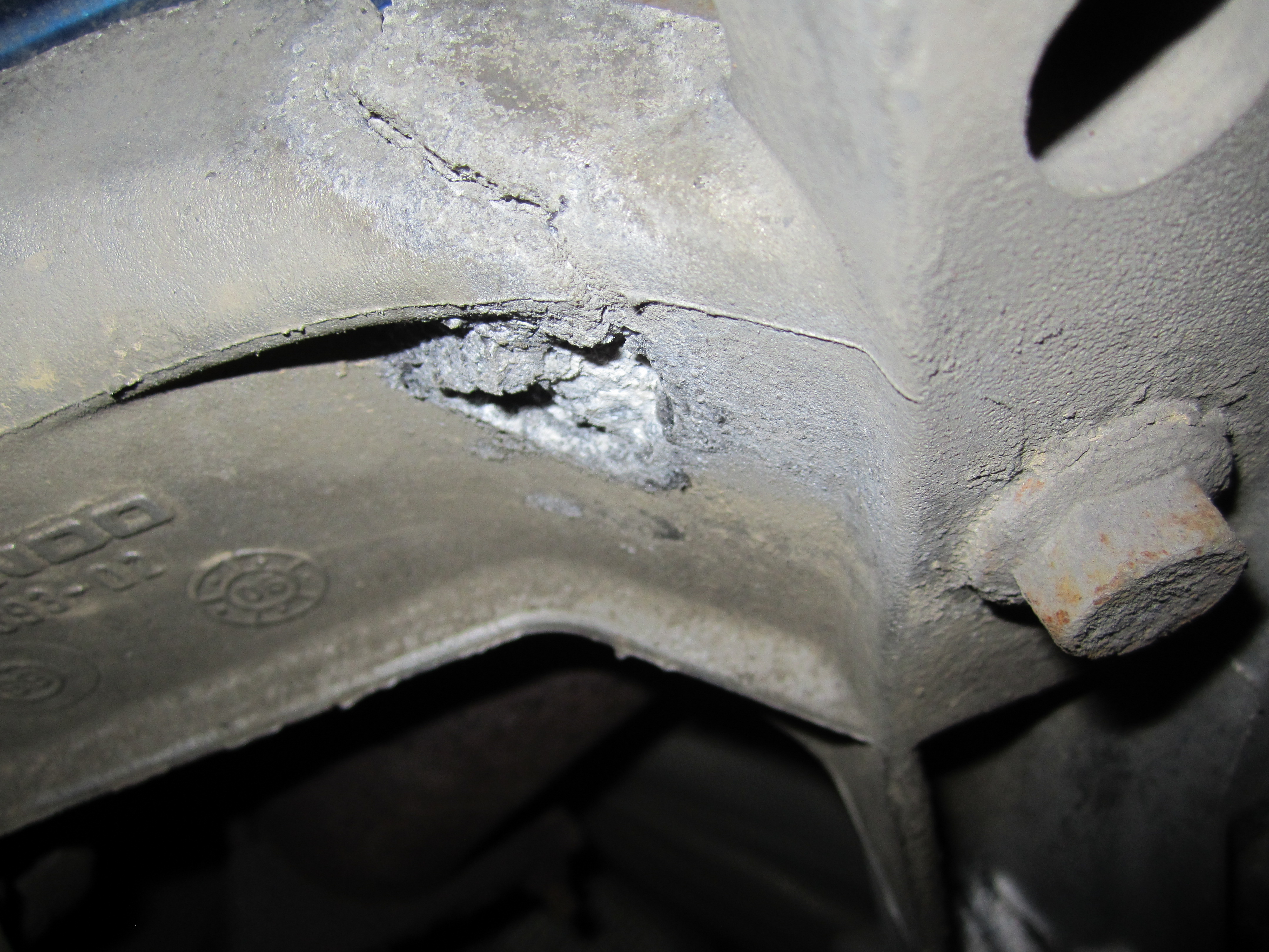

Has anyone else had this happen, and know what the cause is? I've attached some photos that hopefully show corrosion and a crack forming on my 2000 V70R rear sub-frame just in-front of the rear mounting bolt on the LH side. I have the same problem with my 98 V70XC but on the RH side at exactly the same place.
I was just about to put the car up for sale until I pulled the wheel on the last axle to adjust the e-brakes and there it was right in-front of my face. The frame is N/A so will have to try to find a used one hopefully from a dry area without corrosion. This looks like galvanic corrosion between the frame and the sub-frame.

When I had the same problem with my 98 XC, I took it to a specialist welder (in oil country we have lots of specialist welders) and the were reluctant to try to weld it in-situ as too close to fuel tank, but also said all the aluminum in that area was crumbling, so weld would likely not take, and if it did, it would not be strong. I might take the old unit back to them and let them have a go, so if it fails no big deal.
