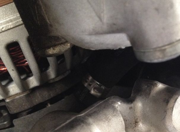

Thank you Zachary for an awesome post. I have a few questions as I am attempting to service the PCV and run into a few problems taking the manifold off on my 2002 C70 2.3 Turbo convertible.
1) Do I have to remove the oil dipstick to remove the manifold? I have already loosen it. 2) Do I have to remove the coolant line going to the thermostat? Can someone recommend a tool to cut the hose clamp in this tight area? 3) How do I remove this hose? I have already cut the hose clamp (permanent type) but it will not budge and I do not want to damage the hose. Thanks everyone.
