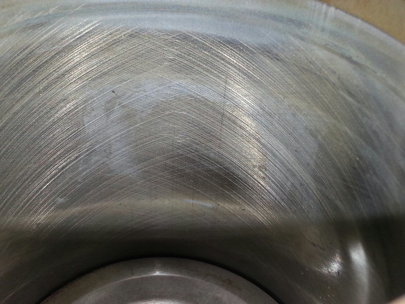

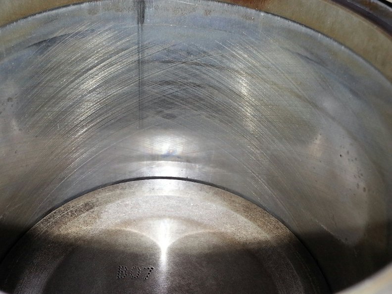

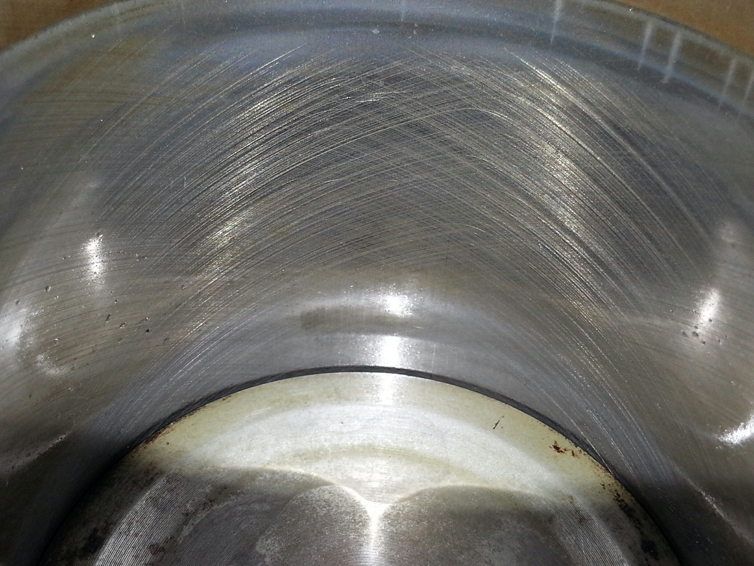

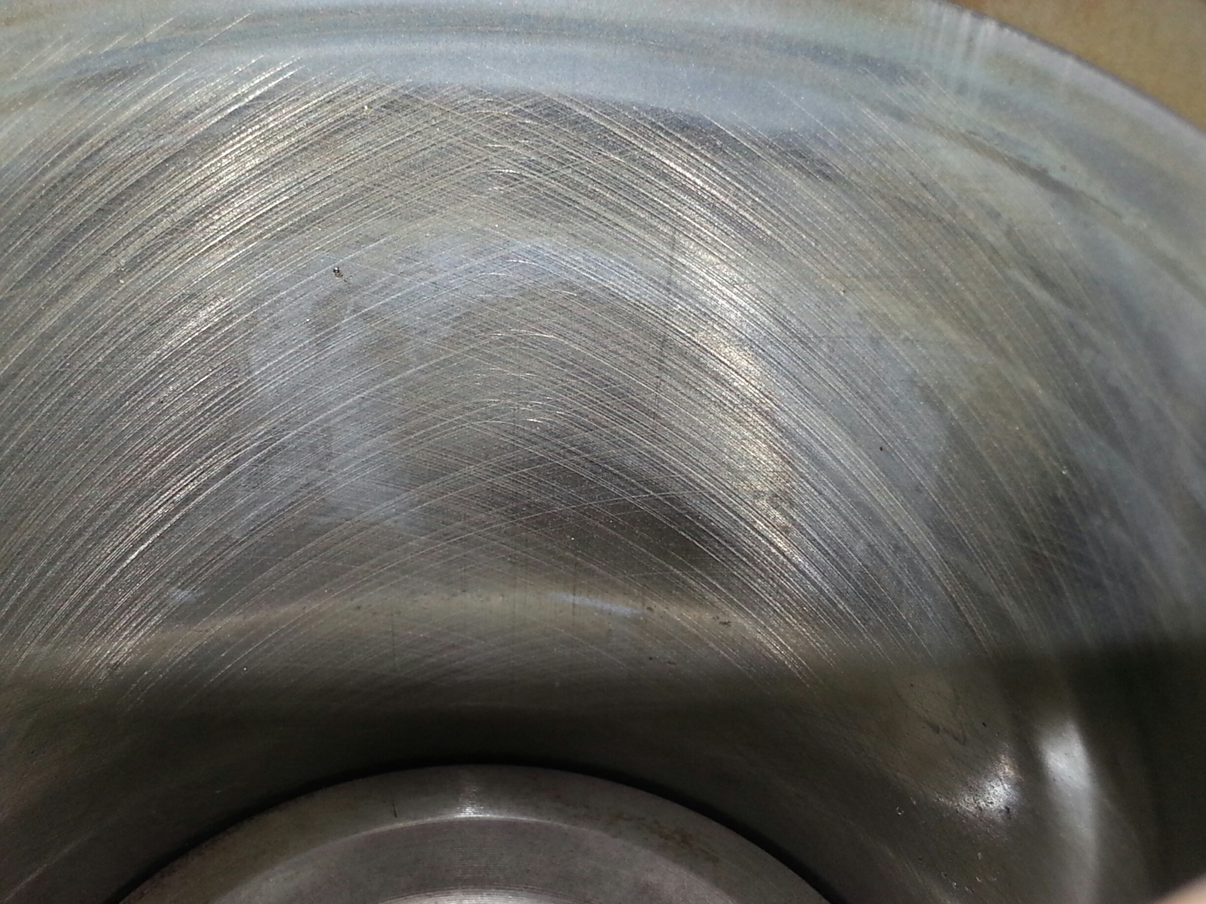

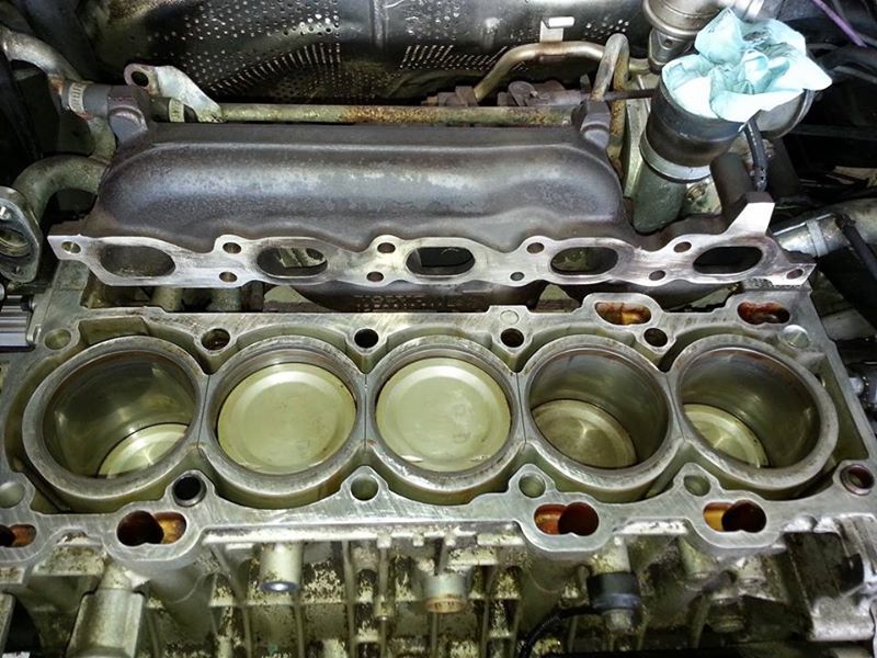

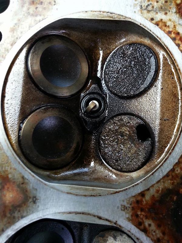

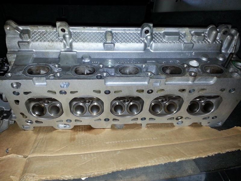

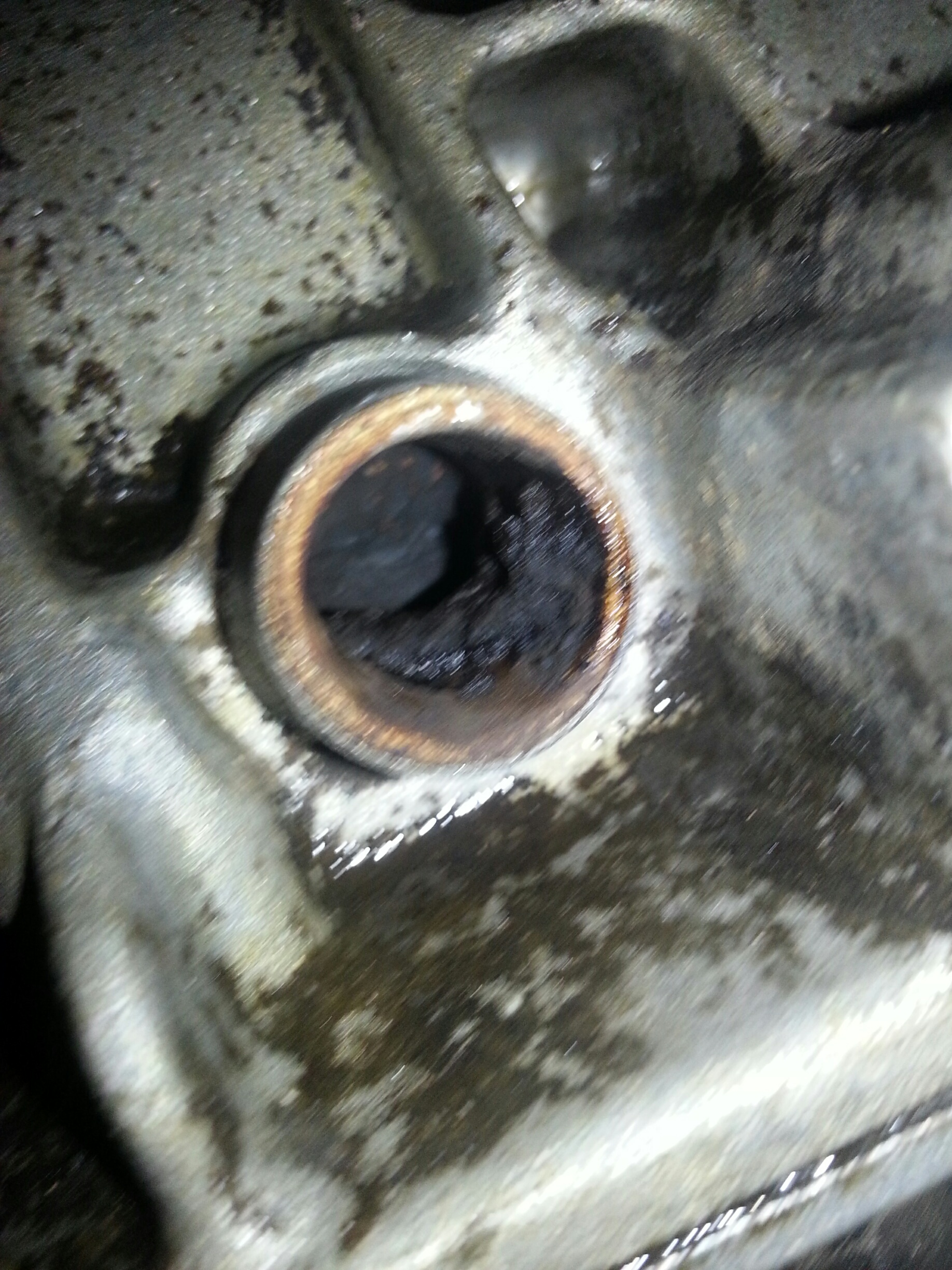

Some pics of it when i had it apart, thats not a scuff on cylinder 4, its just a smudge i think, i cant seem to find the close ups i took at each cylinder at BDC

I guess there was a scuff on cylinder 4, and a couple tiny pits on the cylinders, i don't remember that, i couldnt find the other two cylinders, thats 3 of them, 1 of them being #4. Maybe i should do a compression test again. I couldnt find a sodium filled valve i spent some time researching and got a good replacement but now i cant find the receipt for the valve to see the brand and part number. It was a stellite valve.i think it was an AE valve 7mm.
Edit - Nevermind those arent pits, those are dirt/fibers from the cloth when i wiped cylinders down with oil.

Based on the pictures you posted It is obvious that you know what you are doing and further that you do it right. Having oil come out of the dipstick, even without a good O ring shouldn't happen without PCV problems so my guess is that it it coming from somewhere else. I think we can rule our camshaft seals since they are new.

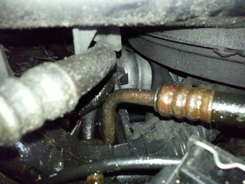

Thank you Lee, I'm going to do some reading on the oil cooler lines. I saw some lines running to the bottom of the radiator, i assumed they were transmission lines, i didnt even think to check to see if this had an oil cooler, that very well may be the case if there are rubber oil cooler lines, its coming from the front of the engine, almost looks like the AC compressor is leaking oil, and it is on the rubber hoses up there, but i think they are AC lines, and trasnmisison lines.

The lines on the right hand side of the radiator that go into sockets on the radiator tank are the engine oil cooler lines and the ones that go into the tank on the left hand side of the radiator are the transmission cooler lines. For whatever reason, the transmission lines don't seem to go bad nearly as often as the engine oil cooler lines. I guess that it is because the transmission lines are so much easier to change.

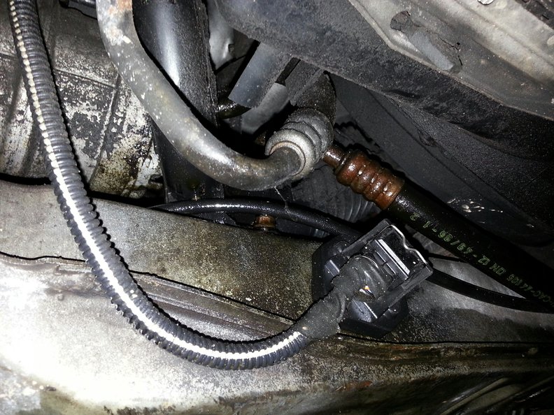

shawnmacananny
- Posts: 23
- Joined: 19 Jul 2014, 14:27
- Year and Model: 1998 V70 T5
- Location: Felton, DE
I looked at a few threads, and tried to take a couple of pictures. I didnt get that great of pics because i wanted to keep the oil off my phone. I am fairly confident the oil cooler lines are leaking, i'm going to try to find them and order them. Thank you again, i didnt even realize there was an oil cooler, and even an oil cooler thermostat? never heard of one of those before either.
Ozark Lee
- Posts: 14798
- Joined: 07 Sep 2006, 08:24
- Year and Model: Many Volvos
- Location: USA Midwest
- Been thanked: 76 times
From the pictures I would say that the oil cooler lines are the culprit. The lines in most of the pictures are indeed A/C lines but they have more or less parallel paths with the oil cooler lines and they are about the closest thing to them. The A/C lines themselves rarely leak and even if they do there isn't that much PAG oil in the system.
The OEM replacement lines are insanely expensive (around $125.00 each) but you can rebuild the old lines with hydraulic hoses and hose clamps for a fraction of the cost. There are several good threads and we may have some information in the repair database on repairing the lines. To make things real easy there is a guy that is primarily active over on VolvoSpeed that sells repair "kits" with the hose and hose clamps for not a lot of money. I tried to locally source some bulk hose from Tomkins Industries, which is the big hydraulic hose supplier in my area, and they didn't have anything that fit the Volvo connectors in stock at the parts counter. I'm sure someone will jump in the the supplier's screen name since I can't remember it.
