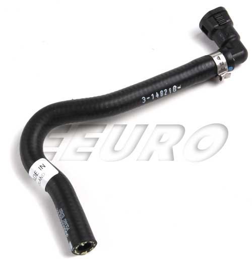

I ran into needing the Bleeder hose fitting this weekend. 02 S80 T6 262936. The bleeder hose goes from the top of the expansion tank to the center of the timing belt cover where many engines have a bolt hole (my 850 Turbo has the bolt). The end of the hose toward the engine/thermostat housing has a quick disconnect fitting. The dealer told me that (my 2014d version of VIDA confirms this) that I need to order the newer hose (30680933 $21) and a new belt cover (30637974 $90). ???? I came home tonight to research this a little more before spending over $100 for a $5 quick connect. I found that Europarts has what I need. I really only need the fitting on the end.
Volvo Expansion Tank Hose - Genuine Volvo 30680933 Looks like the same part number as above to me. I am going to order this part tomorrow and hope I don't find out why it calls for both.

- Genuine Volvo 30680933.jpg (11.51 KiB) Viewed 2061 times

Be very careful as you manipulate the timing cover off the engine, as you're very likely to break off the plastic nipple that the quick-connect fitting on the hose connects to. In which case you will need a new thermostat housing (around $105). I advise everyine not to go for the URO metal repair nipple because many are too small for the quick-connect fitting to properly seal, so you still have a leak. There are a couple of relatively recent threads on this issue. Good luck,
