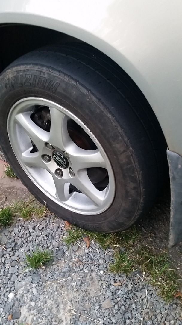

Looks like tires might need to be on that list, too!
Tires are definitely on the list! Car rode much better today, and I didn't hear the noise but will look into it tomorrow.

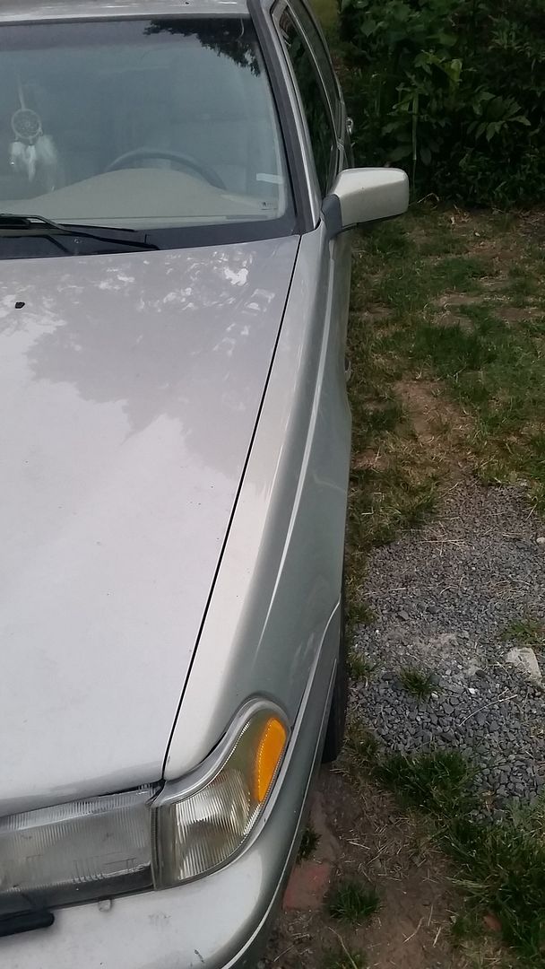

got the hood better aligned:

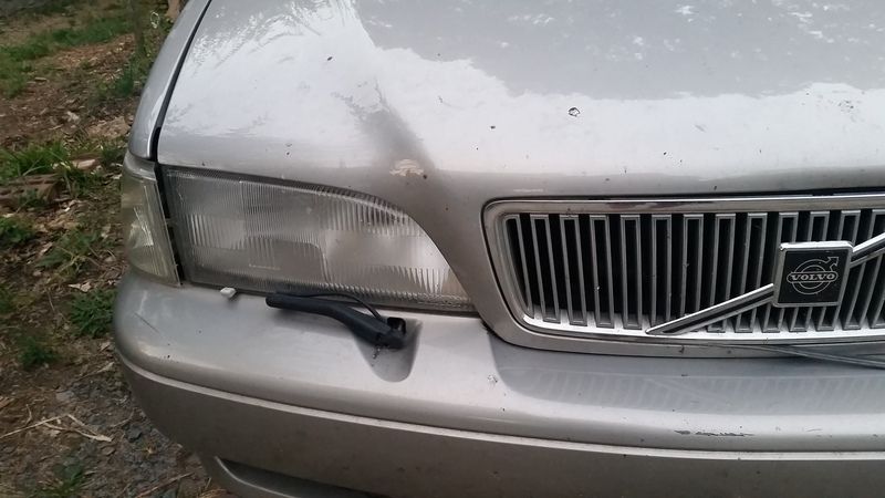

thinkin about some door panel surgery/rehab...

What's going on with that door panel. I have some parts and pieces that might help you a little. That looks pretty rough.

Ah, it's not that bad. Super glue fixes everything!obayha wrote:What's going on with that door panel. I have some parts and pieces that might help you a little. That looks pretty rough.![]()

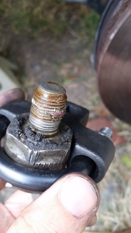

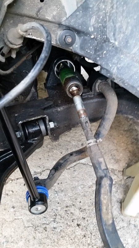

Got the inner and outer tie rods done. Was gonna pay a shop to do the work + alignment, but the first place I called said they wouldn't put the parts on for me and I was like wtf so I did it myself. Really wasn't that bad, even with the less-than-ideal tool I bought from autozone for $20 bucks. The good feature of this tool was that I could take the inners and outers off without separating them.
this image shows the driver side after getting the outer tie rod disconnected from the hub and after having pulled the old boot off the inner rod. The inner joint was so floppy, literally no resistance to movement, and the same for the outer joint.

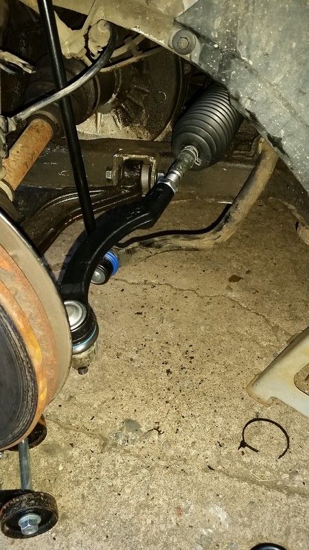

Here we have the completed driver side showing new control arms, inner & outer tie rods (both Lemforder) and iPD HD sway bar end links.

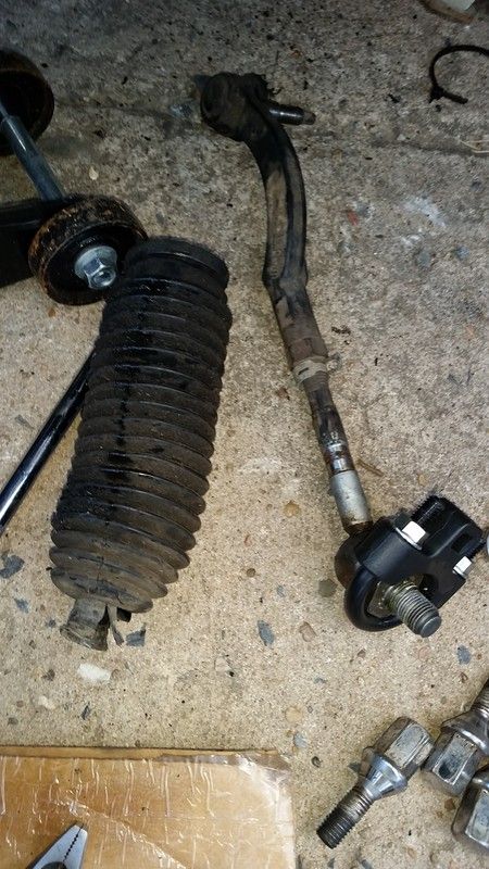

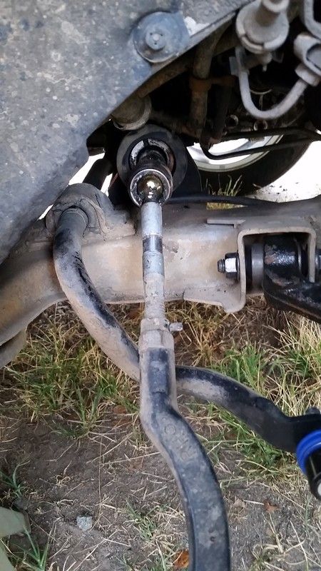

Here's the passenger side during dissasembly. This side's boot was severely damaged. It was torn at nearly every "bellows" trough, and completely separated right above where the rack is exposed. There was a good deal of grit on the shaft behind the inner tie rod ball joint... Also, this side did not have a plastic-y collar thing like the other side. Is it supposed to? This side was also much more difficult to unthread because it was starting to seize on there. This makes me worry I may have damaged the seals of my rack... no noticable drop in power steering fluid though. Hopefully it'll last quite a while longer :/
below is a close-up of the inner tie rod once I finally got it removed. Notice the gunk
you can also see the tool again here

The guys at the shop told me my front right camber was off enough to require adjustment, and that my struts had no way to adjust except by oblonging the bolt holes where it attaches to the hub. They charged an extra $50 for this work. Has anyone else ever had this done? Brand new tires and the alignment work, and she drives quite nice now.

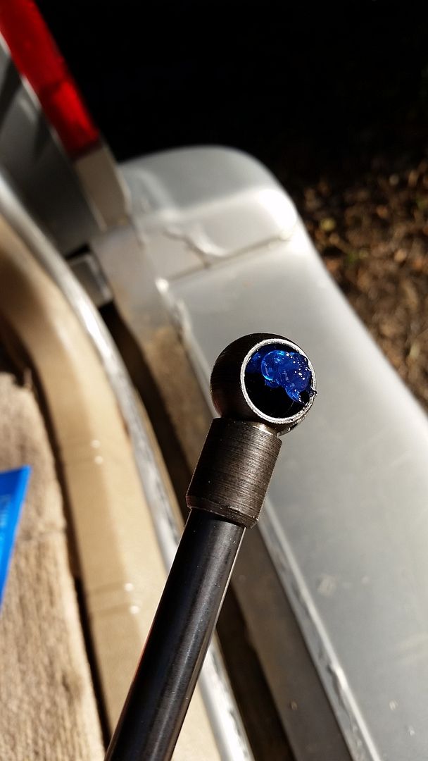

Bonus pic of one of my new tailgate struts during install. I thought I'd be clever by putting some anti-squeal grease in the socket. I noticed when I got to the other side, there is already some grease down in there, although not much. Can't hurt right?
