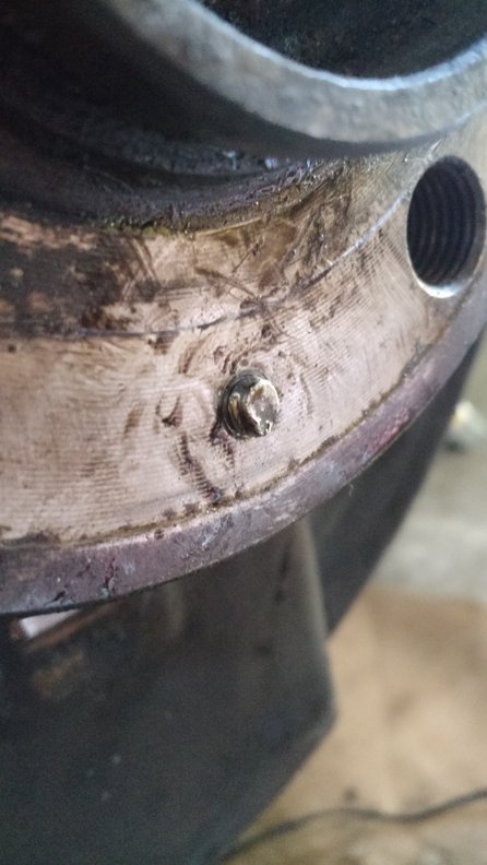

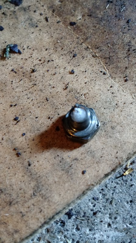

Good evening fellow Volvo enthusiasts. I have a question. Is it viable to leave a 10mm mounting bolt off of a rotor? It snapped in two as I was mounting it on and since it was pretty old and worn, I should have been more gentle with it. I heard that some people leave it off with no issues. I am currently working on putting new rotors and pads and this is the only issue I have that is delaying my work. The other half has been left embedded and I have been trying to unscrew it off. Any advice is welcome and thank you for taking the time to read the post.
Have you tried using vice grips to remove it? It's a non issue in the function of the brakes the lugs hold the disc. It's just to keep it aligned until you assemble the brakes and whatnot as was already said.
