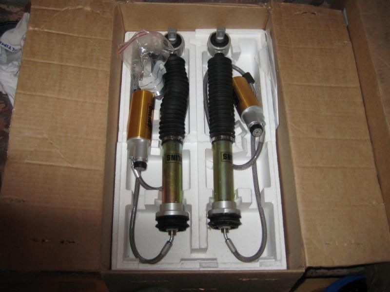

I have to ask, What is that apparatus running along the strut brace that resembles two copper ballasts with conduit on either end.

Scholz wrote:I have to ask, What is that apparatus running along the strut brace that resembles two copper ballasts with conduit on either end.
I can answer that. They are the (nitrogen) gas reservoirs for the factory Ohlins front struts.
The rear shocks also have reservoirs

Yup - that's exactly what they are.
I've since moved the reservoirs away from the center as much as possible to try and keep them away from the heat.
Good idea, as it gets quite hot right over the turbo/manifold. Can they be fit along the insides of the fenders?
