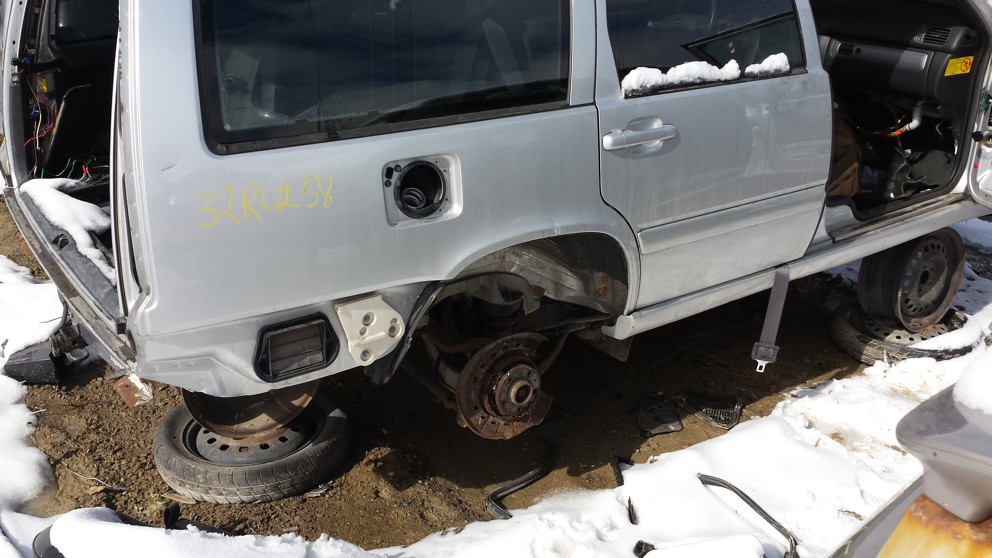

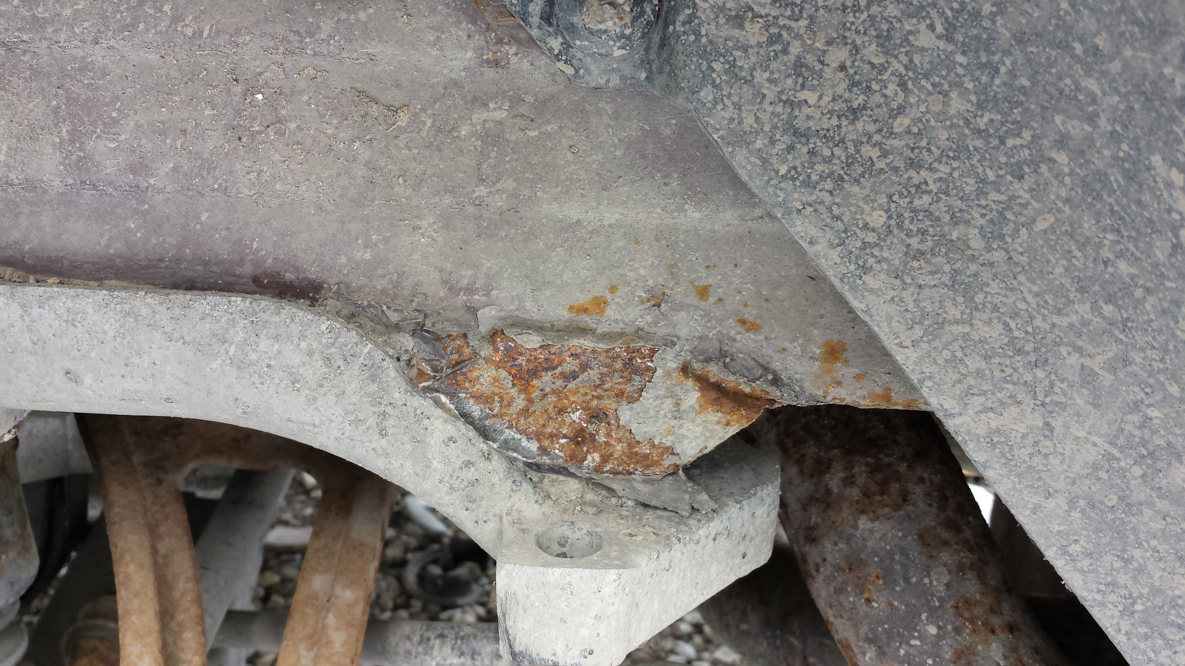

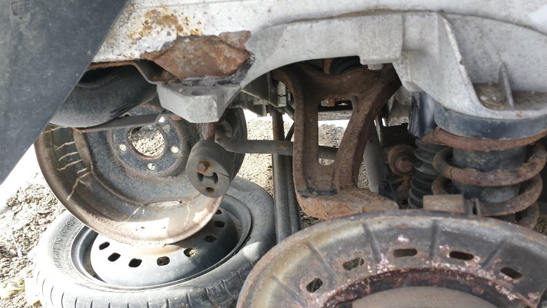

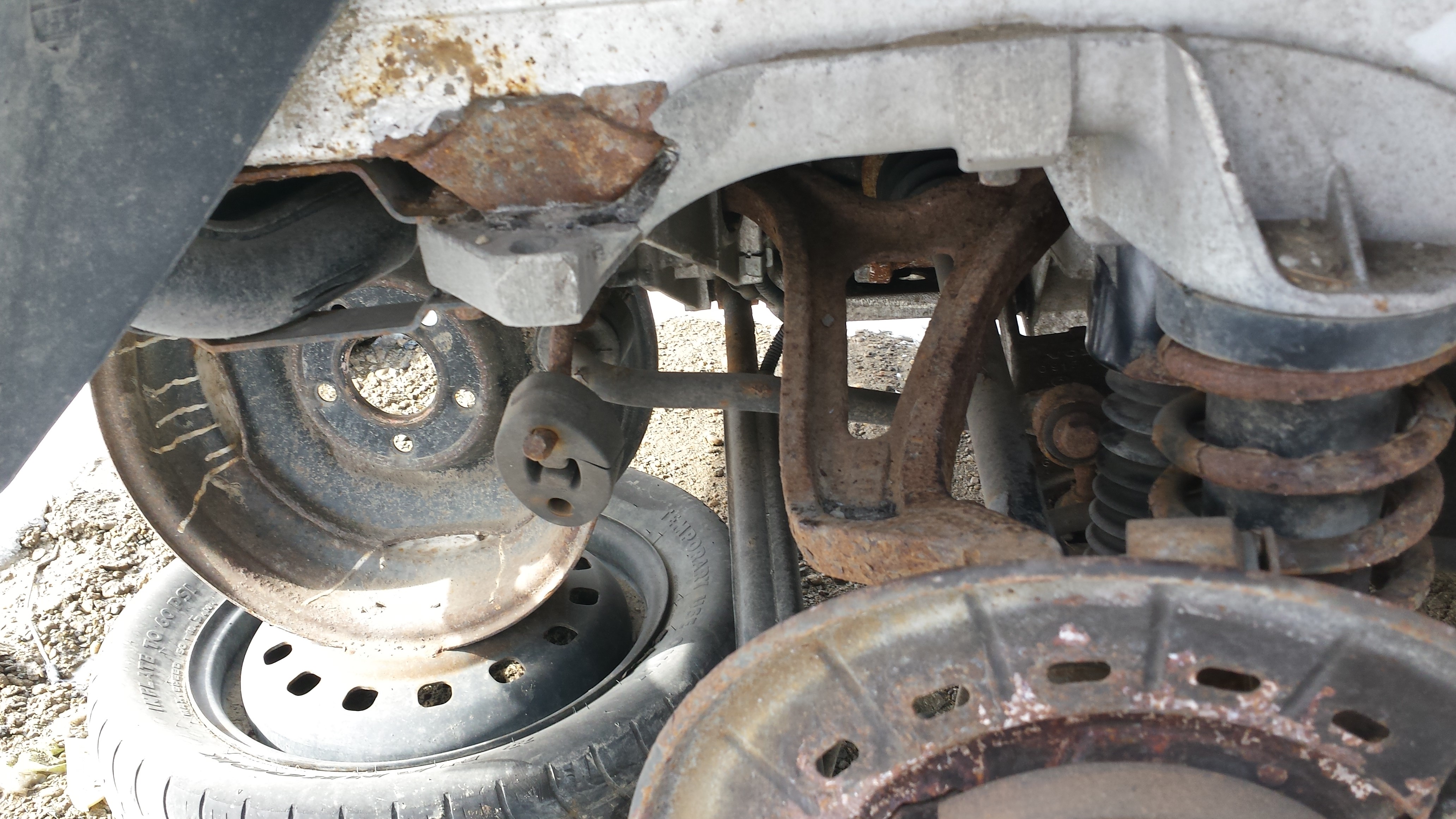

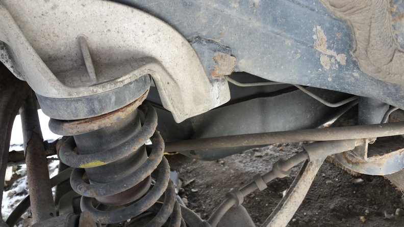

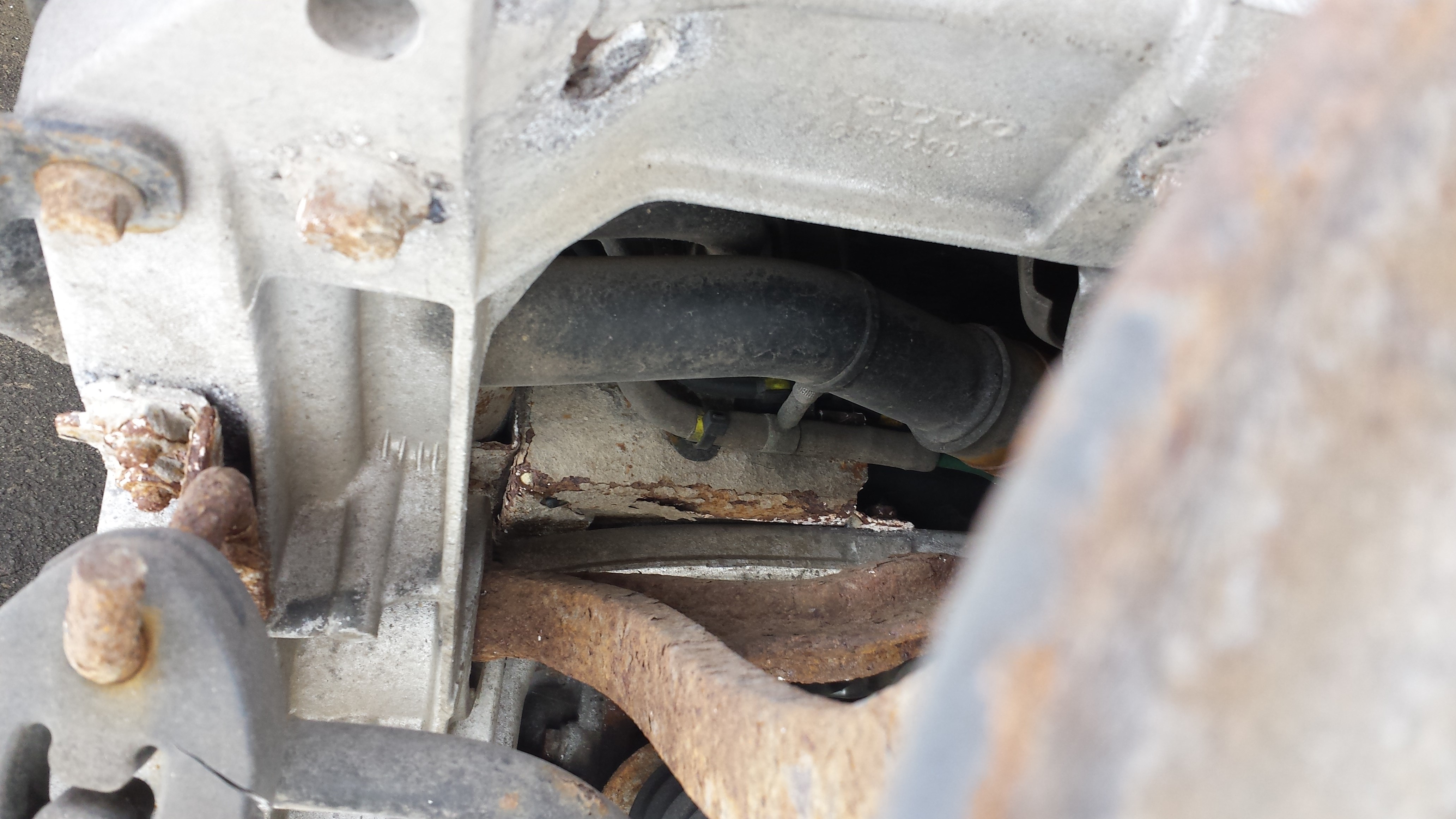

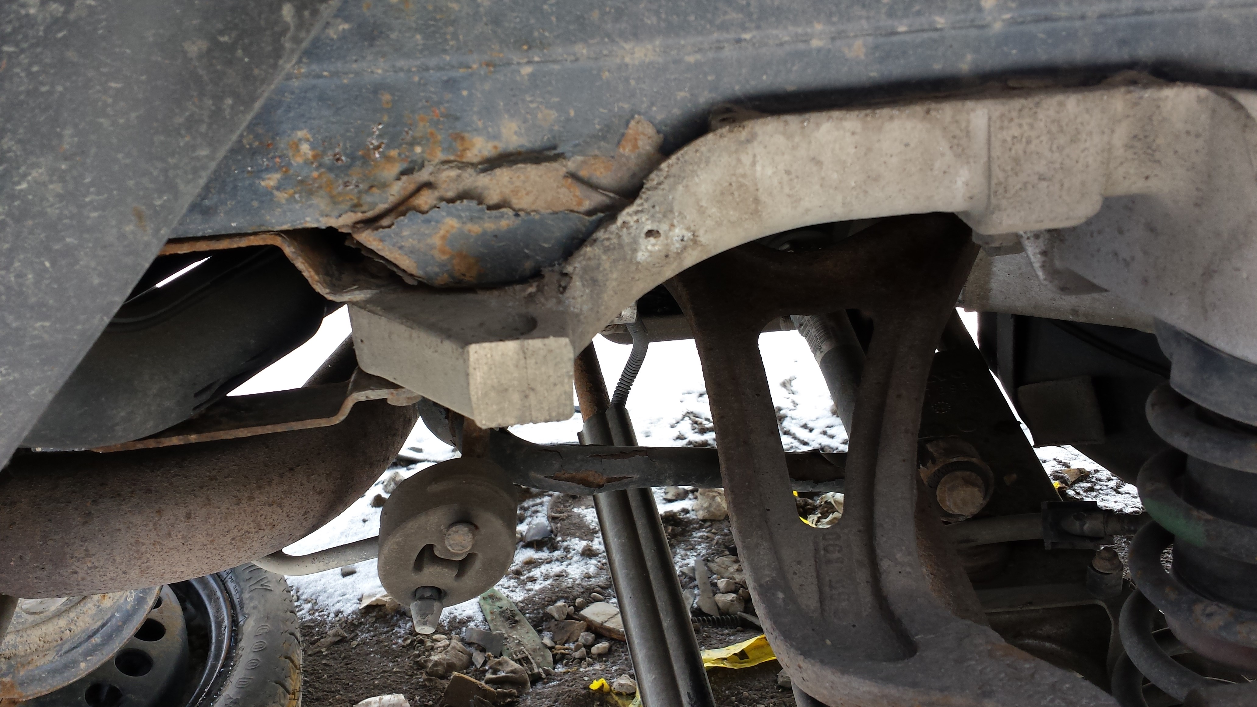

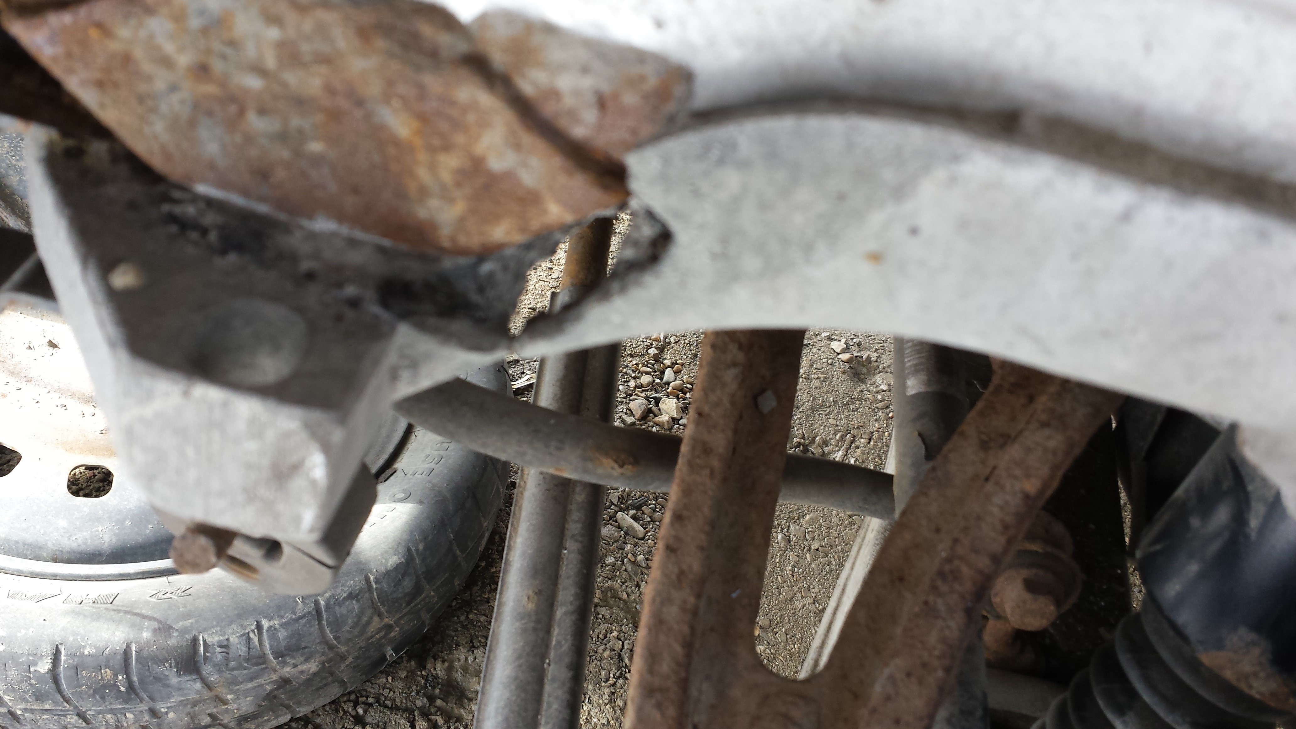

Thought it was worth updating this thread. I spoke to dealer, and Volvo Canada/North America, and they claimed to 'never have seen this problem before' so basically ignored me. The service manager said it would be good it I took the failed item to them so they could send it to Volvo for further analysis (conspiracy theorist in me says to hide the evidence!!).
I have reached the point of getting the garage almost tidy enough to start work on the strip down in the next couple of days, but thought some of you may be interested in some of the pictures I took of AWD P80's in the last few weeks locally. This includes a 2000 V70R and 2 x V70XC (99 and 00).
Strangely the worst example by far, was the 2000 V70R which was bad on both sides, but much worse on the RH rear (opposite to my car, but same as my old 98 V70XC).

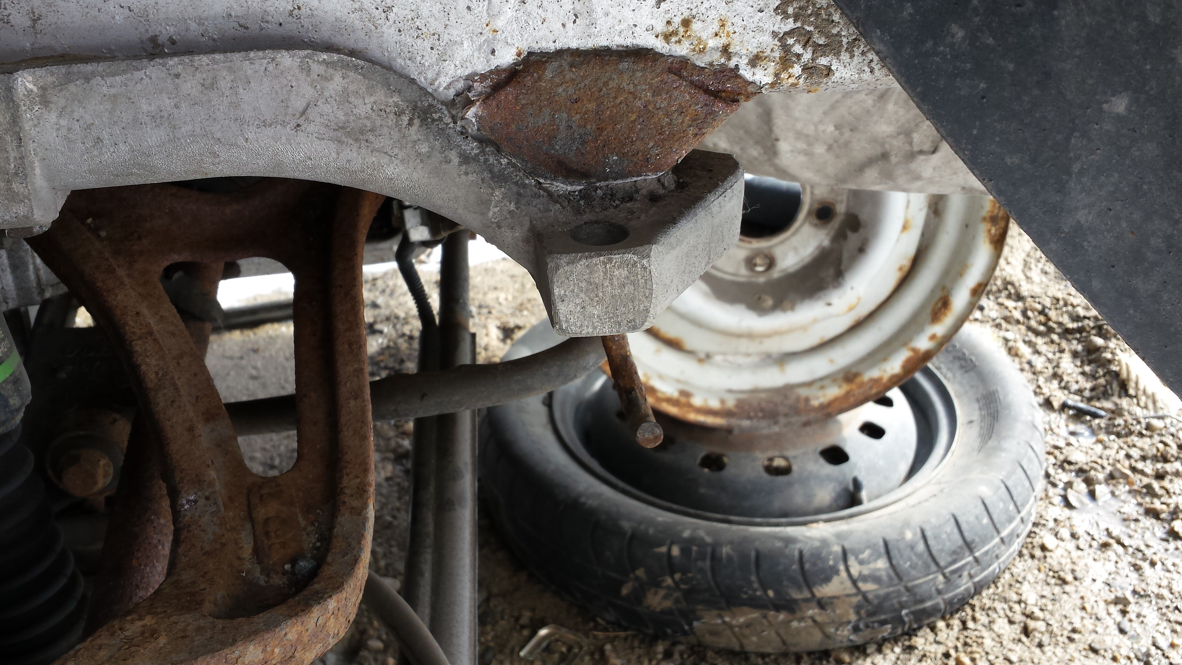

First car - 2000 V70R
Rear sub-frame RH side. Notice chunk missing from side flange.
Picture taken from underneath looking up at sub-frame. To top of the screen you can see a hole in the frame!!
Looking down on the frame and you can see right through it as it is missing!
LH side of 2000 V70R. Corrosion starting on opposite side.

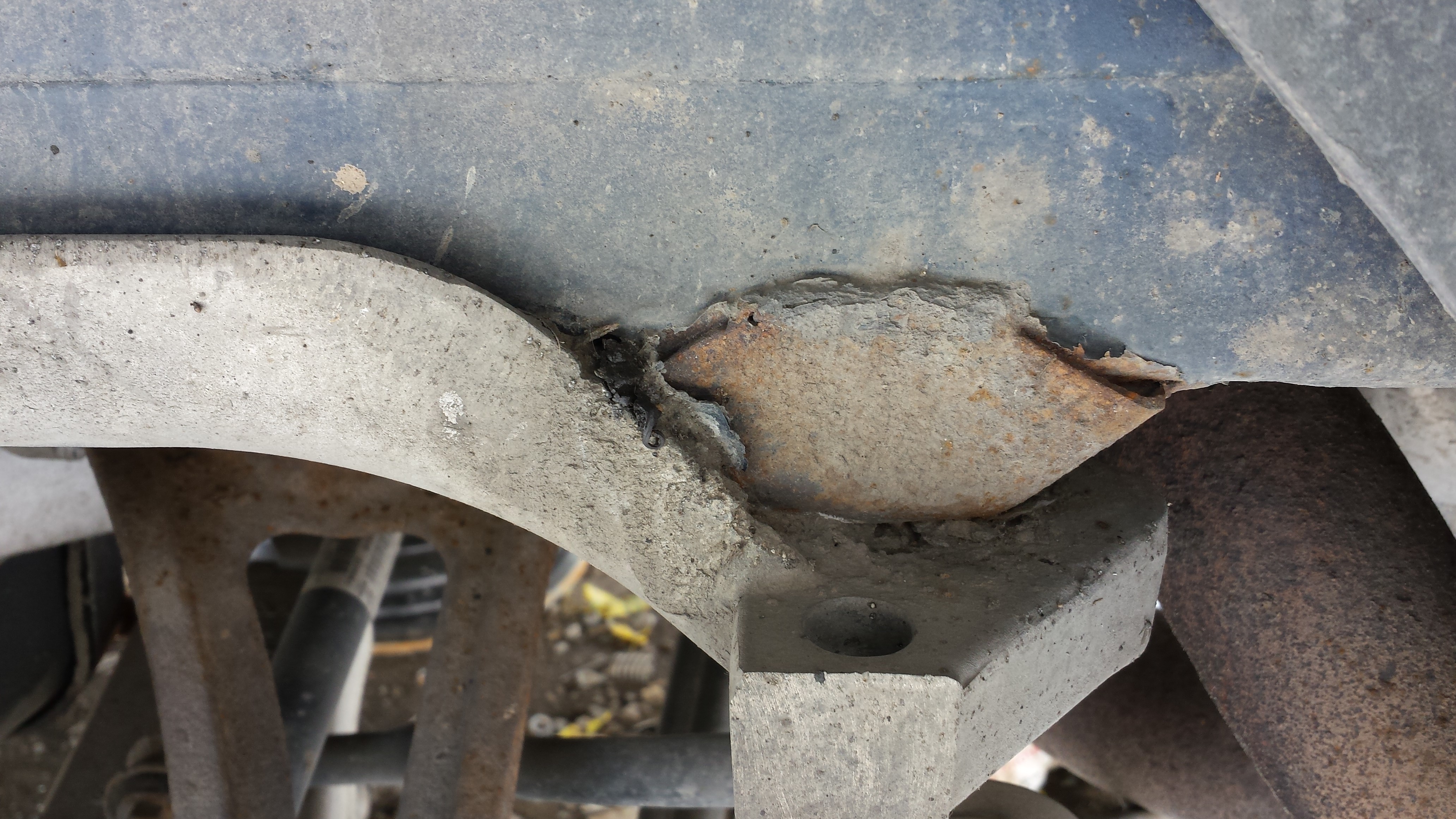

1999 V70XC. Strangely not quite as bad but evidence of frame corrosion along upper edge
2000 V70 XC - Corrosion under where the rusted steel meets the frame on LH side. You can see a pocket forming in the aluminum.
Same car, with corrosion forming in mirror position on RH side

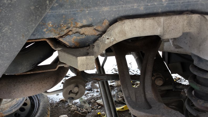

Same 2000 V70XC looking at the front of the of RH side, you can see corrosion running down the side of frame where front bolt is.
Considering these are the only 3 AWD P80's in the yard at the time, what are the chances all 3 would show a corrosion issue (to greater or lesser extent) if there is not an issue either with the design or some local environmental issue (like the de-icing agent used which is liquid sodium/rust).

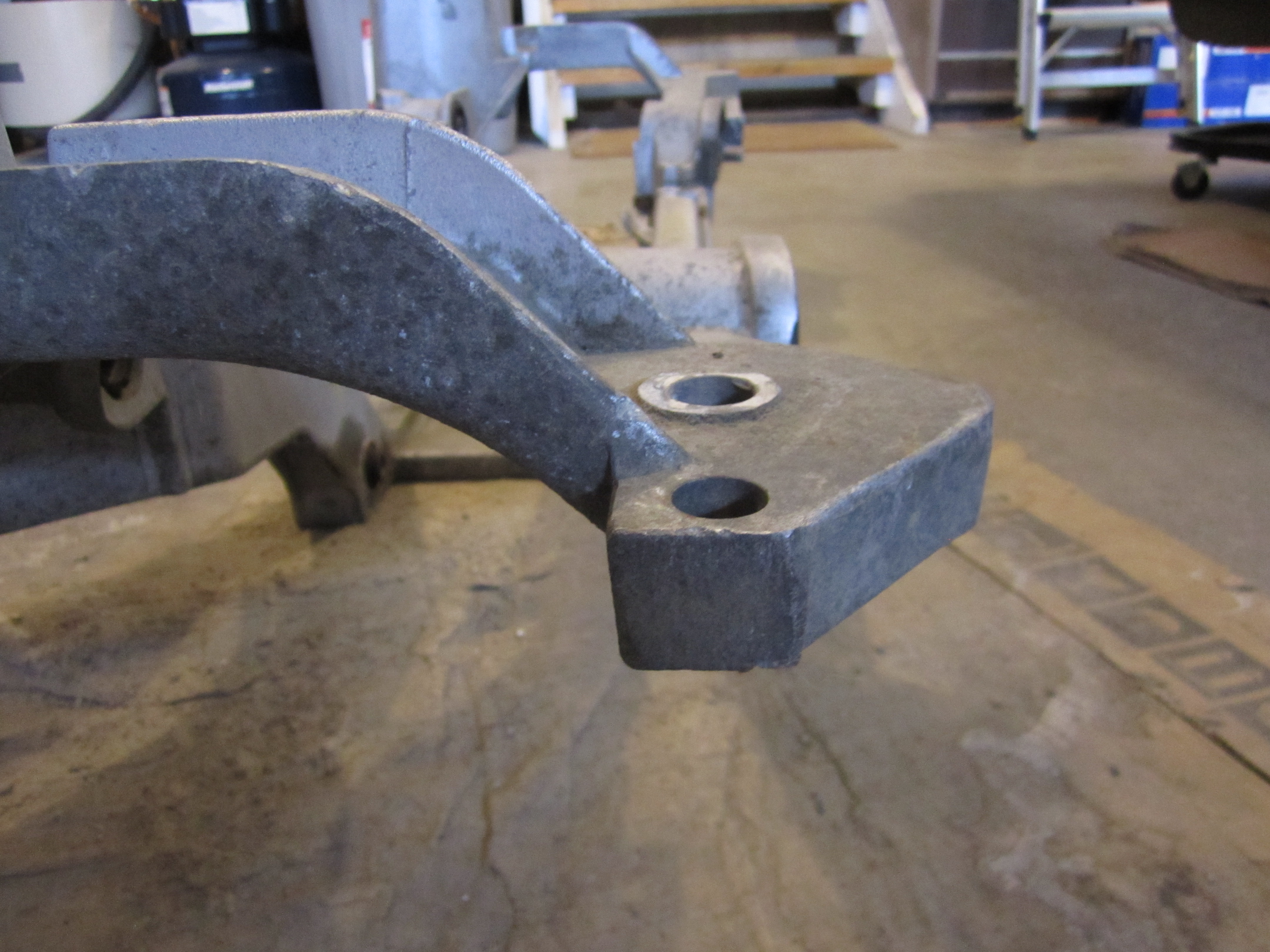

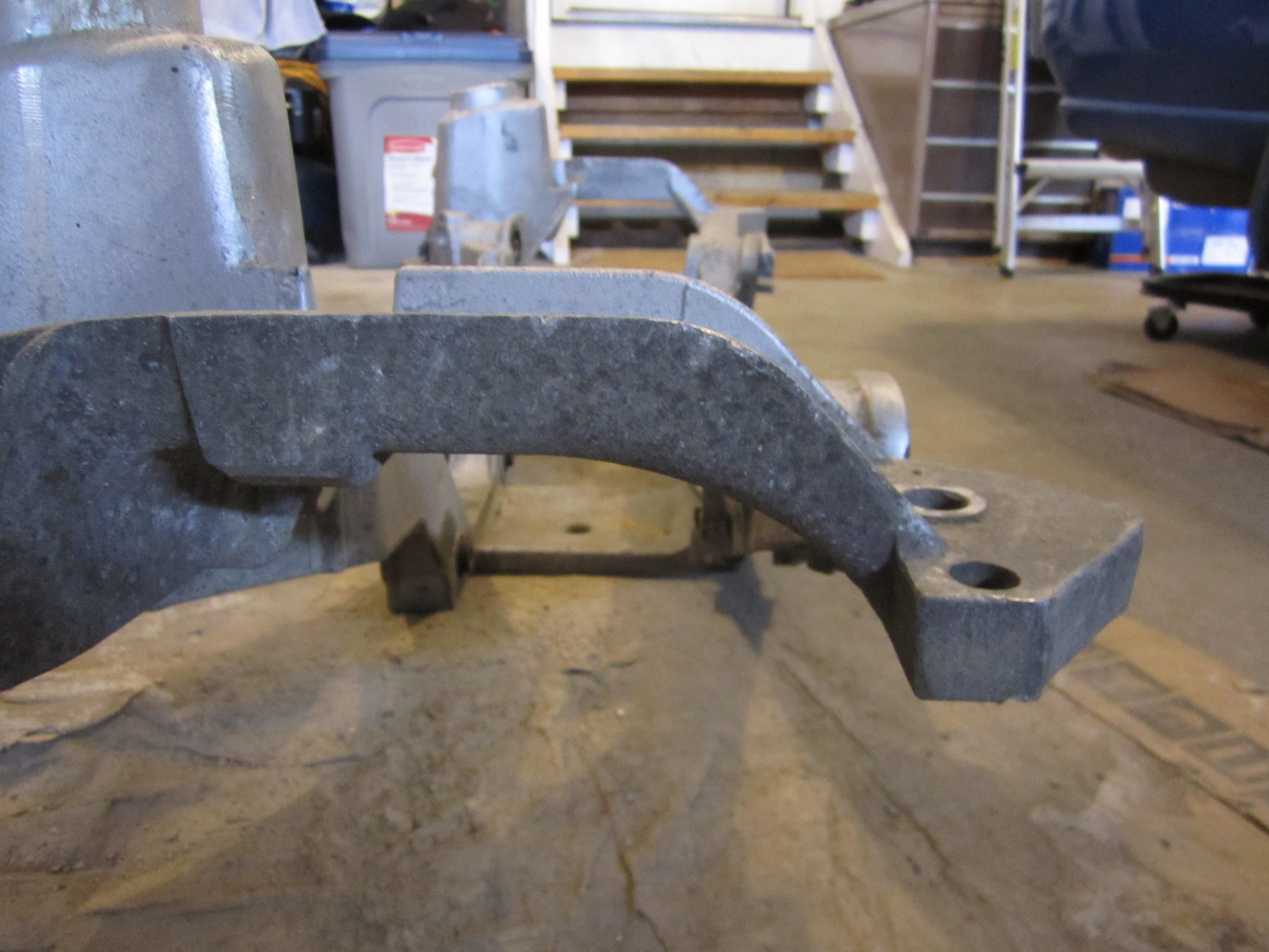

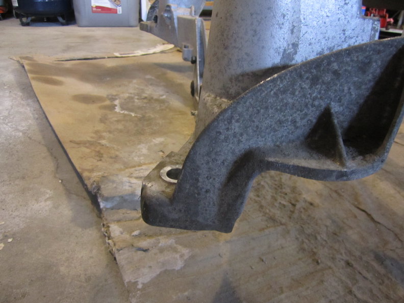

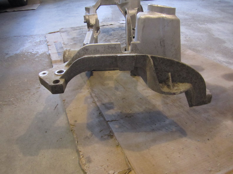

There are times I amaze myself how poor my memory is. Mecheng you asked for pictures of a 'good' rear sub-frame (actually it is the lower section that is the problem).
I completely overlooked the obvious answer that I have a good replacement lower section sitting waiting for me to install it. So in answer to your question:
What you are looking for is a continuous arc for the outer flange from front to rear. If you look at the photo below you can see a chunk is missing
Below is what a good one should look like with no pitting around the raised bolt hole

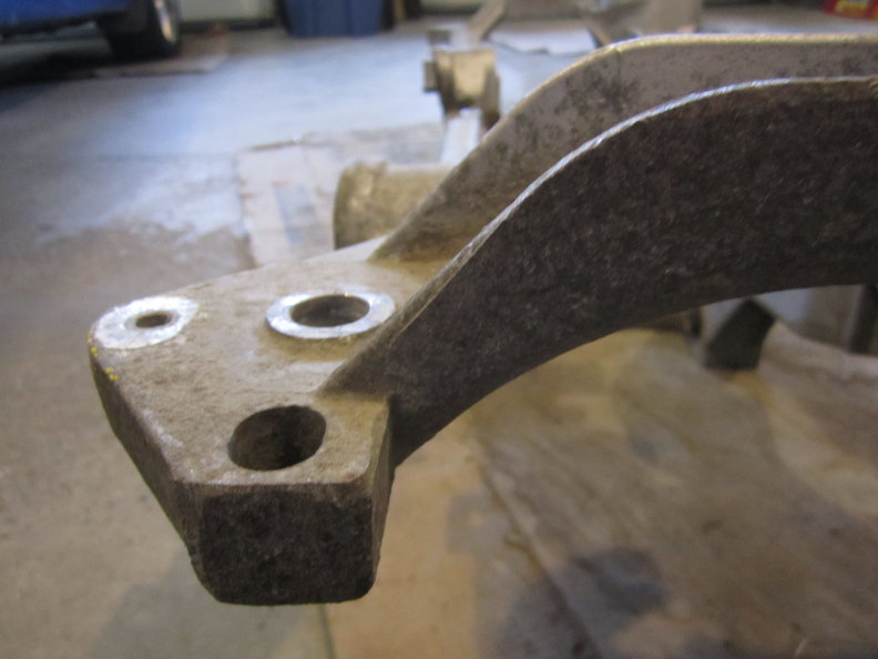

Below is the front mounting hole on the RH side. Again looking for continuous arc of side flange and not pitting. This frame is dirty, and after a clean and a coat of paint will look new again.
Next 3 photos are of the LH side. Sub-frame came from a Canadian west coast 2000 V70XC with low mileage and had been written off following a front shunt. Rear 3/4 of car was un-scathed. They use very little salt on the roads, although they do have more airborne salt due to coastline proximity.
Hope this gives better clarity for what to look for. Also look for top edges of the side flange starting to look ragged or turning dull with a white coloration as this is the aluminum degrading.
Finally look under the rear most part of the sub-frame just forward of where it starts to raise up in-front of the rear bolt hole. This on my car and the 2000 R in the PnP are almost eaten through as if acid were being dripped on them.
