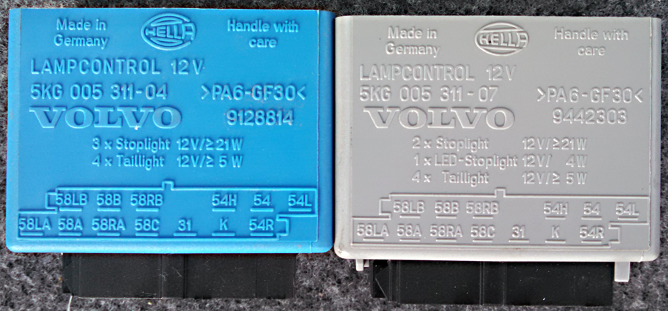

Hi, just an update on the LED third brakelight question. I made it to a U-Pull and for five bucks got the lamp controller from a 1998 V70 and switched it with the one in the 850, and it worked like a charm! The one in the 850 was blue and the one in the V70 was gray. Thanks to everyone for your help, I REALLY appreciate it!
The blue lamp controller from 850 and the gray one from the V70.

Great follow up and the picture says it all.
Thanks for closing the loop on this!
