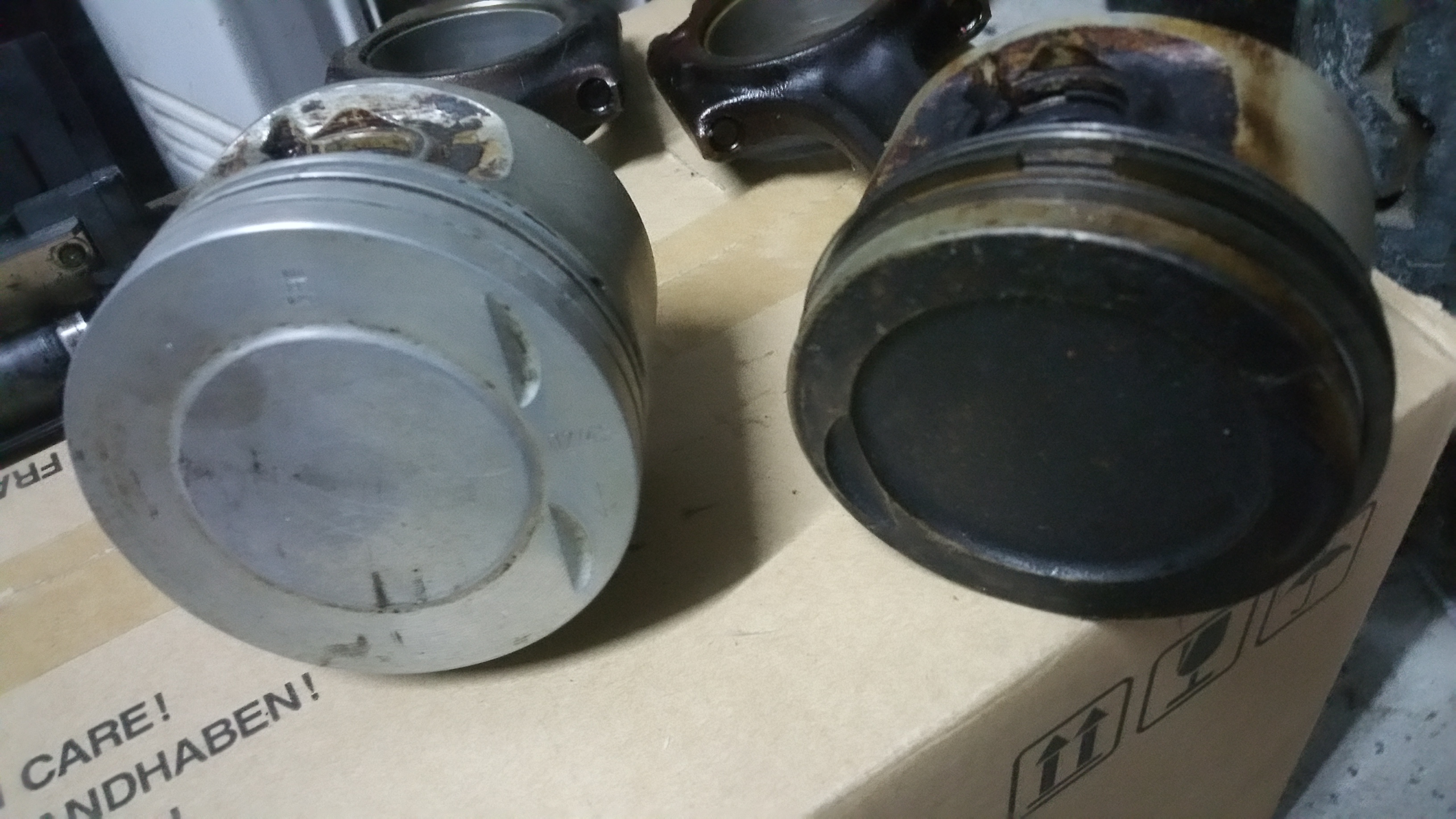

Now here is a question I really do not know...the engine block is the same for the 10 valve and 20 valve engine....RIGHT...? Now since this is 10 valve...can one put a 20 valve head on this engine....or is there something different about it that would make this not work. just wondering is all...
precopster
Posts: 7543
Joined: 21 August 2010
Year and Model: Lots
Location: Melbourne Australia
Has thanked: 8 times
Been thanked: 128 times
Post by precopster »
Yes the same block, crank and conrods as the 20 valve. Pistons have one relief cut in them instead of 2 for the valves and run a slightly dished top. You could cut the extra flycuts and use them in a 20 valve turbo install. You would have slightly more compression than a GLT motor. The 20 valve piston is on the left.
