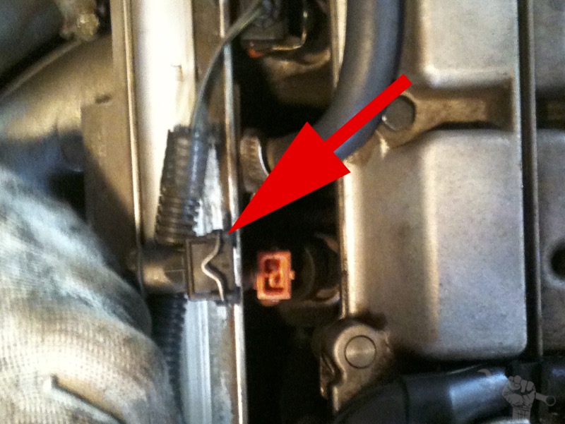

The injectors have an electrical connector that sends the spark inject signal. You want to unclip the connector.

The problem is that regardless of plugged in or not the catalyst will still be over rich. The oxygen sensor will see the oxygen left over from no combustion as it running lean and ECM will dial up fuel delivery. Left plugged in is the worse but unplugged is not a fix to enable driving for any distance.

Jimmy isn't 15psi worth of extra O2 going to have a very small impact on the O2 sensor's reading when taking into account the entire oxygen reading?

matthew1 wrote:The injectors have an electrical connector that sends the spark inject signal. You want to unclip the connector.
This pics are magnificent. Thank you!

precopster wrote:Jimmy isn't 15psi worth of extra O2 going to have a very small impact on the O2 sensor's reading when taking into account the entire oxygen reading?
When I have had a failed injector or plugged injector the car would often have fouled plugs on some of the other cylinders and barely run. The low compression may reduce the air pumping of that cylinder but it would still be enough to make it light up check engine light and run poor enough to not make it operable.
The ECM might be programmed on that one to shut down fuel trim correction activity when the injector is detected open circuit. That year model 5 cylinder is Denso system and their fault management is "smarter" than than the Bosch system it replaced.

So what you're saying is the system might not overcompensate with extra fuel if it detects an unplugged or out of range injector?

If I try disconnecting, do I risk any damage?
