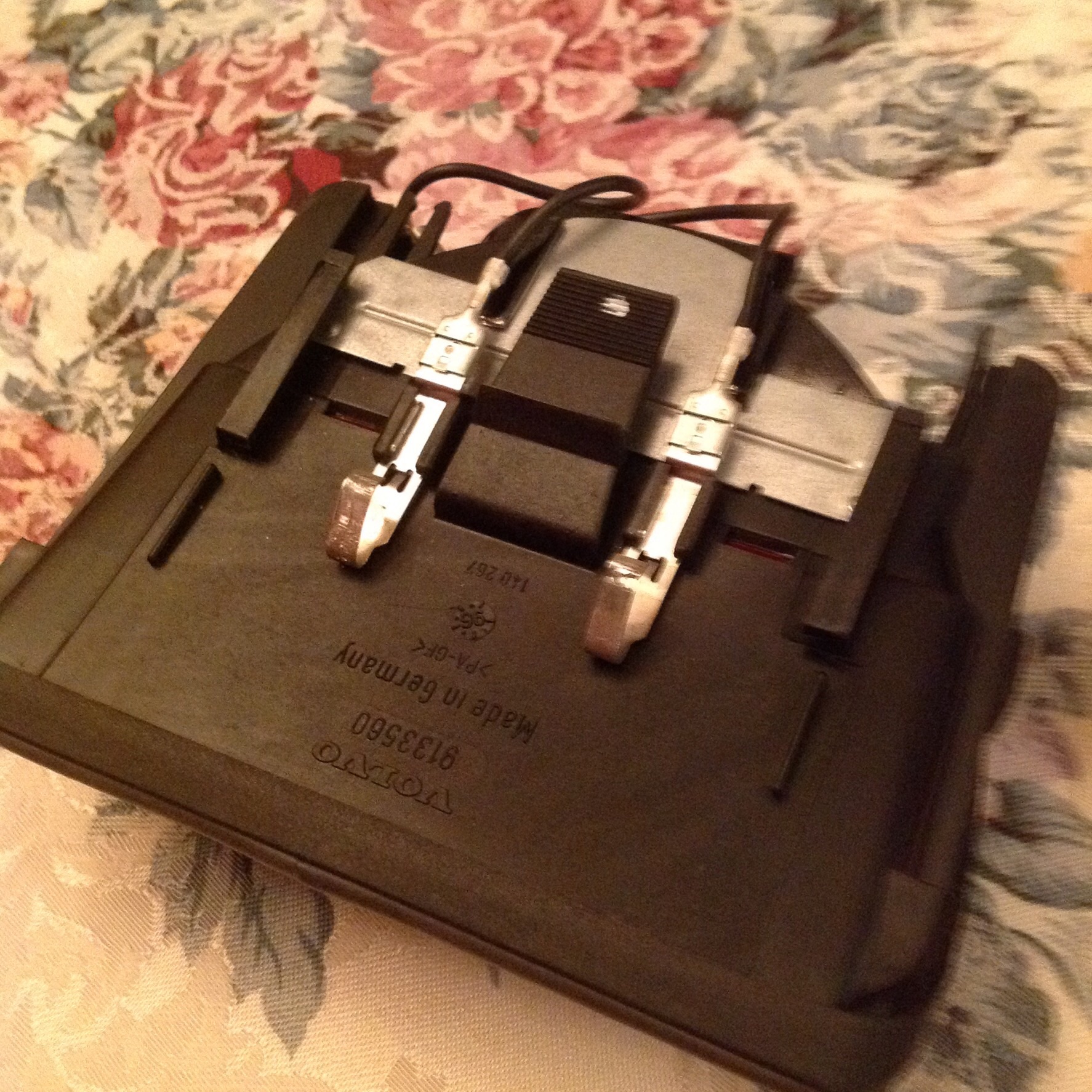

It's embarrassing but I was not aware of a third brake light. The wife and I had taken turns pressing the brake pedal and monitoring the two brake lights...our eyes and mind were focused on the two brake lights. I removed the lamp cover then pushed in the middle under the lamp assembly and pulled it off its track. The bulb was fine but there was a layer of grey oxidation on the contacts which I scraped off and reinstalled the whole thing and it works and the lamp fail indicator is gone. Thanks to all and especially erikv11. wlutz
