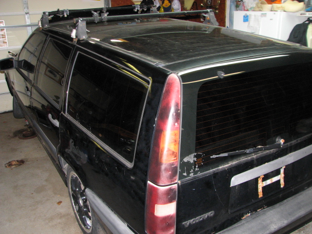

This is the '94 N/A Wagon I've had in storage until last week.
It needs a little cleaning up, but the drivers front hub bearing was the only thing keeping it off the road.

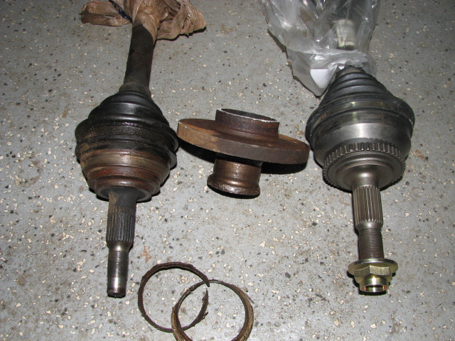

Oh, the wheel speed sensor ring was taken off completely so I have a new axle as well.
The hub bolts turned out to be E-16.
No matter, I had to get a salvage knuckle. The original bearing is welded inside.

My left Hub tapped out with light hammer. The right needed a hydraulic press.
Looking good !
