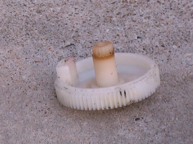

This is the lower white gear. The spring installs underneath it. This gear drives the whole lock/unlock mechanism:

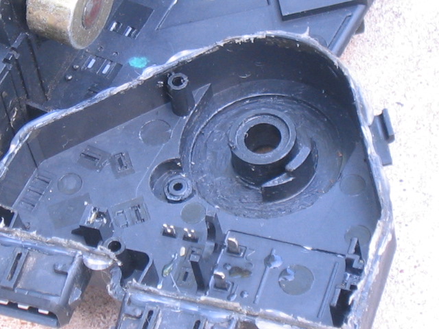

With the gear & spring removed, you see this. That "ramp" looks like a place to catch one end of the spring into that small notch. Opposite this is smooth and straight, all the way to the "floor". However a spring "hook" could still catch here.
Note the two spring "hooks" are roughly 180° apart, the top one tilts down while the bottom one, tilts up. So if you rotate the spring 180° CW, the lower hook will hit the bottom of the plastic "tower".
Like this:

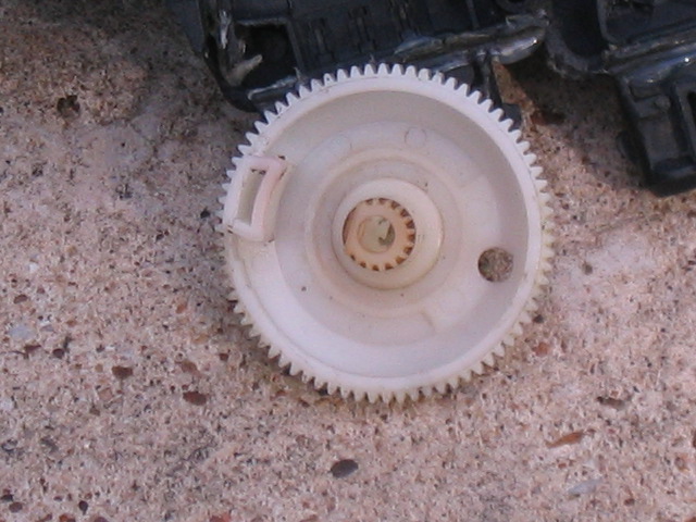

The gear, shaft and "flat" are all one piece and run through the plastic base, and fit into a small, white arm on the other side. The small teeth engage an inner "star" in the lever, not another gear. One side of the white projection has a small recess inside the circumference, so I figured the end of the spring hook would fit there. (Can't see the flat cut into the shaft from this perspective).
You can see it here at 9 o'clock. I'm not sure what purpose the hole in the solid gear disc serves. Any ideas?
